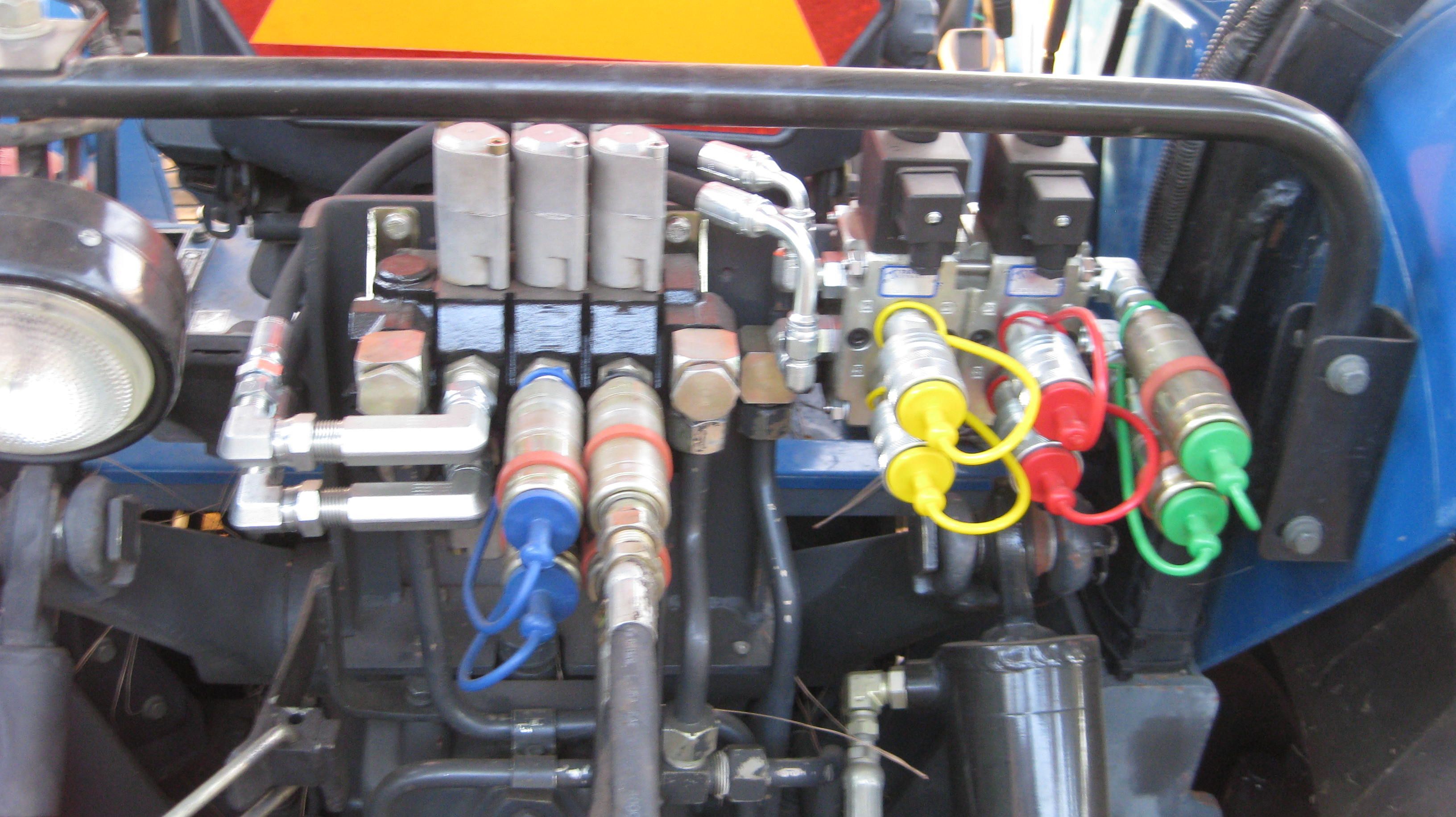

Also, you might want to think about installing that diverter valve on your tractor instead of the blade. That way you have all those hydraulic connections available for other implements, not just for use on the rear blade.

Actually, I'd not even thought about mounting the diverter on the tractor, but I like that idea better. As for the skid shoes making grading easier - - even with the tail wheel? I'd think the tail wheel would be more effective since the blade would be between two support points like a road grader.

Picture is of my tractor with the 3 factory rear remotes and a double diverter setup to get me a total of 5 rear remotes.
