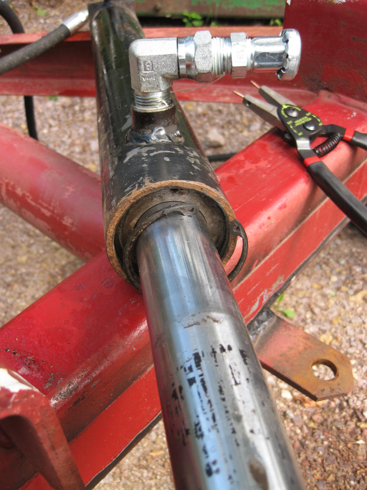

Is there a way to id a cylinder with out knowing what you have? I have two used cylinders to use on my dump trailer, seemed in good shape. But the packing is bad on one of the cylinders. Can you get a generic packing kit, if you know the dimensions? Thanks

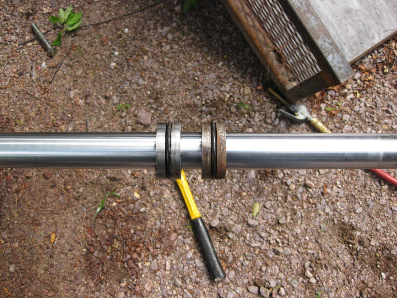

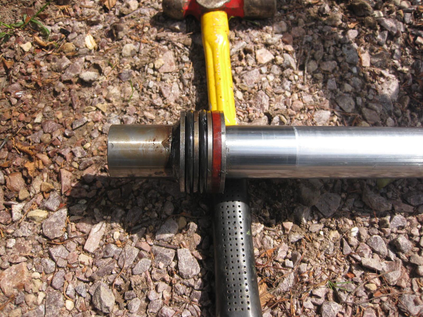

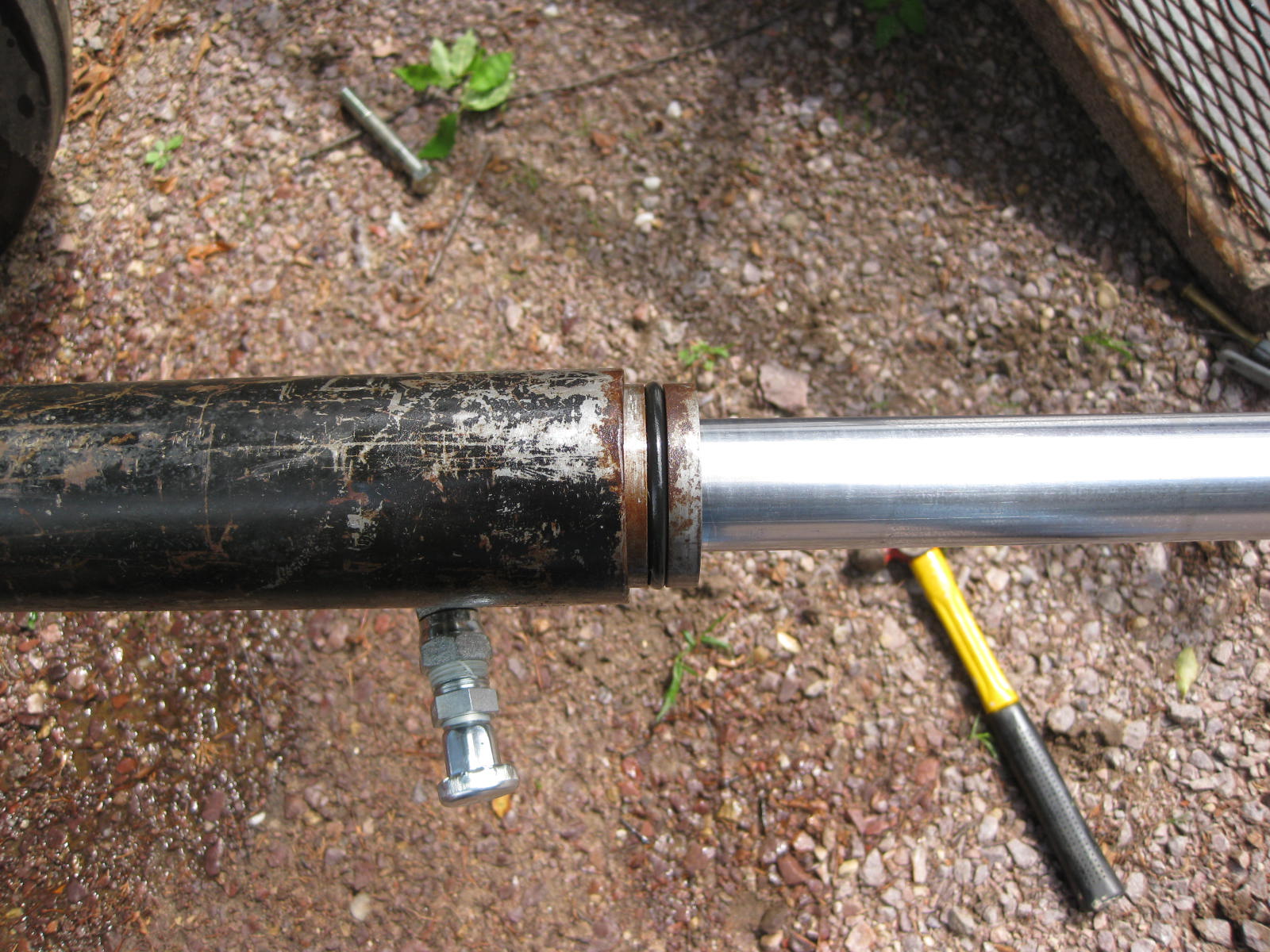

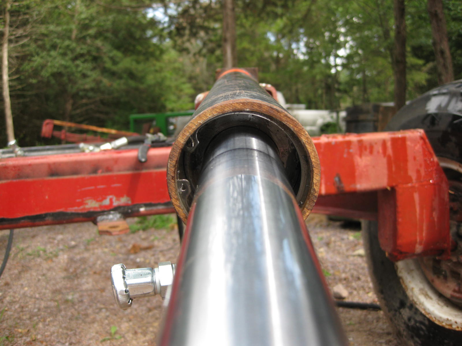

Well this is what I have, I can find the O rings at Hercules Sealing Products. But I don't know what the red colored ring is or what it is called :eek:. Thanks for the help
