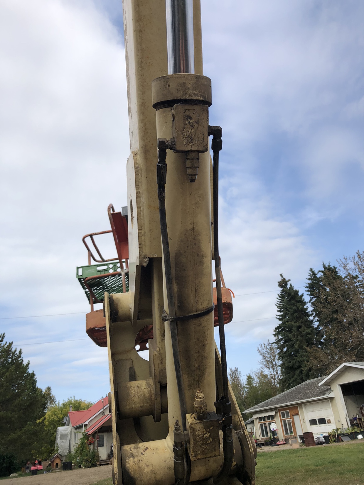

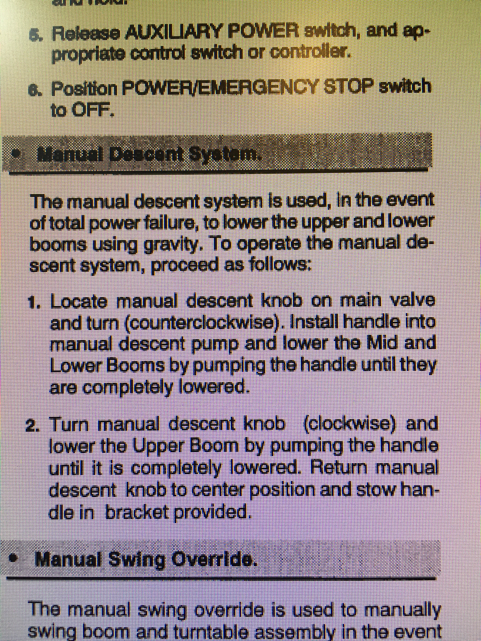

   / Hydraulic Cylinder won’t go back down #5
Here is a procedure I found on the JLG site for the model 45ic, not sure what model yours is.

Because your lower and upper cylinders are working I am thinking that one of the holding valve cartridges is defective on your mid cylinder.
the only way to safely bleed the cylinder would be to place a strut between the lower and mid boom to control movement of the mid boom while cracking open a holding valve cartridge.
This may sound silly but do you have a very large tree nearby that you could support the upper and mid Boom from overhead?
One more thought, have you inspected the hydraulic lines to be sure none are leaking? The purpose of the holding valves is to “lock” the cylinder in the event of a line burst.
