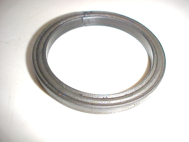

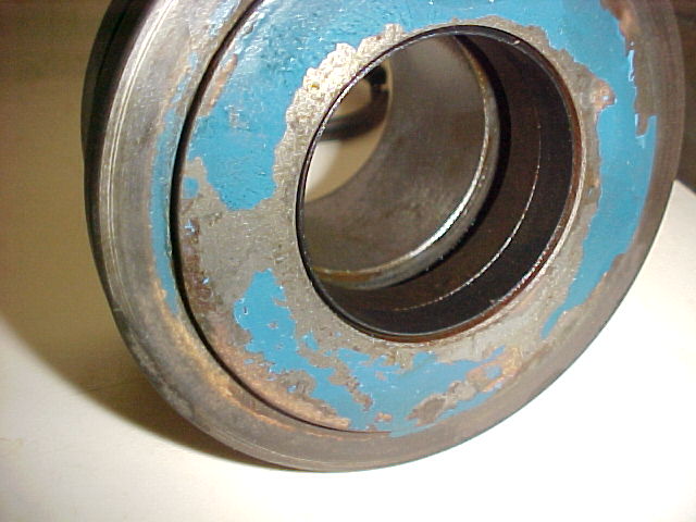

Pictured below is the seal and head gland from a 4" Barrel x 2" Rod x 60" Stroke hydraulic cylinder made in Australia by Collier & Miller.

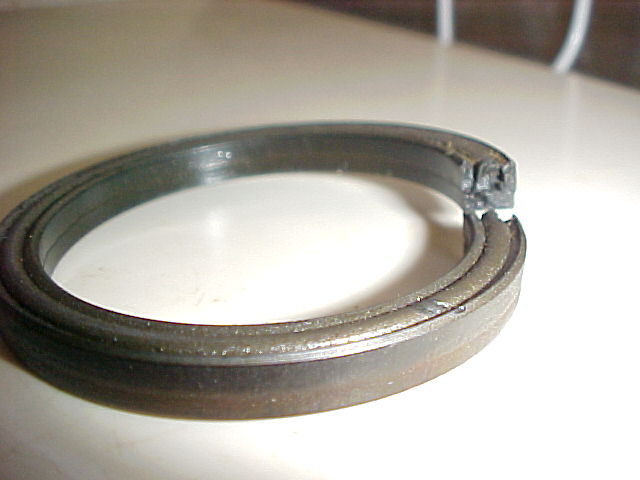

There was a leak between the rod and the head gland so removed the gland seal with an idea of cutting a strip of thin perspex to spring into the seal reccess.
The seal wasn't as rubbery as anticipated and it broke while removing it. Dimensions are 2" ID x 2 1/2" OD x 1/4" wall thickness x 1/4" depth.
Can anybody identify what this type of seal is called - as you might see in the pics it looks a bit like a low pressure lip seal with an o-ring pushed in the gap but it is all one piece.
Appears to me the seal isn't as compliant as it might be and maybe lacks the proper lip to push out under pressure, but having said that I think it leaked worse when standing in the shed under no pressure.
Or is there an altogether better seal which could fill that 1/4 x 1/4" recess.
I've been thinking about a 1/4 x 2" ID x 2 1/2" OD O-ring but you don't often come across such thick O-rings - maybe for good reason?

It's a standard type loaded polyurethane U-seal. Very common, should be real easy to find down under. The extra piece in the middle is for low pressure sealing. Keeps the edges of the seal pressed into the bore and rod when there is low pressure in the cylinder. That's what the "loaded" part means. To aid in the installation, drop the new seal in a bowl of water and nuke it to about 160 degrees, then install it. Also, they are cheap enough so buy 2. That way in case you bugger one up, you have an extra to install.

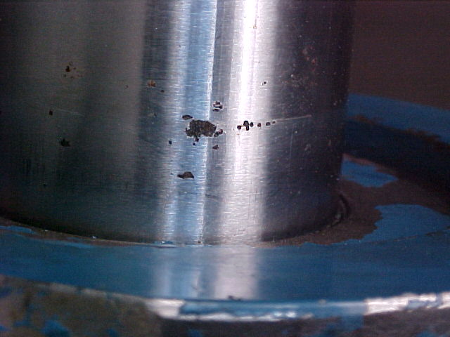

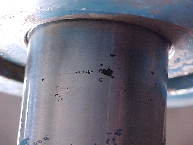

Noticed some pitting on the shaft exactly where the wiper seal contacts.
Any ideas why that should occur and what could be done to avoid it getting worse.
I've attached some pics - ignore where a grinder seems to have removed the chrome further out.

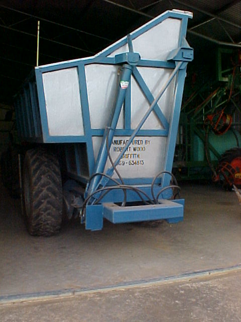

Final pic shows the application, it does get wet now and then but I find it hard to believe that the chrome should be affected by that bit of moisture.
