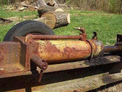

I picked up an old log splitter - need to add a valve and planned to run it off tractor hydraulics. It shows signs of leaks around the rod end. I used an air compressor to cycle the cylinder and didn't see/hear any leaks (but the pressure was only up to about 100 PSI tops) but heard some gurgling and leaking around the piston. What is involved in repair? It looks like the rod cylinder end comes out but I haven't cleaned off the grime to see exactly how. The cylinder was said to come off Catapillar equipment of some kind. What do I need to get the proper seals? Rod is 2" with a bit of minor surface rust that I figure I can clean up with emery cloth. OD of cylinder is about 5.3" and a bit bigger on the rod end. I can post some pics later.

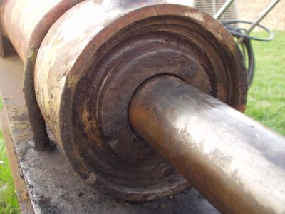

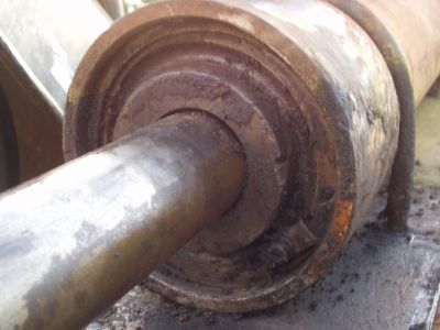

I need a few more ideas about how to attack taking this apart... Here are a couple of pics of the rod end of the cylinder. It looks like a small screw holds a snap ring in. There are a couple of gouges in the cap - perhaps used to try to unscrew it?. Does the end just pop out once the snap ring is out? The seal goes in from the back of the cap (inside the cylinder)? Should I undo the snap ring and try compressed air to pop the end cap out?
I barely remember helping my dad replace a rod seal about 35 - 40 years ago but as I remember the part that held the seal in unscrewed from the outside and the V seals came split so they could be slipped over the shaft without taking the piston out. This looks to be quite a bit different.

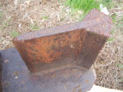

Also a pic of the wedge. It's about 8 inches high. Not sure about the added wedges at the back - have heard pros and cons.

I can't tell for sure by the pictures but I am willing to bet that the rod end cap unscrews from the cylinder body. Probably designed for a spanner wrench made by Cat. The snap ring is there to prevent the cap from loosening. These end caps can some times be real difficult to turn since over time they may have rusted in place. Possibly try making a spanner wrench or carefully use hammer and punch to see if it will move. Don't round the edges of the slots to much or you won't get it apart.
If you have an air chisel with a punch type tip possibly try that also.

If it had slots those have already been pretty much destroyed - take a look at the V notches on the left and right side of the cap. Looks like they tried the cold chisel approach although I would have thought the slots might run farther along the length. That's why I thought it might now have had slots and might not unscrew. I suppose I could try to cut some new slots...

Kinda difficult to tell from the pics but is there a snap ring inside the barrel of the cylinder? If so, you need to tap the gland into the barrel to relieve the pressure from the snap ring, remove the snap ring, then use the splitter hydraulics to remove the cap.
Look on the cylinder for a Cat part number. Might be a # followed by a letter then a 4-6 digit #. Something like 6Y-8593.

To be honest it looks like its junk to me. I would try it as is first and see how it does. May be livable.
If not I would just get a new cylinder. My local Rural King has log splitter cylinders for $149 made by Delvan I think. 4" x 24" stroke. I think you will find its going to cost that much or more for the seals and the work needed to clean that one up.
