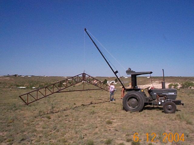

My tractor is a CASE/IH 385 (40hp). It does not have a FEL - I wish it did!
I've used a lightweight boom pole on the 3ph to lift rafters into place in the past but a project I'm now noodling will require something with greater capacity than this little boom pole (see attached pix).
I was thinking of moving the boom to the front where it would be easier to see and keep the rear end free. I have been thinking of building a FEL for the tractor and thought that if done right, the mounting brackets and cylinders from a boom pole could be used later for a FEL.
Thanks a lot for the great pointers!
