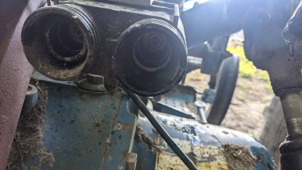

I have the original factory quick connects on my 3910 and was wondering what couplers to use? Any help would be greatly appreciated.
   / Hydraulic Connections #2
I believe they’re called the pioneer style. But I have found every used attachment I’ve bought has just worked on my 4610. Definitely not the flat ones used on skid steer.

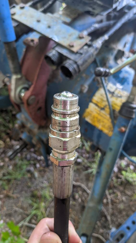

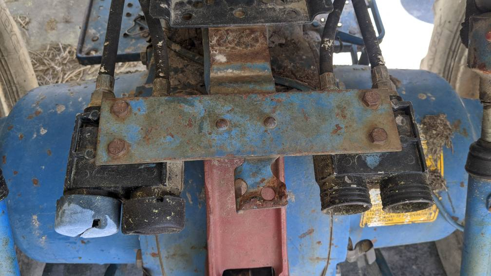

All I know, is these won't lock in. Lol!

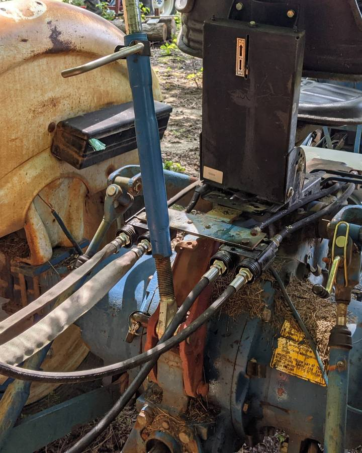

Finally figured this out. Pioneer 8010 series are.what you want. Anything else won't seat unless you can turn the far shoulder down. Will post something up about this once I can get the fittings to work and turn them on the lathe.
