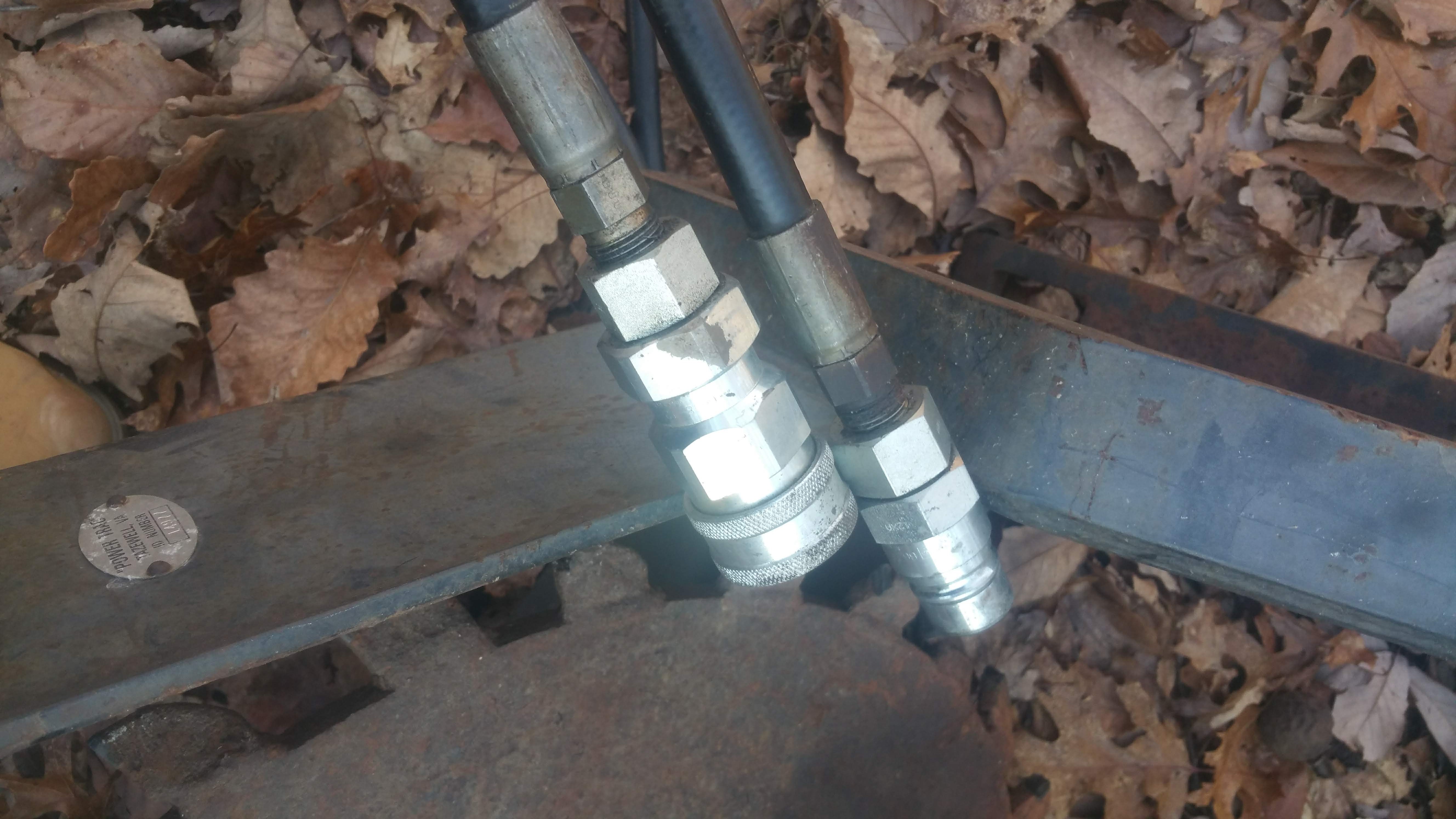

Scored a 4 in1 bucket and stump grinder used for my PT1460.
Don't understand how the connections work.
The stump grinder has huge connectors on it. Seems they would fit on the outside large hose connections of the PT1460.
The 4 in 1 bucket has small connectors on it? They appear to be the same size as the fittings for the hydraulic quick clamp?
Do I remove the connectors from the hydraulic quick clamp and use those connectors for the 4 in1 bucket after the bucket is on? Or do I need adapters that go from small to huge connections and then put it on the the big connectors. Photos attached.
The previous owner could have done something with this but the guy I bought from said he didn't know anything about them.
Any help would be appreciated.
Picture 1 far right large connector on machine and right quick connects on machine
Picture 2 far left 2 large connectors on machine and left quick connect on machine
Picture 3 large connectors on the stump grinder
Picture 4 comparison of quick attach connector size on machine on right to connectors on the 4 in 1 bucket hoses

"The 4 in 1 bucket has small connectors on it? They appear to be the same size as the fittings for the hydraulic quick clamp?" The hydraulic quick connect on the tractor (the outside small fittings) are used for items like the 4 in 1 bucket cylinders. And you would first connect the attachment and lock in place, then disconnect the 2 small lines and connect in your small 4 in 1 bucket hoses. Then the same lever that you used to lock and unlock attachments now would open and close your 4 in 1 bucket. You could reverse the hoses if the lever direction didn't match what the attachment was doing.
   / Hydraulic connections for 4 in 1 and stump grinder #6
The "huge connections" as you call them are for running an attachment with a low flow hydraulic motor. That circuit is controlled by the switch on the dash marked PTO. It would be used to spin the cutter blade on your stump cutter if it was a low flow motor. If the blade spun the wrong direction, you would reverse those. Keep them all clean when changing over. Dirt in the hydraulics is not good.

So it's like this.
- The Quick Attach is operated by your AUX PTO.
- You AUX PTO is the 3rd spool on the FEL valve bank.
- On a PT425, that 3rd spool is the lever by the operator's right knee under the FEL joystick. I don't know where it is on your machine, so am guessing it's the same?
The AUX PTO is for operating cylinders, not motors. So, for example, your grapple bucket. You'd drive up to it, pick it up with the Quick Attach, and lock it in with the AUX PTO lever. Then you'd set it down, set your parking brake, undo your seat belt, get off the machine, disconnect the Quick Attach hoses from the AUX PTO connections and let them hang. Then you'd connect your grapple bucket hoses to the AUX PTO connections.
Now get back on the machine and operate the grapple with the Quick Attach lever.
That's how it works.
For the stump grinder, that has a hydraulic motor. Hydraulic motors are run off of the MAIN PTO. Those are the larger hoses on your FEL arms and operated on a PT425 by an electric switch on the dash. So I'm gonna again assume that's the same way on your machine.
So again, you'd drive up to the stump grinder, pick it up with the Quick Attach, use the AUX PTO lever to lock the Quick Attach into place, put the stump grinder down, set your parking brake, take off your seat belt, get off the machine and connect the two large hoses from the stump grinder to the two large MAIN PTO connections on you FEL arms. Then get back on the machine and buckle up.
When you start a hydraulic motor on a PT of any size, you never want your engine running at high RPMs. So throttle the machine back to idle, lift the blade off the ground a bit, make sure all is clear, etc.... and then you can flip the electric MAIN PTO switch on your dash and the hydraulic motor on the stump grinder will start spinning. Then you can get into position near your stump, throttle up the engine to full RPMs and start grinding slowly.
Same thing would apply to a brush cutter. Don't turn on the MAIN PTO switch unless the engine is throttled down. Once it kicks on, then throttle up slowly to full RPMs and then lower the cutter down onto it's wheels and start mowing.
Hope that helps. ;)
   / Hydraulic connections for 4 in 1 and stump grinder #8
Unless the previous owner changed things, PT puts identical sex connectors on the AUX PTO, and opposite sex connectors on the MAIN PTO.
The reasoning is that the AUX PTO is to only be used for hydraulic cylinders, and therefore, it doesn't matter which way they are hooked up, except the operator gets confused if they hook the hoses up opposite.
The MAIN PTO is only to be used for hydraulic motors (high flow, low flow, doesn't matter, all hydraulic motors). Therefore, it's important to only have the motors turn in the proper direction. (even if they are reversible motors, you don't want them spinning in the wrong direction). So they put opposite sex connector on the MAIN PTO so that the implement is always connected with the motor direction the same each time.
