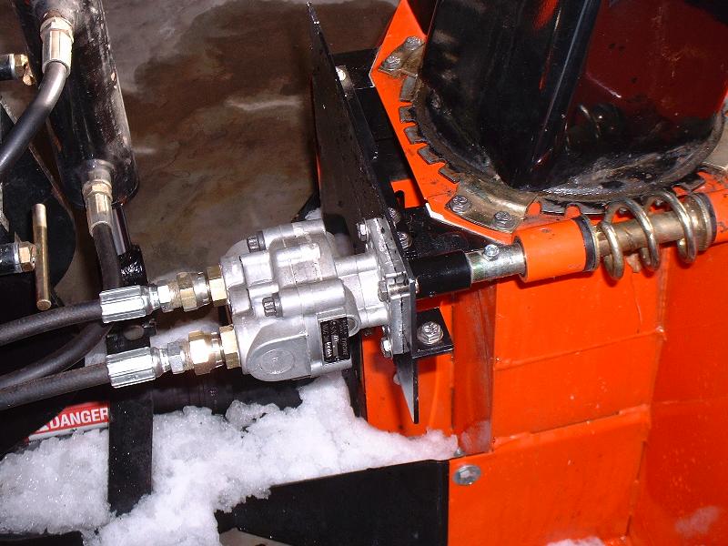

Junkman,
I added a hydraulic motor similar to what you are looking at to the snowblower on my bx1800. It moves the chute very quickly but you get used to feathering the joystick pretty quickly. I've attached a picture of the modification that I made.
   / Hydraulic Chute Turning Motor....
I remember seeing your adaptation of the hydraulic motor. Did you put flow restrict-ors in the lines? What happens when it reaches the end of the travel? I am concerned with damaging the "wire gear" that Kubota uses. I read on one of the other forums that someone put stops on one that they were working on, but I don't know if stops will add enough resistance to the force of the motor without damaging the "gear"... I have a motor coming thanks to another TBN member, so I hope to start working on this project soon. I have another project that has stalled waiting for additional parts. My Kubota is going to look like a parts machine if I don't get some of these projects completed soon.. thanks for the help... Junk.....
   / Hydraulic Chute Turning Motor.... #9
I didn't put any stops or restrictors on. I don't seem to have a problem but I am careful when the chute is reaching the end of the travel to the right or left.
