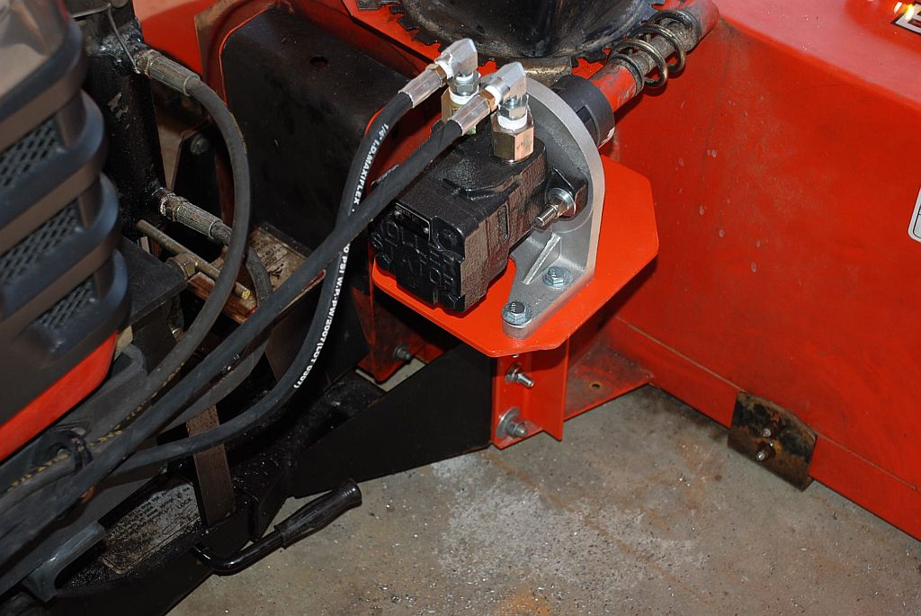

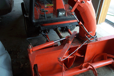

Well, I finished the chute rotator project on my BX 2750 snowblower just in time for summer. I had fun building it and learning how to do a crappy weld, but then clean it up with some grinding. It works great and no major problems in the build. I got the motor new and fairly cheap, but found when it arrived that it was BSPP thread on the unit, so I had to get a bunch of adapters. I could not seem to find a 1/2 BSPP to 1/4 inch NPT...only 1/2 inch BSPP to 1/2 inch NPT and then another adapter from 1/2 inch NPT to 1/4 inch NPT. You get the picture. I would have preferred a lower profile, but it doesn't bother the operation at all. Everything else went on precisely as designed... by following the theory of measuring 458 times and cut once, drill once, etc. My wife is happy because I managed to only grind one finger down to the bone while dressing up a weld and I didn't burn the house down when doing the initial welding, so it was a great success!
Just wanted to show it off now that it's done. Dyer, retired

That turned out great. What are the specs on the motor? (model number etc)
I always wanted to build something like that but I was not sure what motor to get. How long does it take to rotate 180 degrees?
   / Hydraulic Chute rotator for BX 2750
#9
bx24,
Thanks, I had fun building it. Picking the motor was pretty straight forward. I looked for the cheapest motor that would do the trick and found a White roller stator 3.2 cu. in. reversible from Surplus Center for $119.00 (Surplus Center item # 9-7563.) If you do a lot of shopping on e-bay, you can find motors for much cheaper....I just didn't have a lot of experience with e-bay and read on TBN many times of people purchasing from Surplus Center without problems, so I spent the extra. I knew that the smallest hydraulic motor out there would turn the worm gear that rotates the chute, so that made it easy for me. I had already figured out that I would be connecting the motor to the worm shaft with half couplings, so I ordered those at the same time. The only thing that I didn't catch until I had ordered the motor was that the ports were BSPP, so I had to go through a couple of plumbing adapters to bring the connections back to NPT. It wasn't a big deal, just made the profile a little taller than I wanted. The motor has a very simple two hole mount and Surplus Center had a mount available for it for $34.00 (their item #933) that was perfect for how I intended mounting the motor to the base I was building, so I got that and it worked out great! The metal fabrication took a little longer, but only because I took my time. I cut out all the pieces of steel from stock and a friend brought over his portable MIG welder and gave me a lesson...about two hours of welding and drinking coffee....mostly drinking coffee. I did lots of measuring and mocked everything up to make sure the motor lined up perfectly with the worm shaft, so I was able to do everything once...instead of my normal "hurry up and make lots of mistakes" method.
It works great and will rotate through 180 degrees as fast as a few seconds at full throttle (which is the setting I run when snowblowing anyway,) but you can feather it and make it creep slowly enough so that you can hardly tell it's turning. I read on TBN about others that have similar setups and have ripped the worm gear apart by turning the chute through the stop on the base by accident. I remedied that by cutting, or continuing the slots all the way around the chute base, so I can actually turn the chute through 360 degrees. I have no intention of ever doing that, but it gives me the luxury of not worrying about mistakenly pushing the chute too far one direction or the other and ripping the worm gear out.
If you don't count labor, and you don't.....I have a little over $200.00 into the whole thing. The hoses, adapters, and couplings are cheap. I was surprised by the price of the quick connectors on the control end, so that added to the total. I wanted to be able to disconnect and connect quickly, so I went ahead with the expense. People kid me about spending that kind of money just so I wouldn't have to hand crank the chute, but they miss the point.....I got $500 worth of fun out of building it. The bonus will be to control the entire snowblower function from one joy stick.
Have fun putting one of these together and let me know if I can offer any more of my limited experience to help. Dyer, retired
