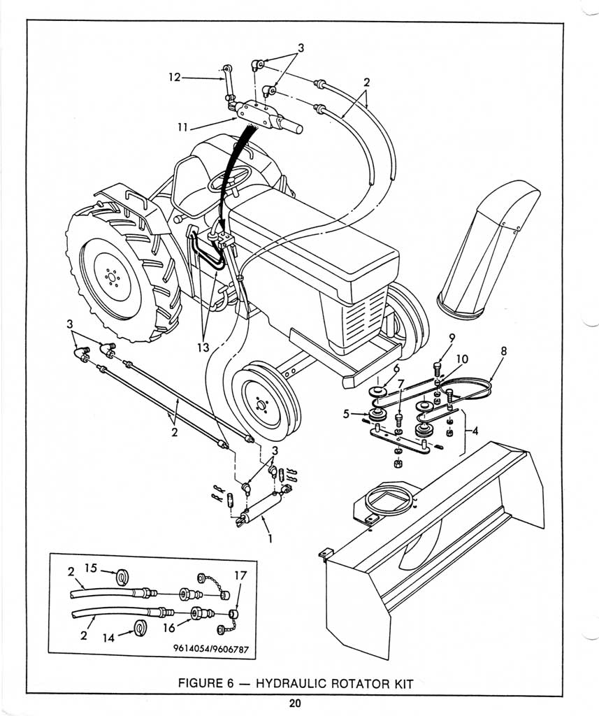

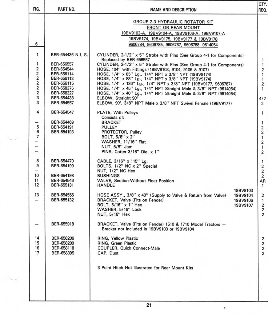

The 715 parts manual calls for a 2.5 X 5" stroke cylinder with 3/4" dia pins - P/N BER-656557
Is your chute rotation set up like the attached pic? I've got a call into my parts guy to see if the kit is still available. If not, I'd be interested in some measurements on the arm & pulleys. I like the design - uses pulleys doubling the distance the chute travels for a more compact installation.

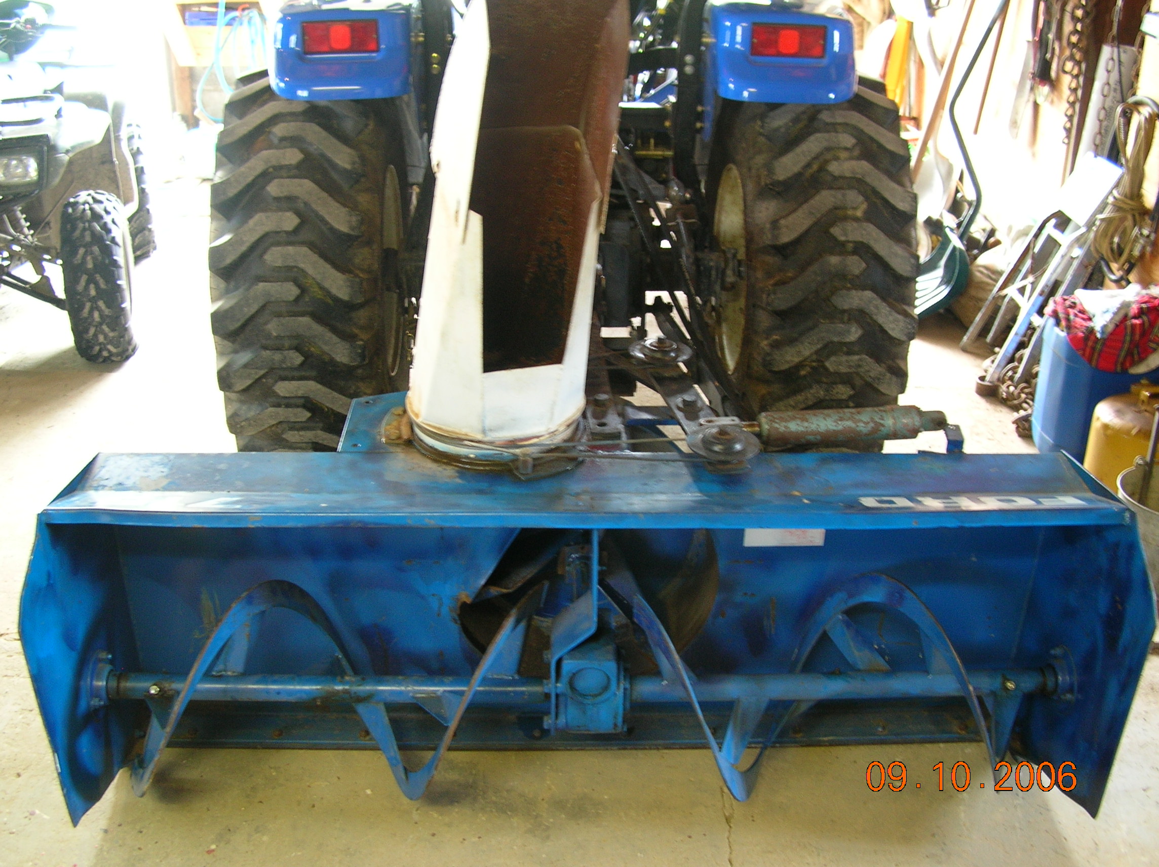

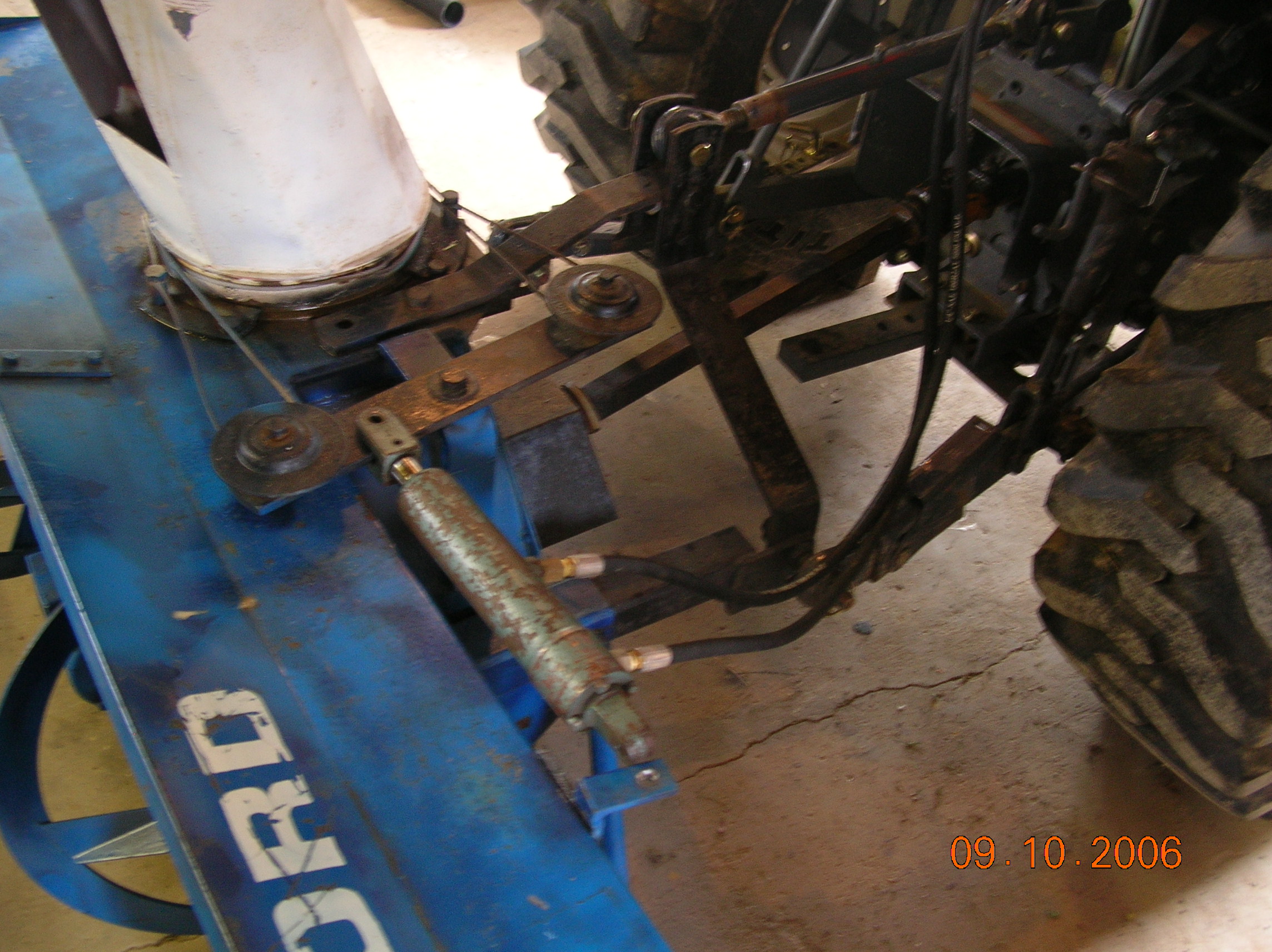

Yes my blower looks like the same model. It came with the shute rotation kit on it minus the cylinder. I attached a couple pics. The second pic shows what I am trying to do. The cylinder I bought a while back on ebay seemed to look good but when I hooked it up to the remotes it didn't act like I was expecting. It doesn't just extend and then stop. It extends then right away retracts, back and forth. When I bolted it to the blower it went back and forth a couple times and then just freezes. I had to cut the bracket a little to acomodate its length. The cut bracket is bending under the pressure of the cylinder. I plan on grinding the bracket off and welding a new one on wherever it needs to be for the new cylinder I buy. I measured and it does require a 5 inch stroke cylinder. Since it is just to rotate the chute I wonder if a 1.5 inch bore cylinder would do it?

   / Hydraulic Chute Rotation #8
Should work with no problems. It's not like you are lifting hundreds of lbs. Even a 1" bore would work just fine.
