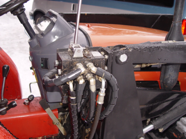

Greetings, This problem is on a Foton 254 with a ZL-20 FEL. FEL when tractor is first started won't move, when warmer slow, and when nice and warm works good.
I have a couple of thoughts first: On the FEL's valve lower left is an item sticking down. [This is the best shot of it I have now. ] Is that a pressure regulator of some kind? Click to make larger.

I believe you may be trying to point out a pressure relief valve. But you've been fighting this issue through several threads on more than one forum. Why don't you summarize here what you've done so far? That should help avoid a bunch of redundant questions.
I've seen folks suggest to you before that this is symptomatic of flow restriction, typically caused by thick hydraulic fluid. It's winter. It takes time for the oil to warm up and thin out, to the point where it will pass freely through the restriction points (screens/filters, valves, controllers).
Since the FT254 is of separate-sump design, I believe you were advised to drain/flush/refill with AW32 hydraulic fluid - to clean or replace the suction filter in the sump - then to inspect/clean the valves on the pressure side (priority/loader/lift) if flow is still restricted. How much of that have you accomplished?

Well! Here is how it went: I pulled the plug on the hydraulics, draining out the AW 32 I had filled with after cleaning the sump. It looked like ****, filthy looking. I removed the down spout I had installed when I cleaned the sump, I installed a Jinma Suction Strainer. I filled with diesel oil and as per Rob's suggestion I started the tractor and worked the hydraulics for a good hour. What diesel came out looking like drain oil. I pulled out the suction strainer. It was suprisingly clean. I reinstalled the suction strainer and filled with AW 32. The FEL fuctioned perfectly.
Conclusion: If the FEL fuctions well when cold today I'll have a brandy, sing and thank God. If not I will hunt out a even lower viscosity oil maybe AW 15. Reasoning: I could not have been happier with the way the FEL moved with the diesel oil. With caucious optimism Richard

I fired up the machine this cold morning. Aannnd.... the FEL raised so as to make any man proud. Bucket full down and curl nice. If there is something to complain about I couldn't find it. The 3 poing is ready right now. All this with AW 32. After some things are done I still plan to go through the FEL Valve just because. I do have a flock of hoses to reend or replace, I hope to find the metric ends. The information, case histories and incouragement ,And close friend conversation took the pain out of this exercise. I thank
