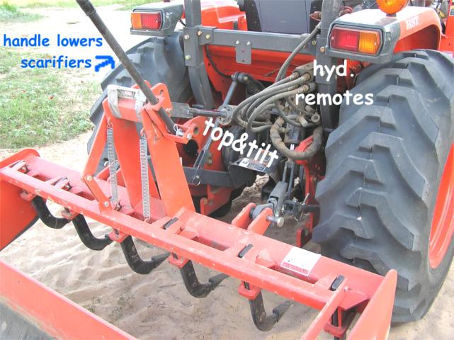

ovrszd posted a picture of his boxblade that already has a handle to pivot the teeth down or up. That's how most of the hydraulic ones are made. His would be very easy to modify by attaching a bracket from the pivot to a hydraulic cylinder. He is lucky in that respect. I thought about doing that but there was not enough room behind the front bar and the back blade to allow my scarifiers to pivot. My box was not deep enough. So I did what you are thinking about, except used the gear mechanism.

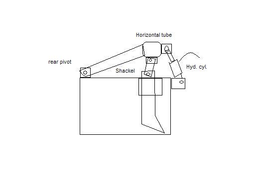

Here is my idea on combining the designs shown: Use a sizeable tube over the scarifiers to resist bending and twisting. At each end of the tube a pivot arm is welded to the tube and pinned to the rear of the box blade. the tube will travel in an arc and the scarifiers need to move straight up and down so a shackel is used to connect the tube to each scarifier. By shackel I mean something like the rear connection between a leaf spring and vehicle frame. I am attaching a crude sketch. If the tube needs to be higher to clear the 3-point braces you can use longer shackels.

Yeah, if you look at the picture of the Cammon box blade I attached above, it functions like you have described and drawn. As 3RRL said, it could easily be converted from handle operated to cylinder operated. That's the design I'm going to build. Seems to be simple, straightforward and does not require any high tech manufacturing skills. I considered a rotating beam until I saw the Cammon design.
   / Hydraulic box blade teeth? #10
The difference between my drawing and the Cammon is that the Cammon rippers are pinned directly to the tube with no shackels and the ripper channels are open in the back to allow the rippers to swing back as the tube travels in an arc. My design is geared more toward modifying a standard box blade where the rippers must move straight up and down within the clearance of their channels.
Check out the lower ripper supports Rob (3RRL) added to his ripper channels. Those should be compatiable with the geometry I've sketched but they would not function properly with the Cammon design.
