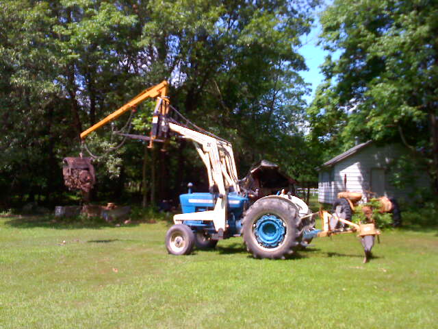

Don't know if it's woods, bought at equipment auction - meaning I'm clueless about capacity. Used with chain and brush grubber to pull small trees. Had ability to lift front wheels when tree was too big. The Ford 4000 probably weighs 3x as much as the RK24. I seriously doubt it will work. If you can buy it cheap, buy it they are had to find and someone else will think they "need it". After you have the "odd implements" you will find new ways to use them.
The overhead gantry from Northern tools idea will work. Question is can tractor move it once on the ground?

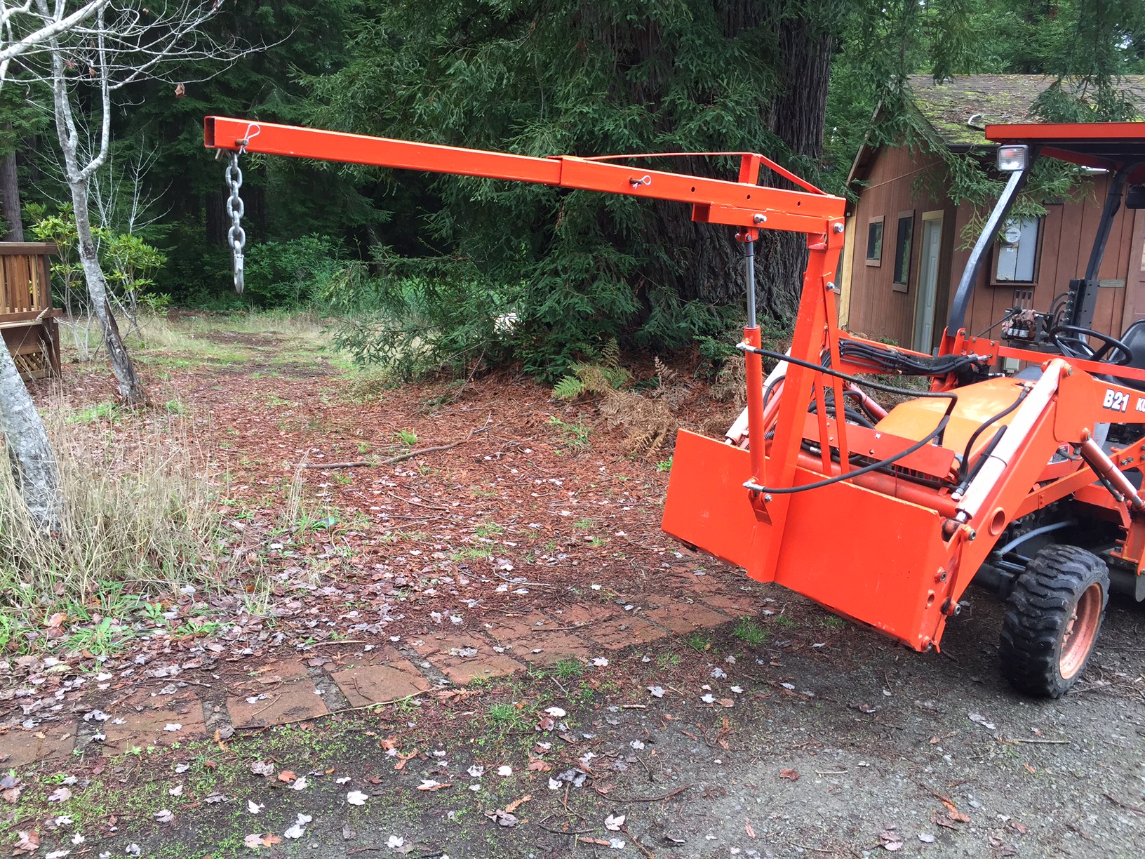

I used my old HF engine hoist to make a hydraulic boom pole. It is very handy and works fine. But I only use it for relatively light loads under 500 lbs. That is plenty for my B21 which weighs about 3900 lbs.
