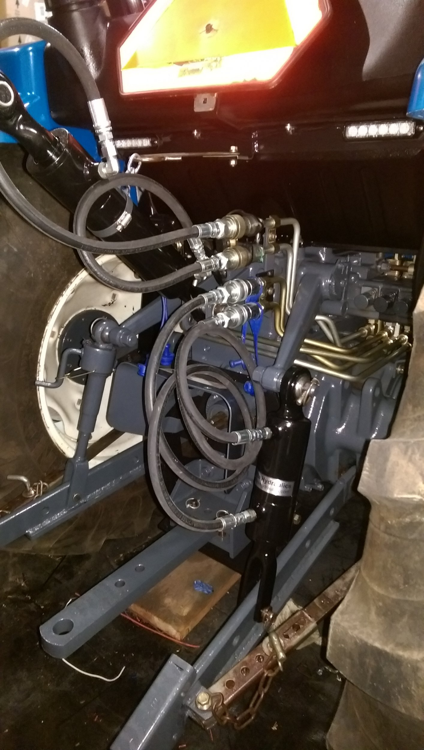

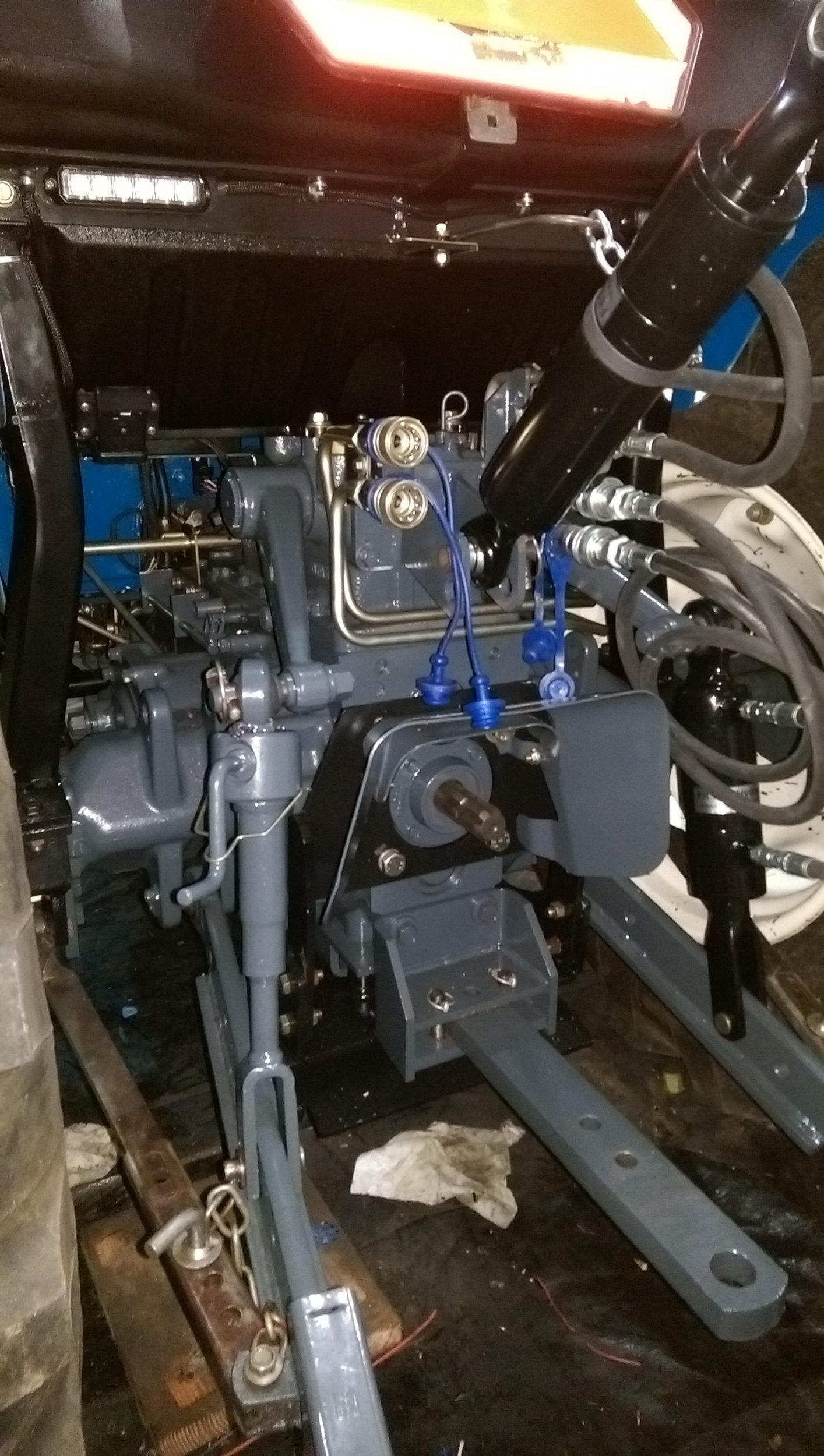

Added hydraulic Top-N-Tilt to our TC40D... Now that we have it I wouldn't want to be without it.
Brian @ Fit Rite Hydraulics make awesome stuff & is great to work with... His lead-times maybe longer than you want to wait, but his quality is 2nd to none IMHO.
I cleaned up the original manual adjustable side link & installed it on the left side of the 3pt
