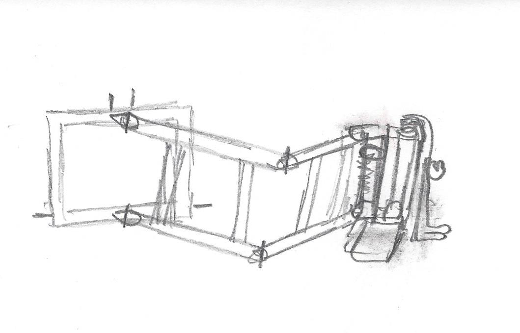

If I had to do what your talking about and going to build a puller, I would either copy the hand machine, or if I was going to use the tractor,
I would make a three point frame, and make a set of H frame arms, that would allow it to be swung out and adjustable, to get exact and back up or drive along side, and be accurate is not a easy task, (at least not for me).
and it might allow more than one stake to be pulled at one setting of the tractor depending on the stake spacing,
some may depend on if this is a one or two person operation, as well,
I would most like put a cylinder on the head to lower it to the ground and so a foot will support the puller and one cylinder for the lift, (most likely a 30" in length,)
and if the tractor had a power beyond port I would use that and put the control valve on the puller and not the tractor,
If some how I was going to try to do a one person operation, I would change the location to the belly of the tractor and use three cylinder, one to slide a arm under the belly of the tractor in and out, one to lower the puller to the ground and one to pull the cylinder,
all tractor controlled but located so they could be ground operated,
by belly mounting one could see and adjust the puller to drive up on the side of the stakes and make small side adjustments, and should be able to drive right up and on to the stake, and depending on the design of the stake and the puller, most likely pull it from the tractor seat with our getting off, and then move up to the next stake and repeat,
sketch below is of the first idea, of the movable arms

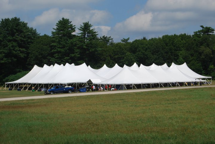

Ace10, Your point about caring for the turf is valid. Most of the really big jobs are not on a highly manicured lawn, I'm not considering bringing this to a job site for something like a 50x100 foot tent. This is for the REALLY crazy jobs, most of them are on a field more than a lawn. In the design discussed so far the pressure would be on the 3pt forks on the ground. There would be more area than most tent pullers.251545_263380937011207_4388387_n.jpg This is the type of job the BX and puller would go to.

BHD, can you explain how the power beyond line works? Is it just constant pressure? I like the sketch, I think I've come up with something VERY simple, but that might be of use for the next project.
