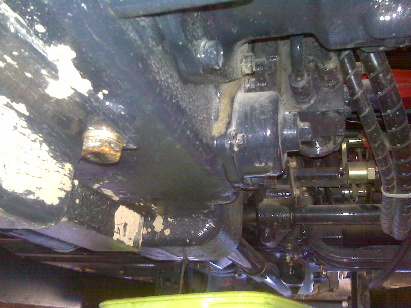

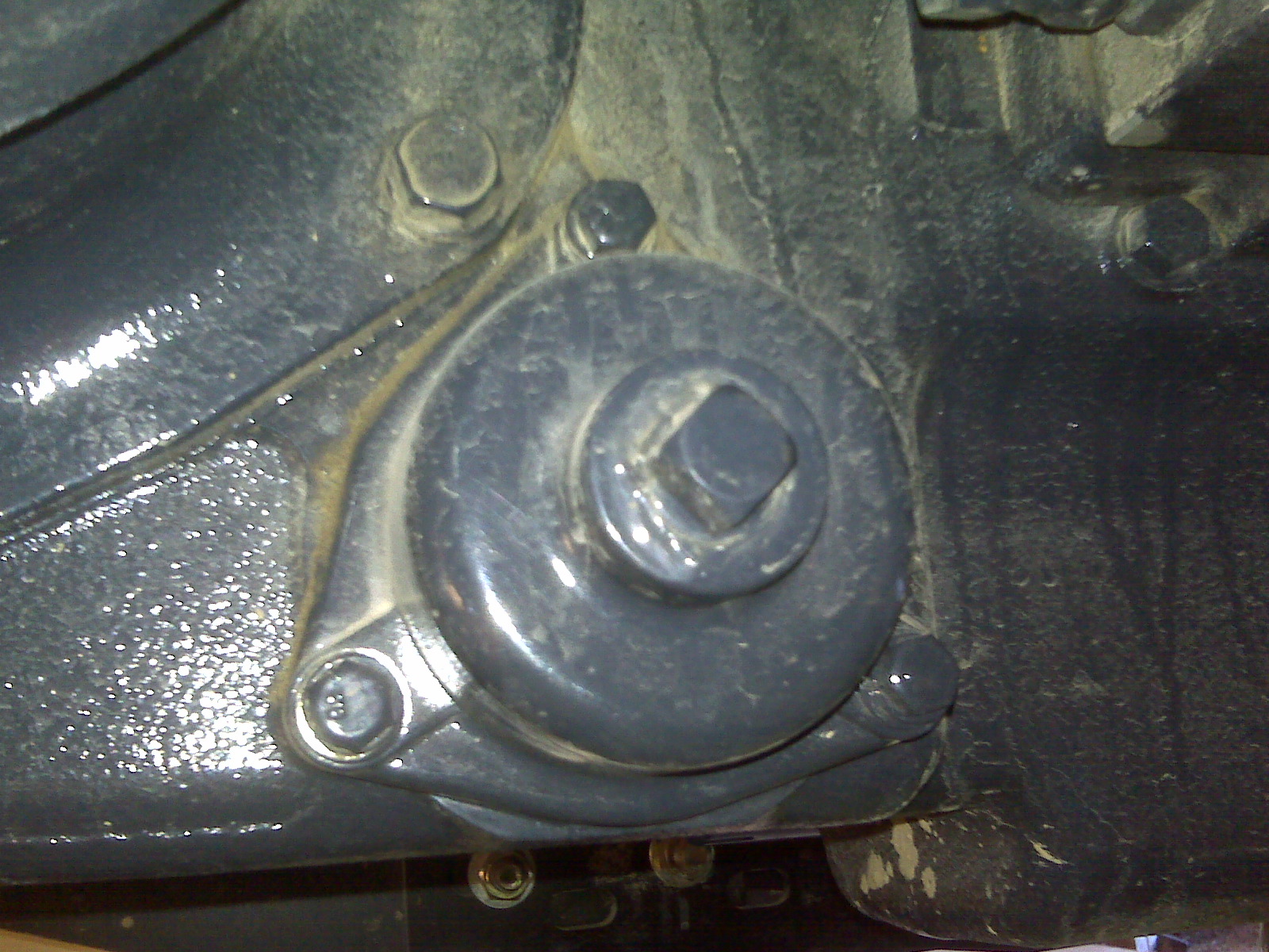

For those that don't know the filter screen on a branson tractor is under the tractor between the rear tire's . To remove the screen you must take the cap off on the right side there are 3 bolt . Remove them and the screen is right there.

Thanks for the info, but a picture would speak more than words here. ;)

Changed my hydraulic oil yesterday and cleaned the filter screen. It did have some metal shavings in it. Thanks for the tip. Sorry for the poor quality cell phone pics. The second pic is looking forward from underneath the rear axle on the right side.
