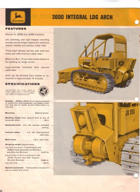

How are you goin to mount this winch? If it is the same one I have (going to put on the JD450 crawler loader), it is quite heavy.
And think about how you are going to mount it in order to pull that kind of weight.
I bought this one last year for a potential logging/clearing job and was planning on building a logging arch for it. See the attached pic for a logging arch that was an option on the dozers, to get an idea about them.
30k is a very large winch, be sure to plan carefully so you don't break something expensive.
- JC
