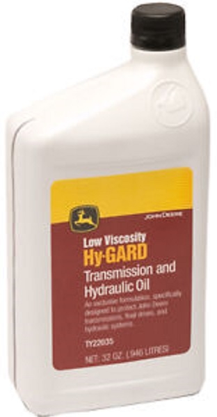

Not knowing your location nor climate, if you are experiencing J20C being slower, then J20D low viscosity works.
In other regions where J20C is hard to locate, people with Yanmars will use the Kubota UDT
As for the Baldwin B-2, what is the micron rating and flow-rate? If its too restrictive, then it will take time for a warm up of the fluid to properly work.
