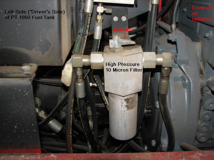

   / Hyd Suction filters #6
On the 1850, there is a high pressure Schroeder filter on one of the circuits (I do not remember which one).
Just checked the manual. They call it a charging valve filter assembly.
Ken
   / Hyd Suction filters #7
Lift Tilt Dump Steering circuit Ken...
My question is how do those filter holders work. I never have understood the guage on the top. It says if you can't turn it while engine is running then filter is clogged... confusing to say the least.
   / Hyd Suction filters #8
According to Terry this was an idea they tried out for awhile.
You can draw your own conclusions about, but I believe it is no longer included. I talked with Terry about adding it to the return line from the brake assembly (1XXX models) as this is the lowest pressure point for the least work, but there is also the additional parasitic HP load. By installing it on the turn/lift/curl circuit, the parasitic load is minimized, but so is the volume of oil filtered.
