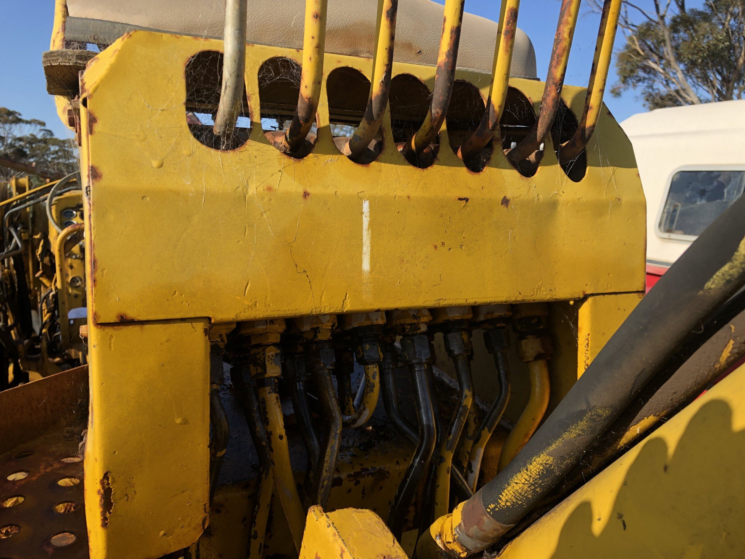

Hi i have a massey 50A backhoe cant get the stabalizer leg to retract the lever will allow leg to go down but when you pull lever back to retract it goes to center then wont go any further as if it is seized every other control arms work perfectly Cheers Ted

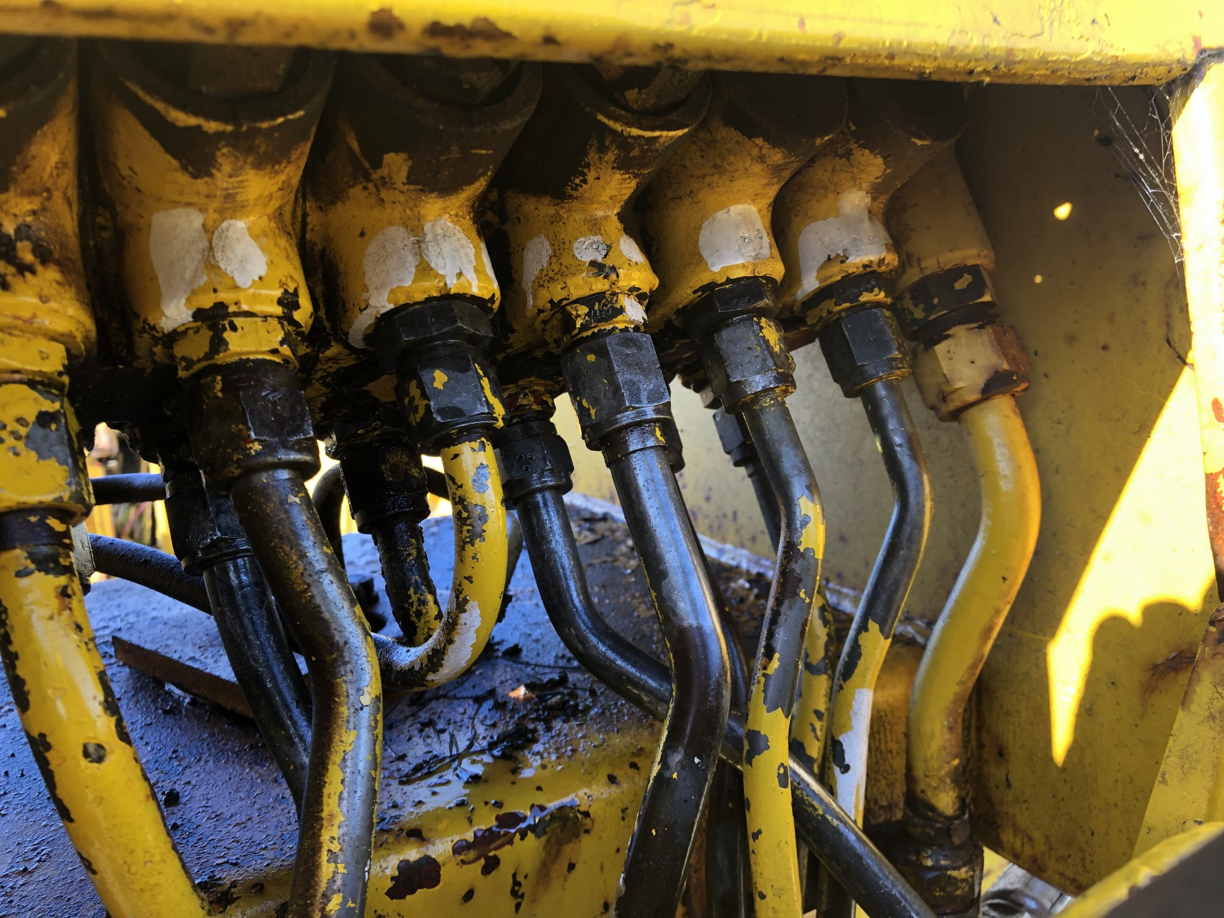

Hi no there is nothing blocking the lever it just goes to center and when you pull it back to retract the leg it is real solid i gather it is in the valve body but have never pulled one down and i am not sure what to look for Cheers Ted

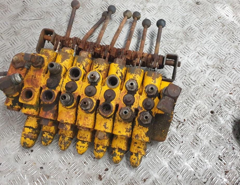

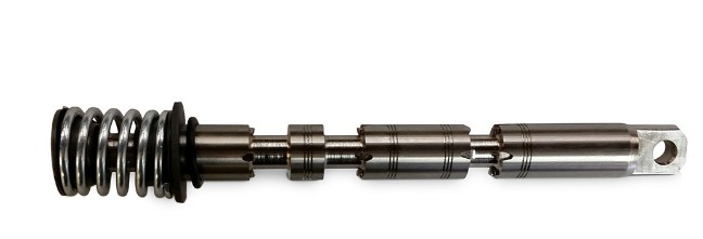

Definitely sounds like the centering mechanism in the spool cap opposite the handle end of the valve spool. Attached is the valve bank from a 50B (I can't get Massey's online parts book to work), but the cap at the bottom of the picture holds the centering spring. The spring may have broken or there is something causing it not to extend the spool into the cap. It might just be that the retainer that holds the spring in place to the end of the spool. Second picture shows what the end of the spool might look like.

If you can access the bottom end while the valve bank is in place, that is a lot less work. Be careful though of parts/pieces falling out when you take the cap off.
