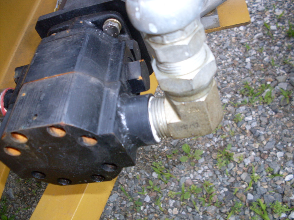

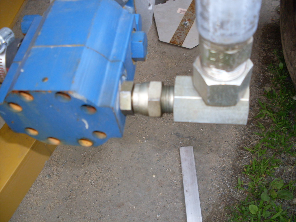

completly dissasemble the valve, tig weld in a half pipe of comparable sizecoupler (make sure its right side up) replace o ring fitting with pipe and you should be okay if you cant weld yourself maybe a local job shop, this job shouldnt take more than 1/2 an hour if you take the valve apart, this might not be worth it if a new valve is cheap enough but it does work I have done it a few times, here is a pic of similar fix on a hydraulic pump blue is original black is one I repaired ,good luck
