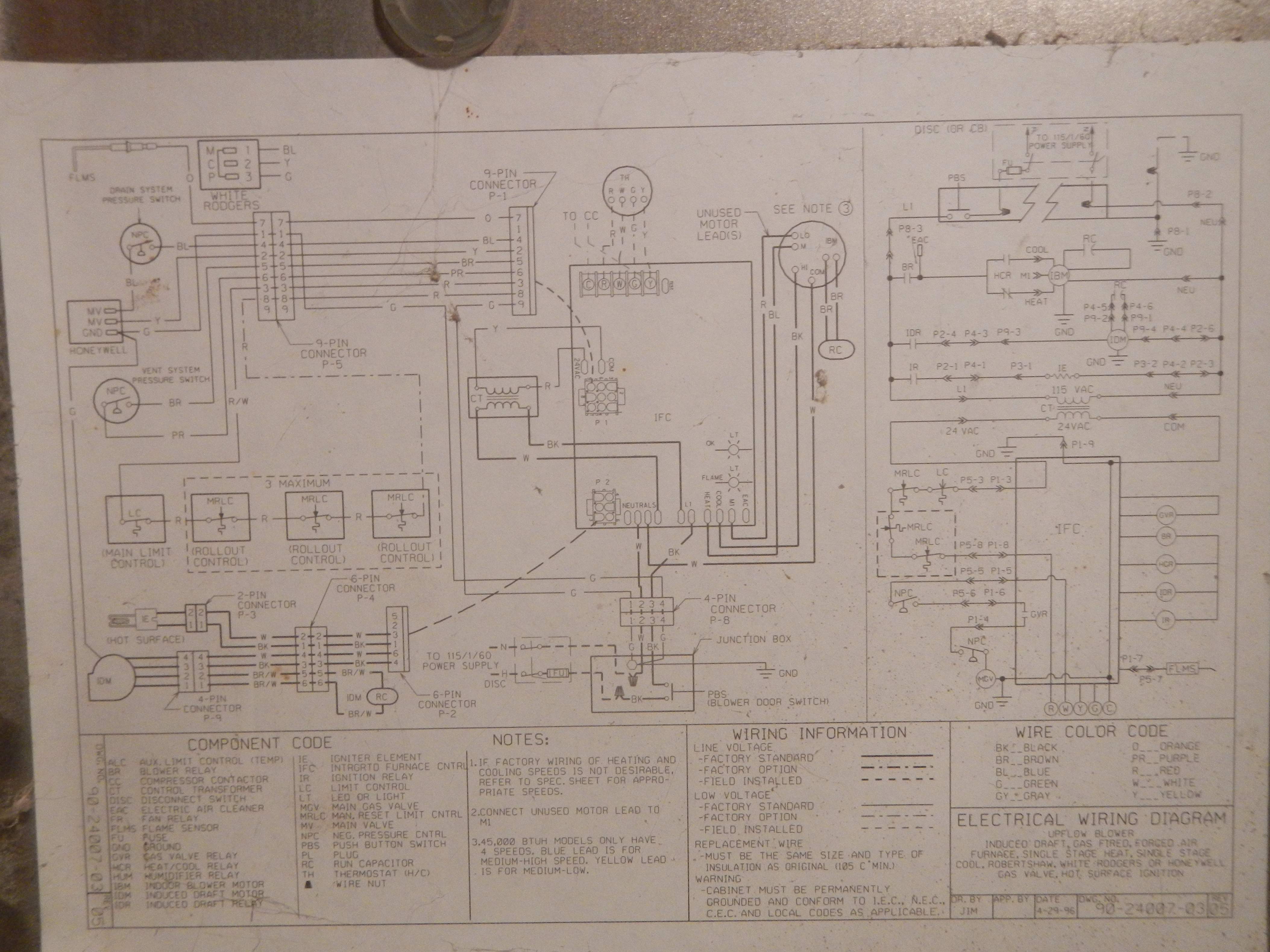

looks like my furnace uses 1 speed for heat, another for cool,, and the third not used.
here's a pic from the back of the door, sorry if it isn't easy to see:
   / HVAC wiring help #8
I would agree with what Lux says about the thermostat. Most are just a switch as they said. I would suggest simply landing on your R and G terminal in the furnace. I'm not fully understanding what your problem was, but I believe you are saying when jumped at the furnace the blower stays on an additional 90 seconds after jumper off?
   / HVAC wiring help
#9
yes, but only while the thermostat is connected to the wall plugs upstairs..
if the tstat is pulled off the wall, then everything works as i expect.
   / HVAC wiring help #10
Well then that's more than likely doing it. Not really a problem is it?
