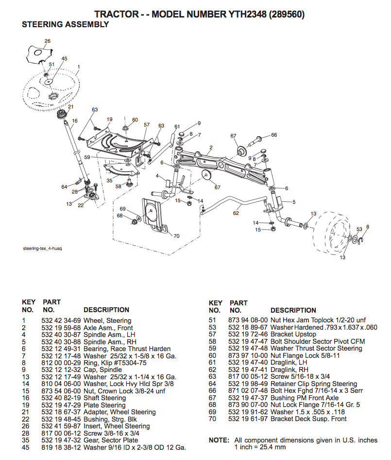

I'm gonna be helping my gf's dad replace the steering shaft on his mower. its a husqvarna 48inch cut. model # yth2348. i've been searching the internet for a video or some form of instructions so we'll at least know what we're up against. i've had good luck in the past on youtube, but i cant seem to find anything. would anyone have an idea where i may find a video or any instructions online. any help appreciated. thanks much
   / HUSQVARNA STEERING SHAFT #2
You may have this already, but here is the exploded view of the steering assembly from the 2009 model year YTH2348 Owners Manual.
You may want to check with Husqvarna Customer Support at: General Information - What is the phone number for Husqvarna Customer Support?
Good luck!

Thanks much. I'm not sure if he has that or not, so i'll print it and take it just in case. I think he had to order the part. I'm not sure when he should have it.
