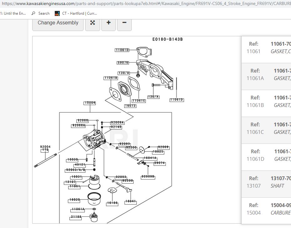

Oddly, I'm able to find the engine on a Kawasaki parts site, but, they just show the carb; not the associated parts like the spring... (see image)

fr691v-cs06 I see now :)
   / Husqvarna LGT 24K54 - Choke lever spring (need new one - can't find engine schematic) #7
So yours has a separate choke control. Does it have a separate spring other than what may be on the choke shaft? The diagram in the control section doesn't really say what all the springs are for.

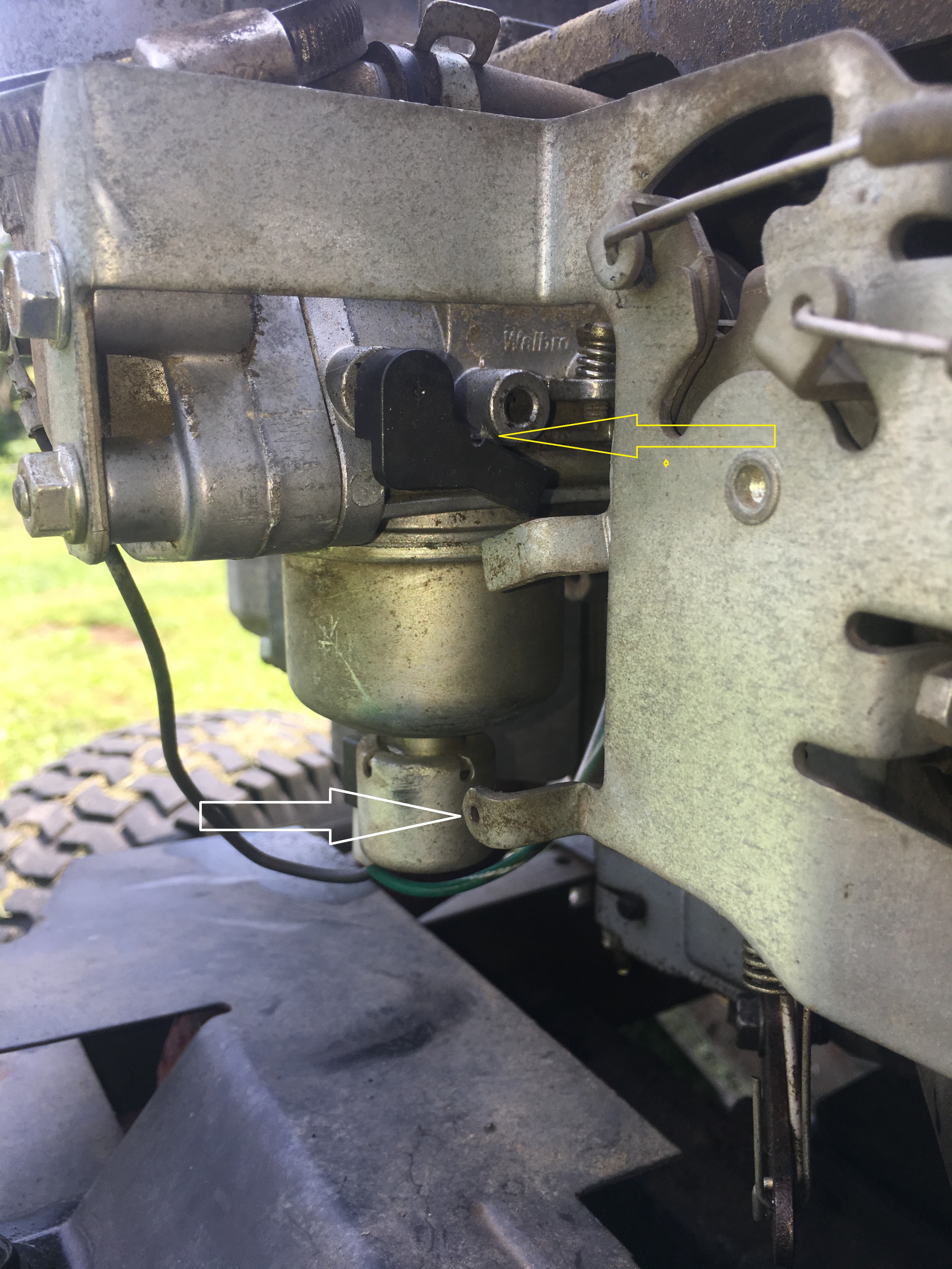

Hi Tom. Yes, I have the fr691v-cs06. I believe my setup has a separate choke control, as there's only one control to it :). There's no other spring. In the image below, with the spring missing, you can see the black choke lever with the yellow arrow pointing to where the top of the spring would seat. Below, with the white arrow, you can see where the bottom of the spring would anchor, in that metal tab with the little hole; (if visible).
As mentioned, I mickey-moused a bigger spring that is achored about 3" below under a frame rail and it's working. I'm just a wee bit frustrated that I couldn't find the correct part. I don't like to mickey-mouse things.

Item 92145A on the control diagram for you engine on Kawasaki parts diagram. Part number 92145-1812
   / Husqvarna LGT 24K54 - Choke lever spring (need new one - can't find engine schematic) #10
Maybe Randy could double check the number. It looks like a bolt? or maybe swing by Deere and grab that other number.
