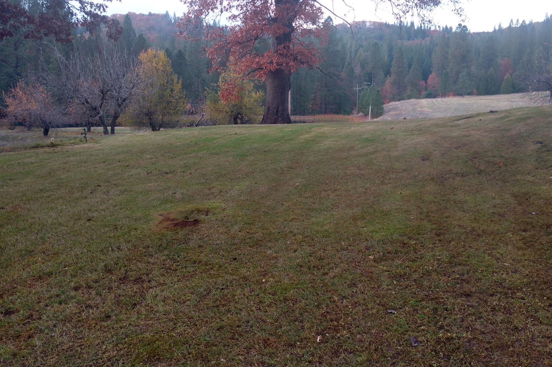

Finally got a very good workout with reasonably deep cover of semi-wet leaves yesterday. The Husqvarna GT48 mower and Cyclone rake is a good combo.
Last year, three of us spent at least a half a day raking leaves onto tarps, emptying the tarp into my dump trailer, and then dumping leaves. I didn't track my time yesterday but it was between an hour to hour and a half to do about the same amount of work. With very little physical effort.

Their models range from a bag that handles 22 bushels to a max of 44 bushels. I bought the least expensive model that offered the 44 bushel capacity and I'm glad I got the bigger bag. (415 cu ft.)
Even with that large capacity the thing is so voracious it fills it up as far as I want it after a few long passes. At about 2/3 full of non-dry leaves the front steering authority on my mower starts to diminish. I need to get some front weight on the mower if I am going to be hauling around full capacity of chopped, mulched, wet leaf debris. But ... no complaints, the thing rocks.

I learned today what the Husqvarna/Cyclone Rake combo does not like. Plowing through piles of wet leaves that are about 18" high.
I used my blower to blow a *lot* of leaves from the gravel driveway areas onto the lawn. But it created long strips of leaves-- about 18" high, maybe six or eight feet wide, and ..... extending a long ways. I tried at first a normal to slow speed pass over it. Killed the mower engine. Then I tried lower speeds but the leaves were pushing into an even bigger pile ahead of the mower. My feet on the mower deck were getting covered with leaves that were overflowing from the sides. Definitely pushing things beyond design limits.
But, I learned that if I raised the mower deck to the very top, took only a partial "bite", and went slow, it would mostly work. I did have to backup then take a new bite somewhat frequently. Otherwise the pile in front would get ridiculously large-- above the top brush guard.
I now have about 15 dumped loads of 44 bushels each. Compared to the 7 bushel bagger that is the largest for the back of a Husqvarna or the back of a Deere X380 that I also considered, the Cyclone Rake bag is more than six times as large. If I only had the standard bagger with no Cyclone Rake, I would have needed to make more than 90 trips to dump leaves so far. Argghh.
Did have one other exciting time. I was plowing through about 16" of leaves on a slight side slope when all of a sudden the mower stopped. At first I worried that maybe the hydro went out. I could push on the pedal but ... nothing. I noticed the left wheel was spinning and the right wheel was stationary. A click of the differential lock, and I drove right out.
I need to do the leaves more frequently. Piles of leaves a foot and a half high are definitely beyond what any of this was designed for.
