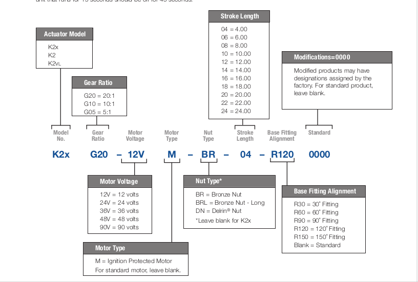

To answer my own question .......... it appears the
Husqvarna 532421769 ACTUATOR.ASM.DECKLIFT​
Has been discontinued. Now I need to find out if there is a manual means to adjust the deck if the actuator dies. Perhaps just finding a replacement actuator motor is feasible. Time will tell.

I can order one from China ......... if I order 4999 more to fulfill the minimum order quantity.
I suspect sometime in the future I'll have to "engineer" some sort of manual winch for the deck.

Depending on the actuator size, (I use Thompson/ Warner repairable actuators on my GT) they have sizes for everything and if they are the same size as on Johnny Buckets they are sold discounted. The Warner sight has PDF's and how to measure the actuator help.
I wrote a little something on actuators here,
Also the "how to decode" actuators from Warner, and there PDF of actuators are attached, they are a couple years old but still pertinent.
I hope these can help.
GT
  • warner-electric-actuators.pdf
