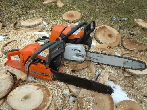

@John_Mc mine got deleted while in Big Dave's hands getting ported. Many many years ago. RIP
Dealer up in MI that raced too.
This saw was built by him also that I learned on for first hotsaw. Piped 084.
