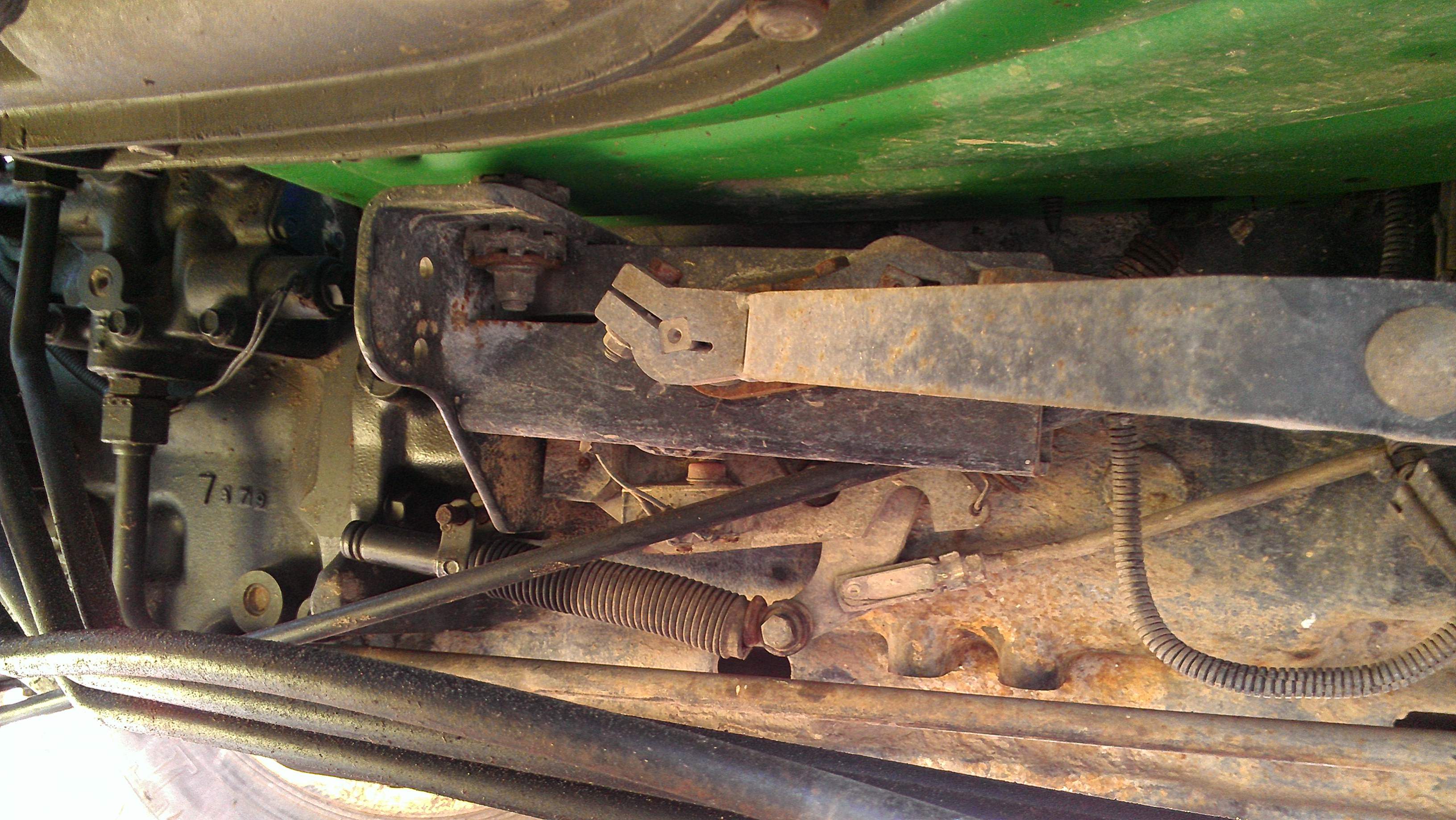

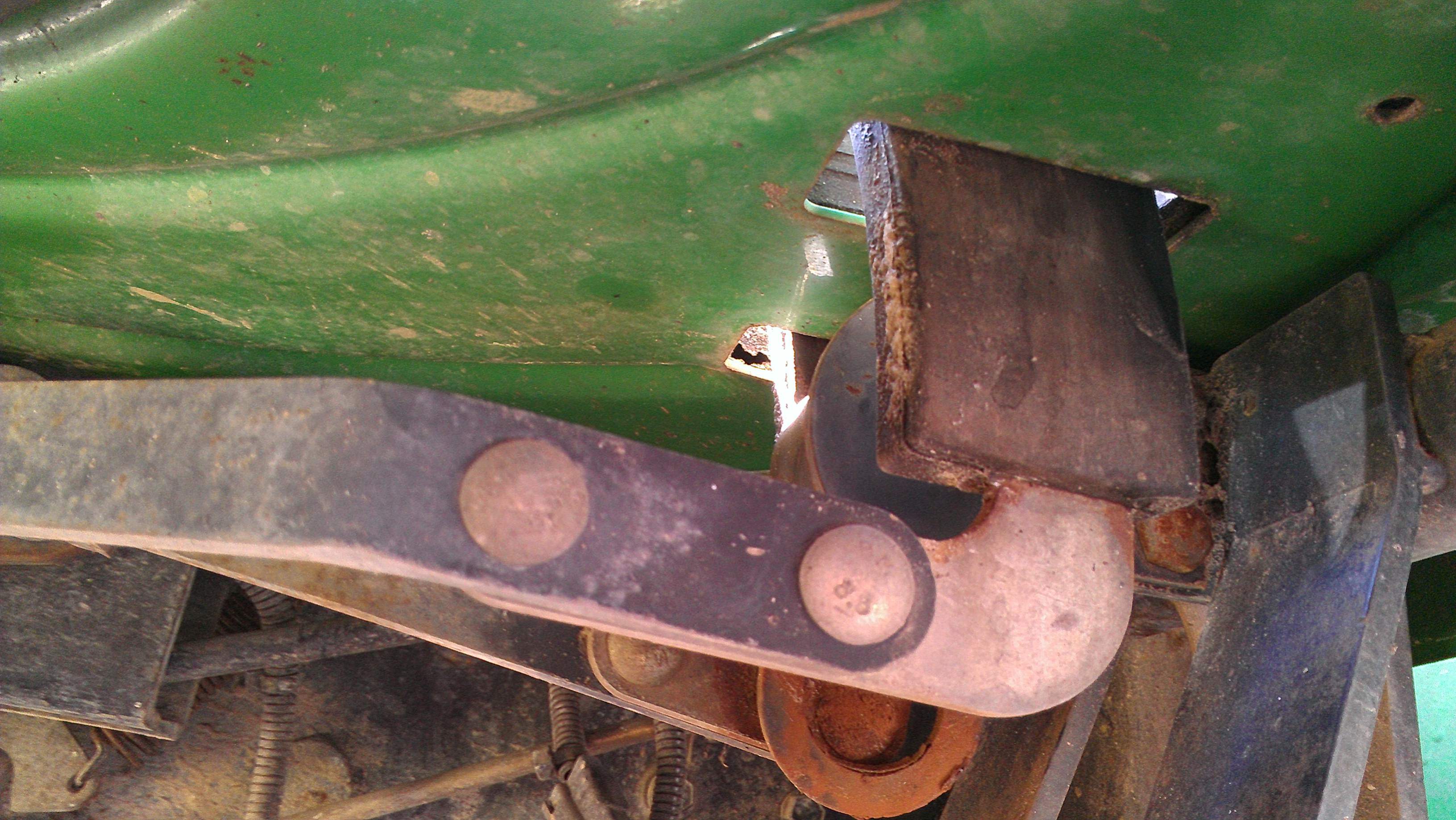

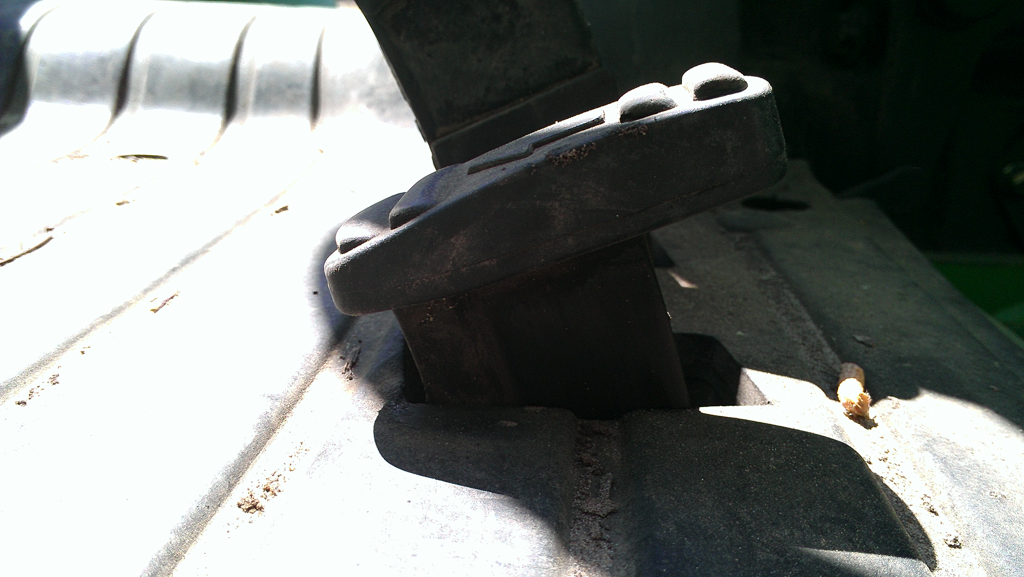

Here are some pics of my setup. The first pic shows the pedal. It hits the floor pretty quick...

Well, not much can be concluded from the photos at this point. You have to determine if the angle of error is at the transmission end or at the pedal end. What happens when you reach down and pull up on the pedal?
