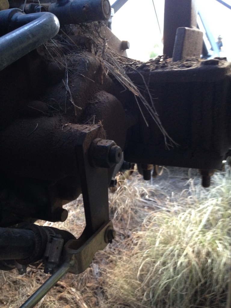

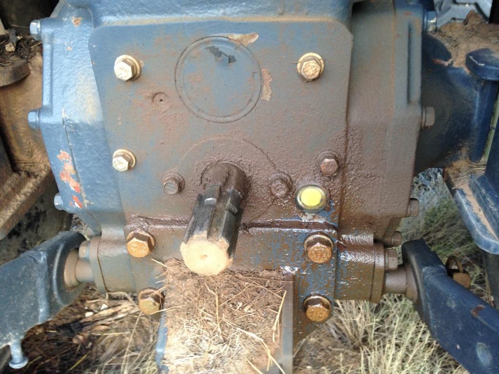

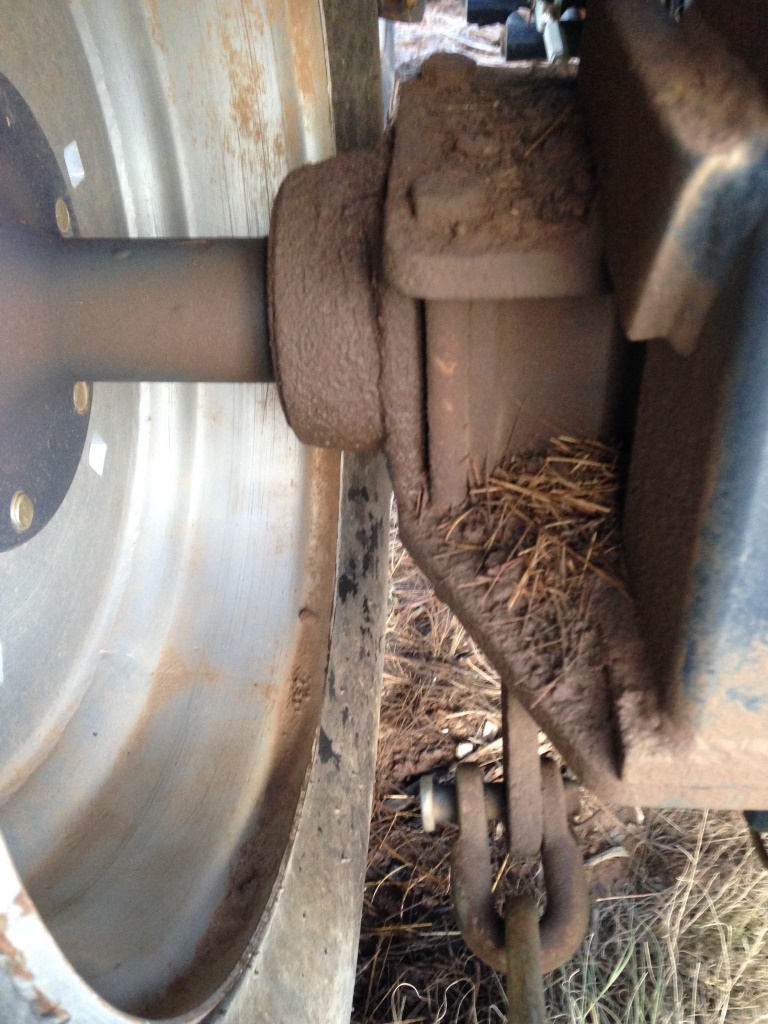

I have a slow oil leak in the HST. Seams to be coming out from around the left side axle shaft and the PTO shaft. Has anyone had this and what did you do to fix it?

Sorry it took me so long to post this. This has been the year from ****.

Could the leak be from the sight gauge? I remember a few threads about replacing the gauge itself. You can search them out.
   / HST Oil Leak #5
That was my first thought. Pretty much what is going on with my 273 now, but I did have a leak near the rear axle seal not long after I bought it (2006). It turned out to be the leak was around the bearing housing and not the seal. That didn't get to the pto area though. I recall some owners on here saying they had hydro fluid leaks from the overflow vent under the seat but I haven't had that yet. I'd go with the sight gauge issue.
   / HST Oil Leak #6
I agree with both of you, might be two leaks going on here. The sight glass is definitely leaking from looking at the first picture. That is a simple fix and can be done without draining the HST completely if you can park downhill. It does look pretty full from the picture though. I'd take care of the sight glass fix and then give the rear a good bath to clean it up. Then when you start to see oil and dirt collecting again, you will have a better indication of where it is coming from.
   / HST Oil Leak
Do you know of a sealant that will work below 32 degrees? What is the process to pop the sight glass out. I may have over filled the HST. When I looked at it I could not see the level so I added oil. Now I think the angle of the tractor had the site glass full. I am going to have to move it to get it to a safe spot to drain oil out. Might as well do an oil change now and be done with it.
   / HST Oil Leak #8
Can't recall exactly what I used, maybe Permatex Oil Resistant. It is good way below 32 degrees. All you have to do is pop out the old one with a screw driver and clean the area, insert the new with a bit of sealant. Give it 12-24hrs depending on the silicone and call it done.
