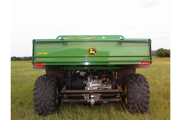

I've always thought the HPX should have taillights. Most of the other UTV's have them and I know Deere offers them as an additonal option. But, I decided to install the lights myself.
I picked up 2 small LED lights at a local AutoZone and installed them below the tailgate. The LED's are durable and can withstand the vibration and hard work this machine will see.
I wired them in with the headlights so they come on when you hit the switch. These little guys consume very little electrical power and are really bright!
Here's a pic of them in daylight, turned off.

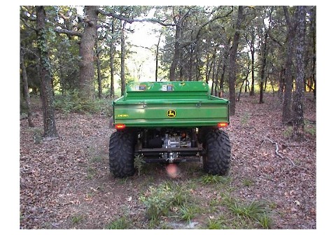

A pic with them turned on, in a shadowed area.....

A close up.........

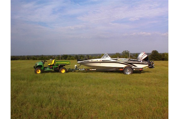

I'll throw this in too.
The little diesel is really stout!! Pulled my boat around with ease!!

Funny you should post this thread. I have been mulling around the idea of putting tail lights on my 6X4 Gator recently. In the last 2 weeks I have added a horn and a 12 volt outlet. The horn is great for getting the dogs and kids out of the way. The wife wondered what I would use the outlet for and the other day I had a 16ft utility trailer with low tires. I drove the Gator out there and plug in my little 12v air compressor and filled the up. How much did the LED lights cost?

Brent,
They were right at 10 bucks each so I only have $20 in the outfit. They are made by Blazer and are labeled as "running board lights"
Plan on installing a ground strap from the bed to the frame otherwise the ground is intermittent. On my HPX, there was a pink wire looped out of the wire bundle under the hood that I tapped into. They evidently leave it looped out for adding the tail lights later so it made it easy.
