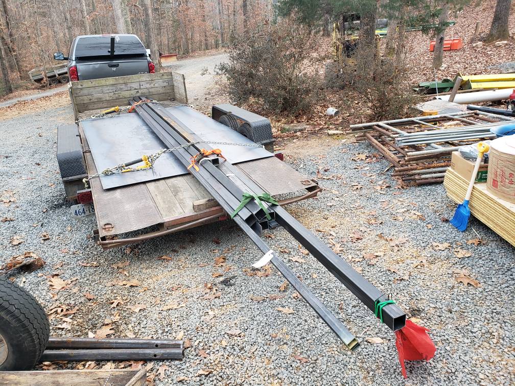

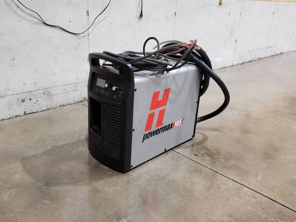

Pocked it up today, my machine torch wont be here for a couple weeks so I'm going to borrow a buddies hand torch to test it out, I did plug it in and it powers up and it switches through all its functions.
I have a trailer of steel waiting and hope to start on the table this week.
Other mechanical components are on order and I'll be ordering the electronics at the end of the week most likely. 20181211_173707.jpeg20181208_160552.jpeg

Also are you going down draft or water table? Power Supply looks good !!

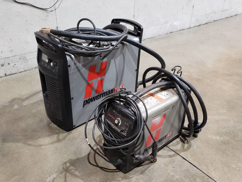

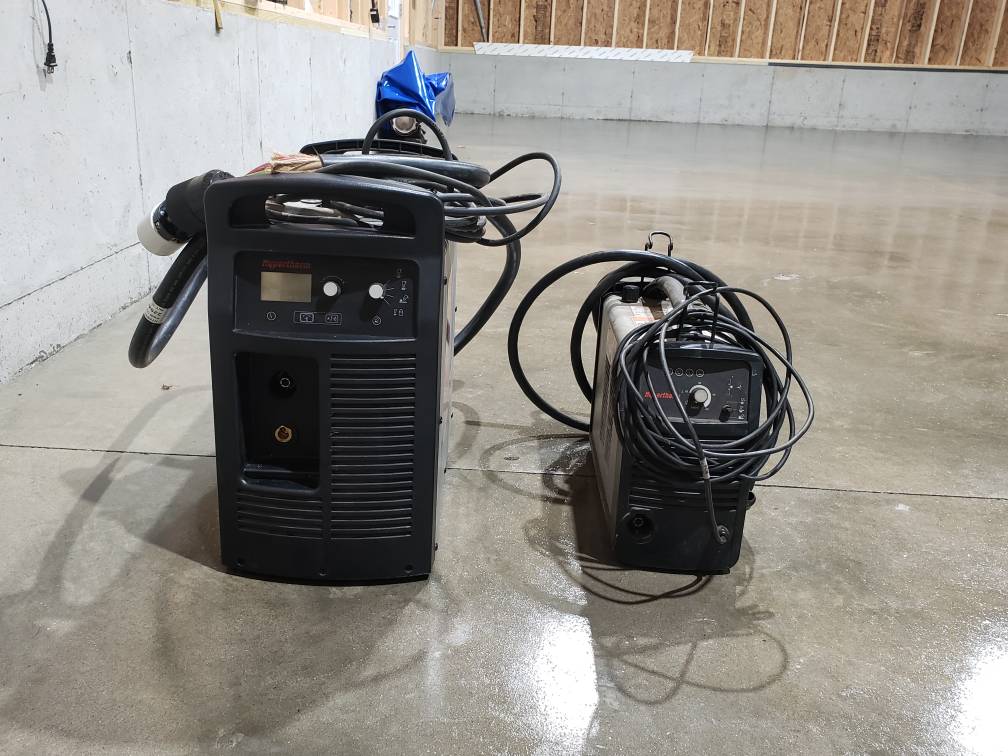

The guy wasn't exaggerating when he said the unit had very little usage, it looks like new other then a little dust. I wish it already had the rs485 port but that's easy enough to add.
Have been moving equipment into the new shop so I figured I'd get a picture of the 45 next to the 105 :)20181211_214303.jpeg20181211_214311.jpeg
