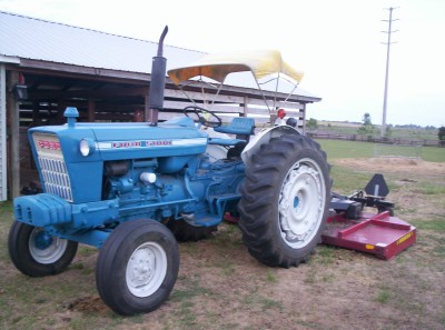

I've had Ford and JD rotary mowers as well as KK and howse. No doubt the 'name' brand mowers were tough stuff.. and had a tough price tag.

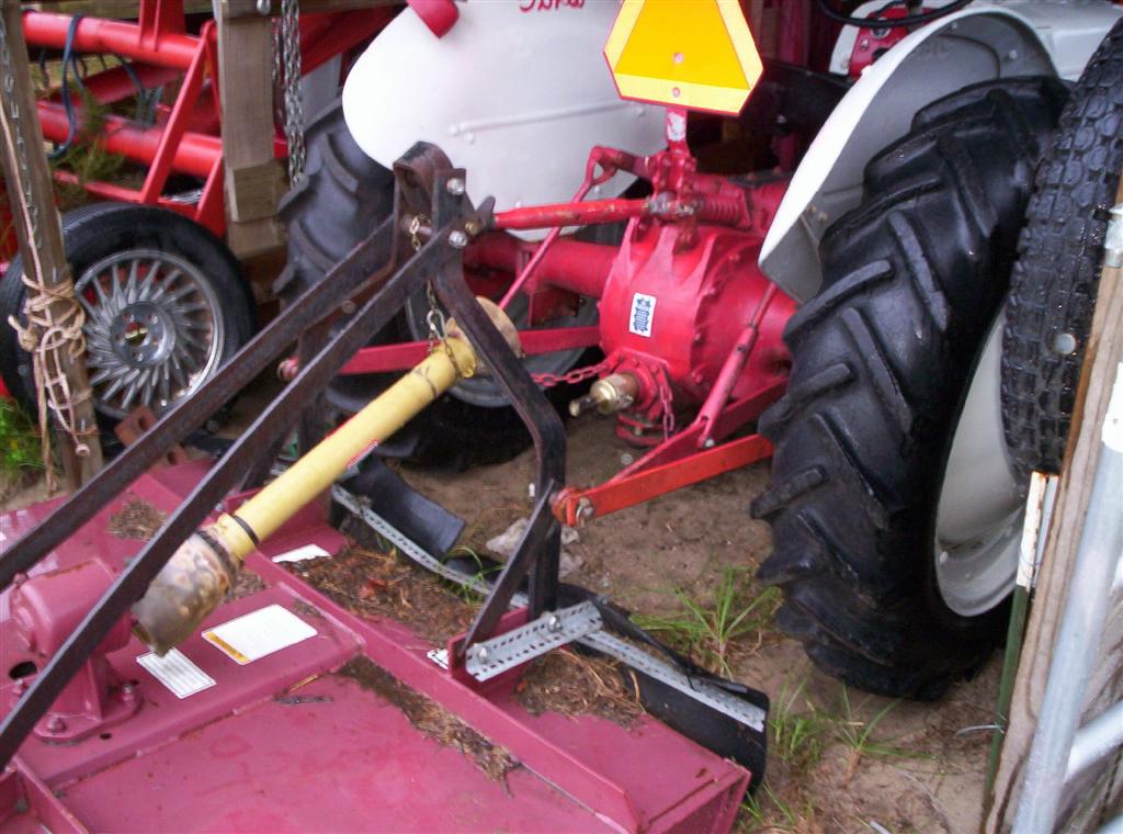

I pulled a 5' kk behind a tractor rated for a 6' mower for 6ys.. then traded that tractor and relegated the 5' mower to something more it's size.. an 8n.. and have been mowing with it for another couple years. Paint is just a tad faded.. but it is otherwise in great shape. I've probably put a box of shear bolts thru it in its life.. but it's holding up fine.
My howse is a bigger on.. on of their HD series.. a 10' model. It too was pulled behind a tractor rated for a much larger mower.. a NH 7610s. Mowed with it for a couple years that way and then moved it over to a slightly lower hp tractor.. my ford 5000. It't gets less use now but also is still running fine after 3 years with noting more than a bolt that came loose.. and that's my fault cause i assembled it. both are pictured below.
I paid real reasonable prices for those mowers when i bought them.. I think about 500$ for the 5'kk from tsc and 2450 for the 10' howse mower from an auction/dealer ( mower was new/never sold ). I couldn't touch any o fthe name brand mowers for that price range. I don't exactly squeak when i walk.. but I'm pretty tight with my money...

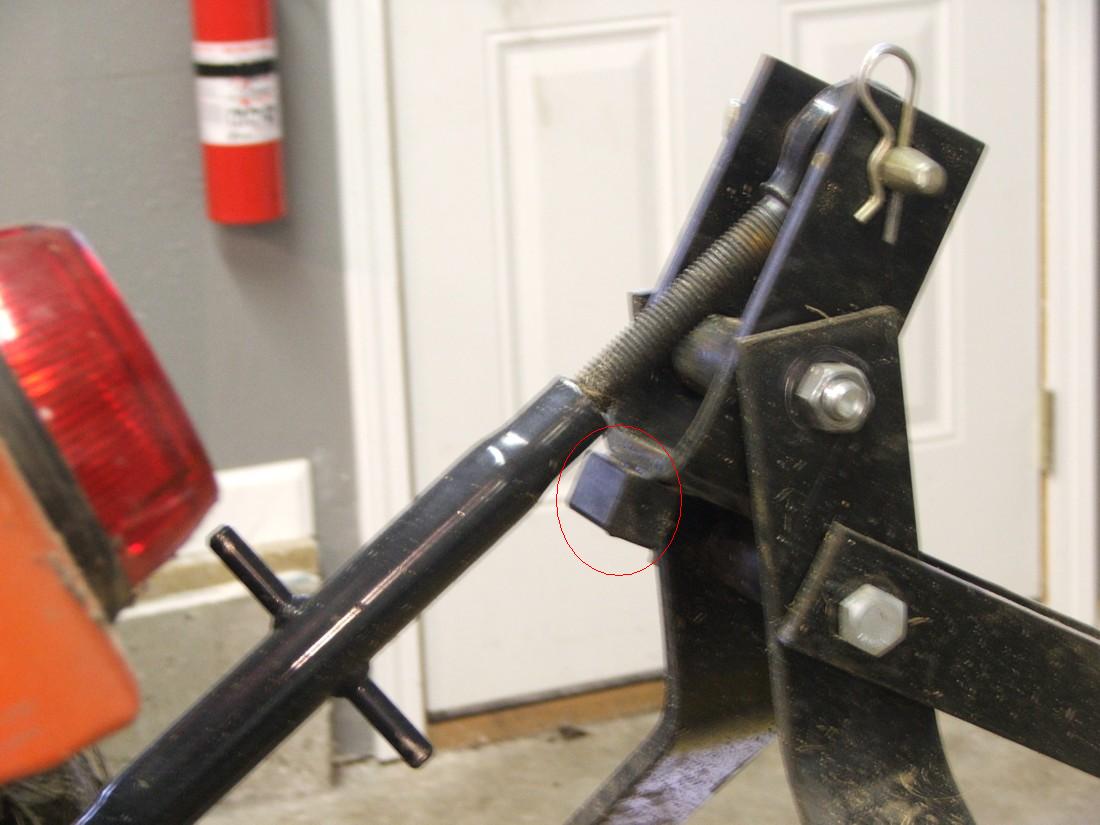

Sound guy,
from your photo of your king kutter mower it looks as if you are missing something, the way it is hooked up currently if you were to drive into a valley the toplink would bind and may bend something. my king kutter mower has a little piece welded to the bottom of the U to prevent the pivoting link to get in a position like yours.
Just an FYI don't want you to break anything.

That is the new design.. the old design didn't have the tab.. I just run a bunji thru it and it holds it inthe up postition when relaxed.

I've run the old design for over 30 years and never had a problem.
