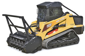

For making trails I would suggest you try to find someone in your area that has one of these skid steer forestry mowers. Can make a trails the width you want and shreds everything into chips. No trees or brush left for you to chip or pile and no stumps to deal with. Check out the construction equipment forum. There are a number of guys there that have them. Lots of pictures of their work too. Very cool.

Given that you say the trees are no bigger than 2.5”, someone with a heavy bush hog could mow right through them. That type of mowing is done all the time for power lines and fire breaks. Personally I think a mini-ex is over kill for that small of trees. Seems like my 40 hp tractor would pop them out of the ground or a Bob Cat with tooth bar on the bucket would do the same. With 75 acres why not push the stuff into some piles rather than chip. You could burn the piles or I prefer to leave them as wildlife habitat. Little critters love piles like that to make dens.
