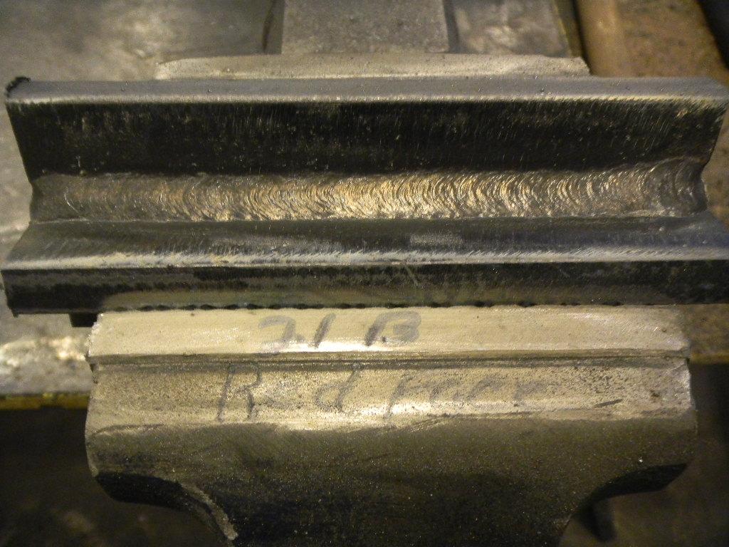

A good general purpose self shielded flux-core wire would be the best bet and I'd recommend something like Hobart Fabshield 21B. Look it up on the internet and see what volts and amps is uses. 5/64" might be OK but I think .045 or 1/16" would be better. You can get stronger wires with impact strength if you need something really strong. Either that or just use 7018 stick rods. Getting a gas valve so you could run MIG would be a good idea but you'd have to be indoors or use a screen to block any wind. You never know when you might have sheet metal or a big gap to fill.
