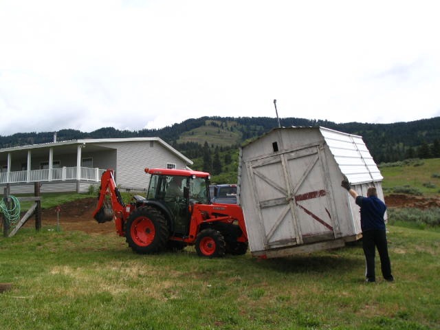

I need to move an 8x16 storage building back about 12 feet.
It has 2 skids running the 16' length, but I need to move it back in the 8' direction instead of going the same direction as the skids run.
Would 4'' plastic pipe work for rollers or would the weight of the building crush the pipe?
The building is 2x4 frame construction with aluminum sheet siding.
Wonder what the building weighs?
Will my BX23 be able to handle pulling or pushing it the 12 feet?
Anybody got a plan for doing this?

   / HOW WOULD YOU GO ABOUT IT? #10
Like this
Just kiddin :)
