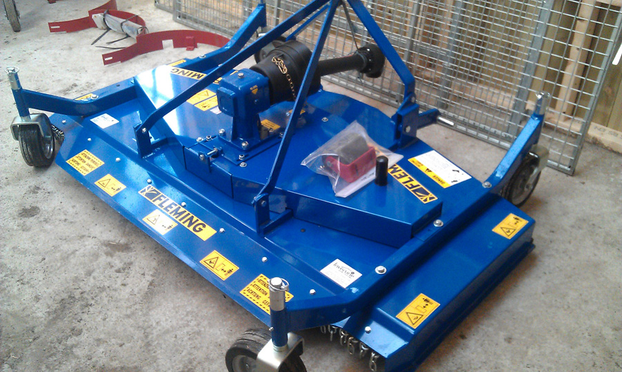

This is what I finally purchased.
The Fleming FM180 is a rebadged Sitrex. It is 6 foot wide.
Brochure: Brochure:
I still have to fit the mulching kit and the anti scraping roller.
It will be at least another 4 weeks before the grass starts growing so once I use it in earnest I will let you know how well it works.
