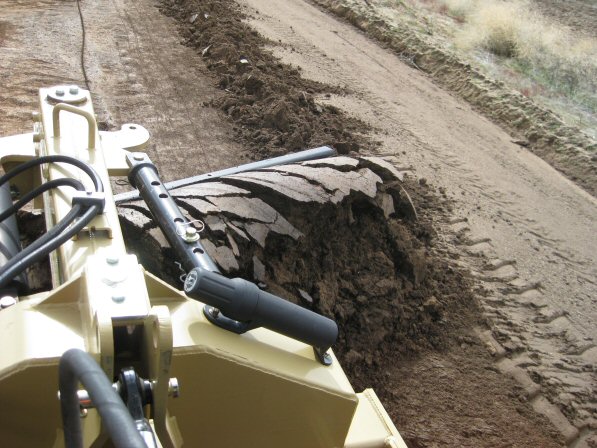

What is everyone using draft control for other than plowing that is?
I use it when building new roads or even if I am just making a heavy cut with my rear blade.
Wow, now THAT is a back blade! is that something my little 47 HP could handle?
