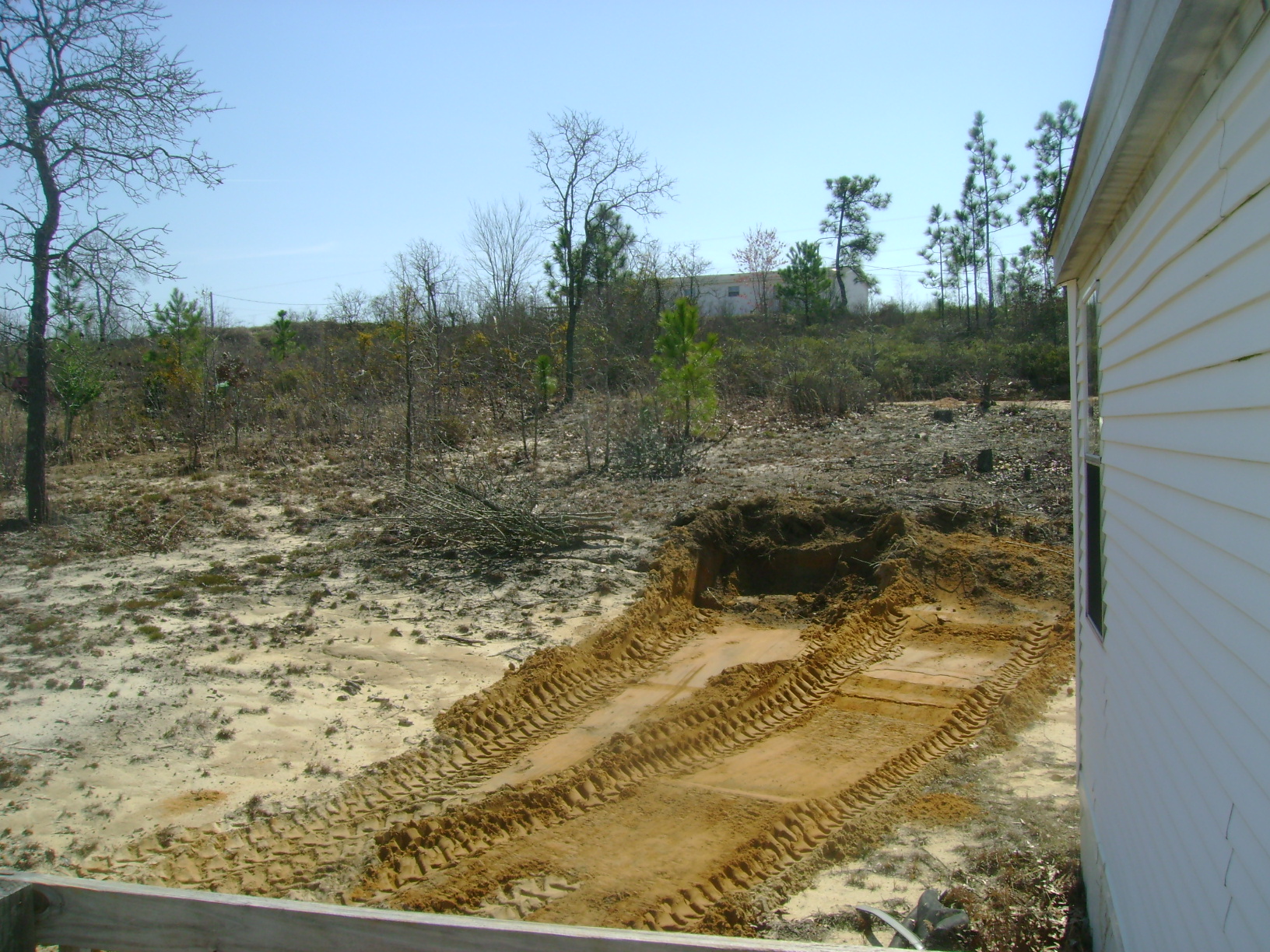

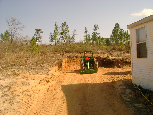

If the ground is hard, then a tooth bar will help alot with digging. Think more along the lines of scrapping the top layer than digging and you will get more work done. Once you are below ground level then you can force the bucket into the side of the hole and using tilt and raise motions brake that dirt loose. Hopefully you have 4wd cause it makes all the difference in the world.
