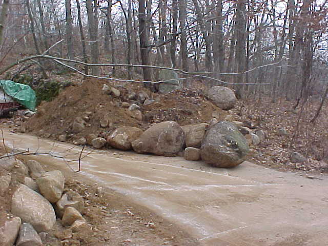

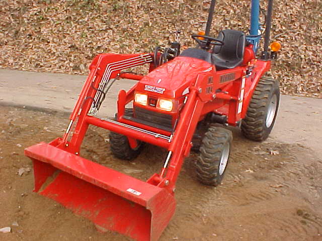

I had a big rock that needed to be moved.. I could not lift it. I centered my bucket and with just a little up pressure, I was able to push it.. When I had it pushed to where I wanted it, I got off and was looking , quite impressed that the little tractor had been able to move such a large rock, but I had bent the top bucket lip. /forums/images/graemlins/frown.gif /forums/images/graemlins/frown.gif I hate the fact that my new tractor, 30 hrs, has a bend in the bucket.. What would be the best way to straighten this. It is in the angle at the top of the bucket... John

The rocks

I really can't see where your bend is. You will need a torch, large hammer and some time. One cure for future bends is to put a piece of heavy pipe across the rear of the lip and weld it all the way across. This will strenghten up that whole area.
   / How to unbend a bucket #5
I see the bend in your post, And if it was mine I would get a block or length of steel and a large C-clamp.
Put the block of steel on the outside of the bent area and then put the c-clamp where the bend is and see if it will pull out. Some do and some dont. If it get to be to much for the c-clamp add a little heat with a tourch to the bent spot, then it should be able to pull it out.
Add if all fails smile and know the you beat the rock.

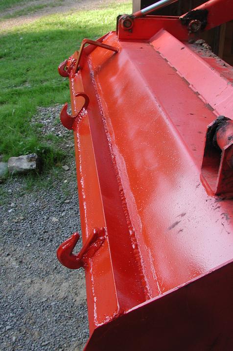

I would "unbend" it by getting a piece of heavy angle, 2x2x.25" or 3/8" even better, and weld it across the top edge of the bucket. This would hide that little bend and make the top lip MUCH stronger.
Then I would then weld three bucket hooks on top of the angle, before painting everything matching red... /forums/images/graemlins/blush.gif
In my case I used grab hooks in front of the loader arms and a slip hook in the center and I am pretty happy with that setup.
My bucket top lip is a different design than yours, but after welding a piece of angle on it, it has become quite strong...attached is a picture of my setup... /forums/images/graemlins/smile.gif

Not to get away from the posted toppic, But I think this might relate to the bending of a loader. I was looking at where henro added his hooks, When you look at his posting there in a place that if you lifted a heavy load it could bend the top rail on the loader. When I had mine added to my loader I made sure that they where welded on the very outside of the top of the loader. This way they have more saport with the side walls of the loader bucket.
I guess we all have our reasons for what we do, So on and so forth
