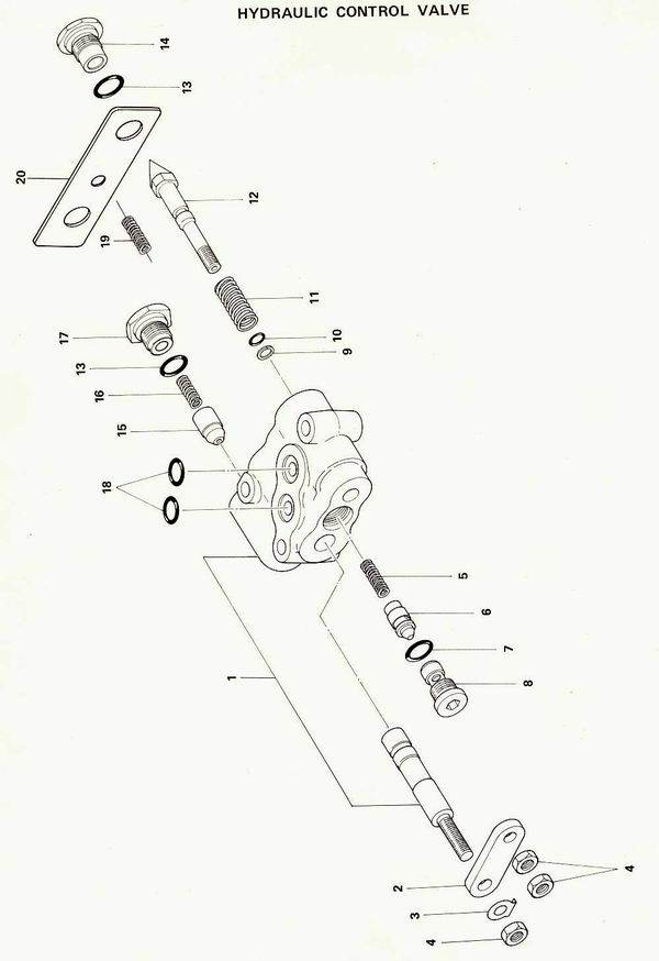

can any one help with trouble shooting a 3 point hitch hydralics system.lets say 1. there is fluid
2. the fel hose is connected on the hydralic line.quick connectors.
3. with the engine started and the lever moved to the up position it does not lift.
what to check next?

i have in the hydralics jd20 fluid. it is full. i tried air pressure at the rear vent hole with tractor on and off while working the lift lever back and forth. it still will not lift. i opened the pressure relief valve that is near to the gear shift and crank the engine. fluid came out of one of the holes. i blow out the pressure relief valve with 100lbs air so it is clean. put it back together it still would not lift.any help would appreciated.
   / how to trouble shoot 3 point hydralics
oh i took off the quick disconnects and blew air through so there is no restriction all the way to the pressure relief valve. i think that the pump is fine cause i put my thumb over the hole while cranking and it blew fluid .i dont know what else to do. i was told to change the fluid to a thicker oil but i dont think that is the problem.

i blew air into the hydralic line. the line that carries fluid to the control valve and the lift piston. i can hear the air gushing out.there is no back pressure.its like if the pressure is diverted from the piston. i have read that the control valve could get stuck in a neutral position.in this position the pressure or oil gets dumped back into the resovour.
   / how to trouble shoot 3 point hydralics #8
Control valve stuck in the neutral position sounds like it could be.
#9
i pulled off the reservoir and took off the control valve. i blew air into one of the holes and it is coming out of the poppet valve discharge outlet with any position of the control lever.i unscrew the poppet valve.the big nut with no hole and remove the spring and the piston. the piston was a little tight to come out i found a piece of crud on it. i cleaned and replace poppet valve,spring and tighten down.then i air tested .when the control lever is pushed in air comes out the second hole and when released the air comes out of the poppet valve discharge.dont know if it will work on the tractor as yet but it seems to be working the right way now.thank you all for your help.

some helpful pictures on the hydralics.
   / how to trouble shoot 3 point hydralics #20
Mit- Back in July, when I made the other post, I also made another post, which I don't see now. Maybe one got dropped when they invented this section of the forum this summer. Anyway, sorry for the wisecrack, just my nature, trying to have fun at another's expense. With regard to your diagrams, I would take the control valve in the first diagram apart, carefully, as the springs inside can sometimes cause the assembly to pop apart, losing parts in the process. First thing to do is to bleed off all pressure from the system, by shutting off the tractor, and cycling the valve handle back and forth. Then remove any hoses connected to the valve, and dis-assemble one component at a time. Check for sludge buildup, broken springs, plungers that are stuck in bores. If after thorough inspection and cleaning, you can't find the cause, it may be time to get the manual, and go through it step by step. I'll check mine and see what it says, but I don't have the loader on mine.
