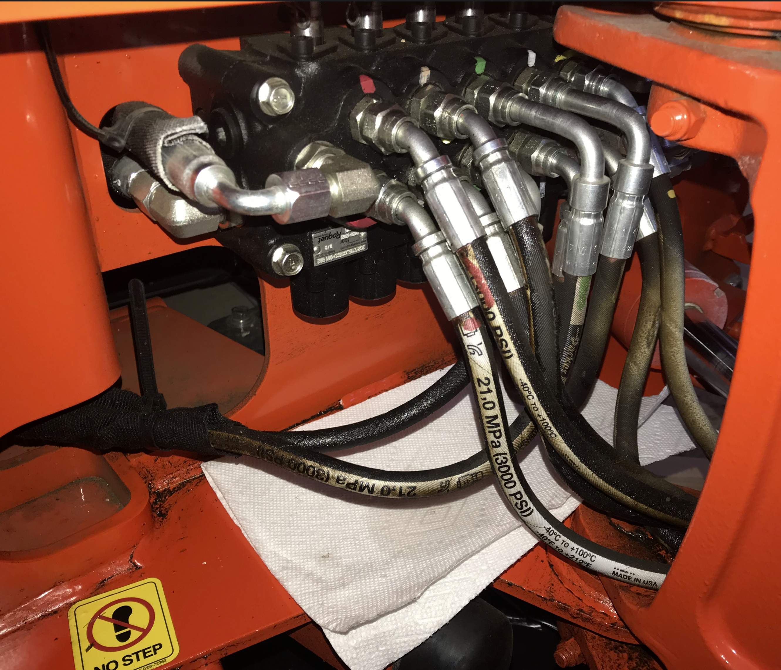

I have a new BX23S (a week old) and I found I had a leak coming from the backhoe (stain on my driveway! (need to look to see how to clean this up!)). Anyway, I tracked the leak to these connections pictured below. The problem is it is very very difficult to get my wrench in there to tighten them. Is there a special tool to tighten these or just go a little bit at a time with my regular wrench?

Ooh! Thanks. That is basically what I was imagining but had no idea what it would be called.
   / how to tighten BX23S backhoe hydraulic nuts #4
There are the open end ones, the pictured 12 point socket ones, and 6 point fitting ones (strongest but thickest).

Yes the tool is called the dealer who delivered it leaking.

Oh...yes, I missed the week old part.:eek: Yes, they should be jumping to fix that for you!
Yes, they did say they could send someone out to fix it but if its just tightening a nut I figured I could manage that (with new tools!). However, it has probably lost enough I need to replenish the hydraulic fluid so maybe better to let them come do all that. Thanks for help!
   / how to tighten BX23S backhoe hydraulic nuts #8
It's under warranty..I would have the dealer fix it if possible.. but if that is a pita.. I have taken a old Craftsman box end wrench..and ground out a slot that would slip over the hose and onto the fitting I needed to get tightened. ..worked great.
