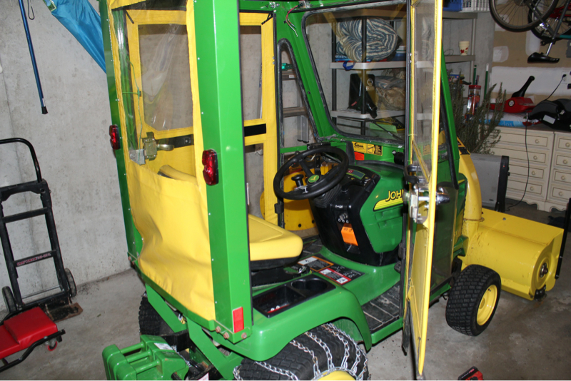

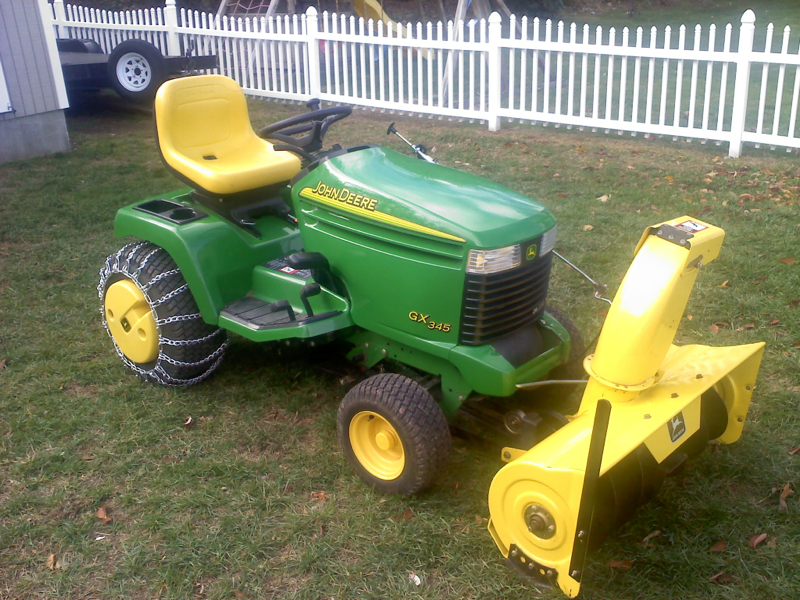

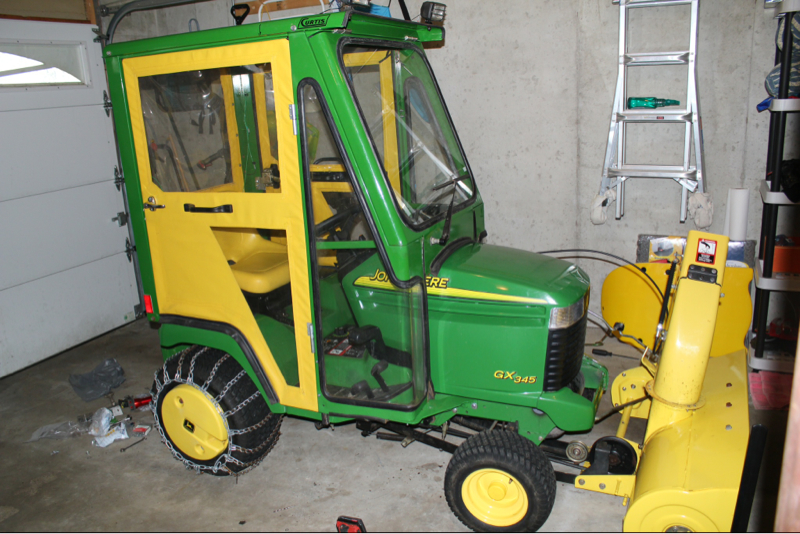

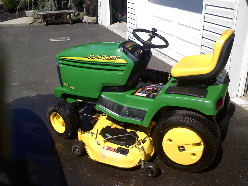

Oh I now have a very nice and well cared for GX345 with a 54" deck, 42" snowblower, Curtis cab, weights and chains, with only 280 REAL hours to sell. Any offers? Here are some pics.
Who knew tractors were so addicting. I own a Kubota B26, a JD GX345, and now an X595. Did I mention that I only own 1 acre of land? My wife thinks I may need help, she may be right.
I forgot to mention, the snowblower has electric Shute rotation and Shute deflection (did I say that right? You know what I mean) that I have not yet installed.
