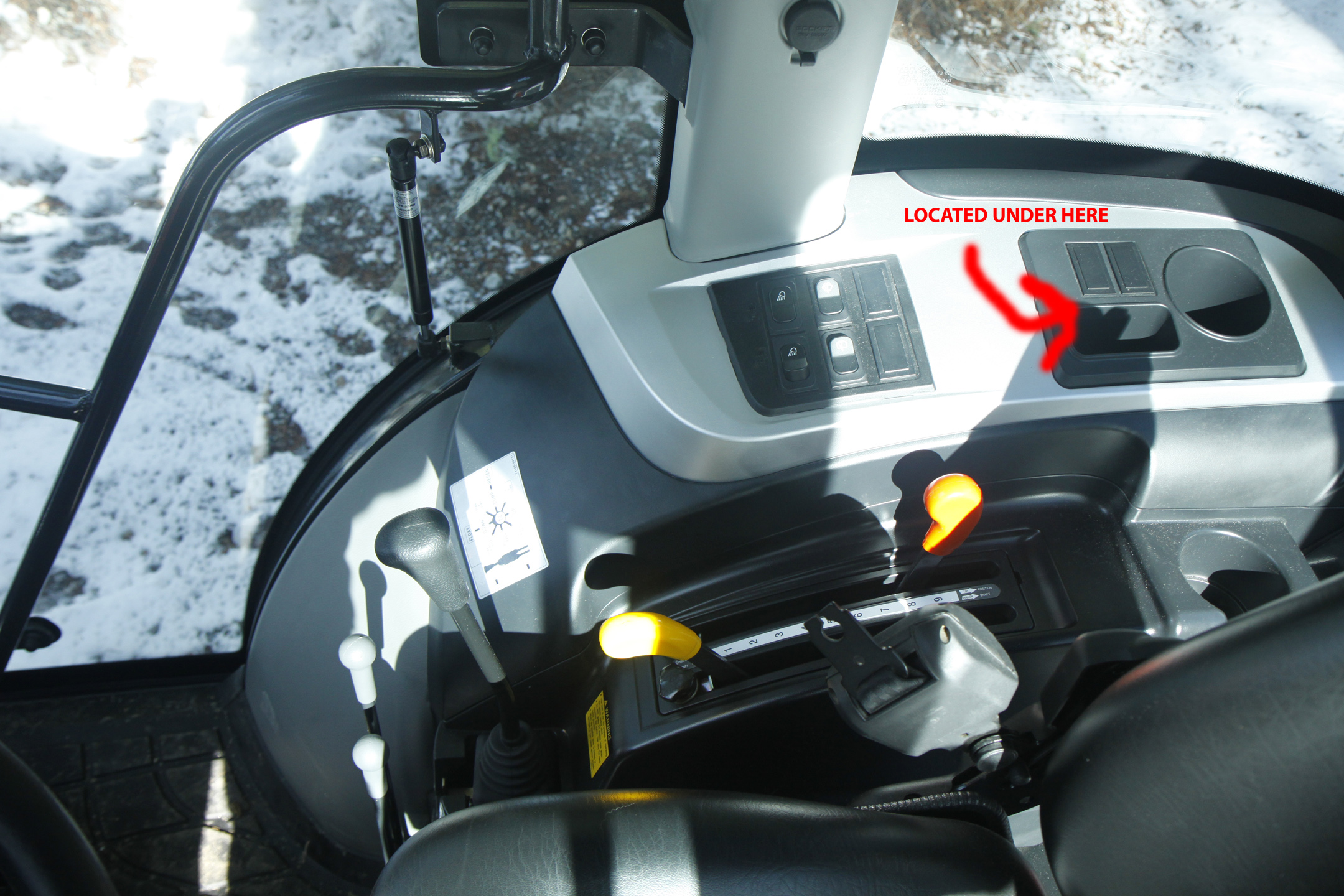

also, for those with the DK cab. theres an ipod jack located under the right cup holder. works great
