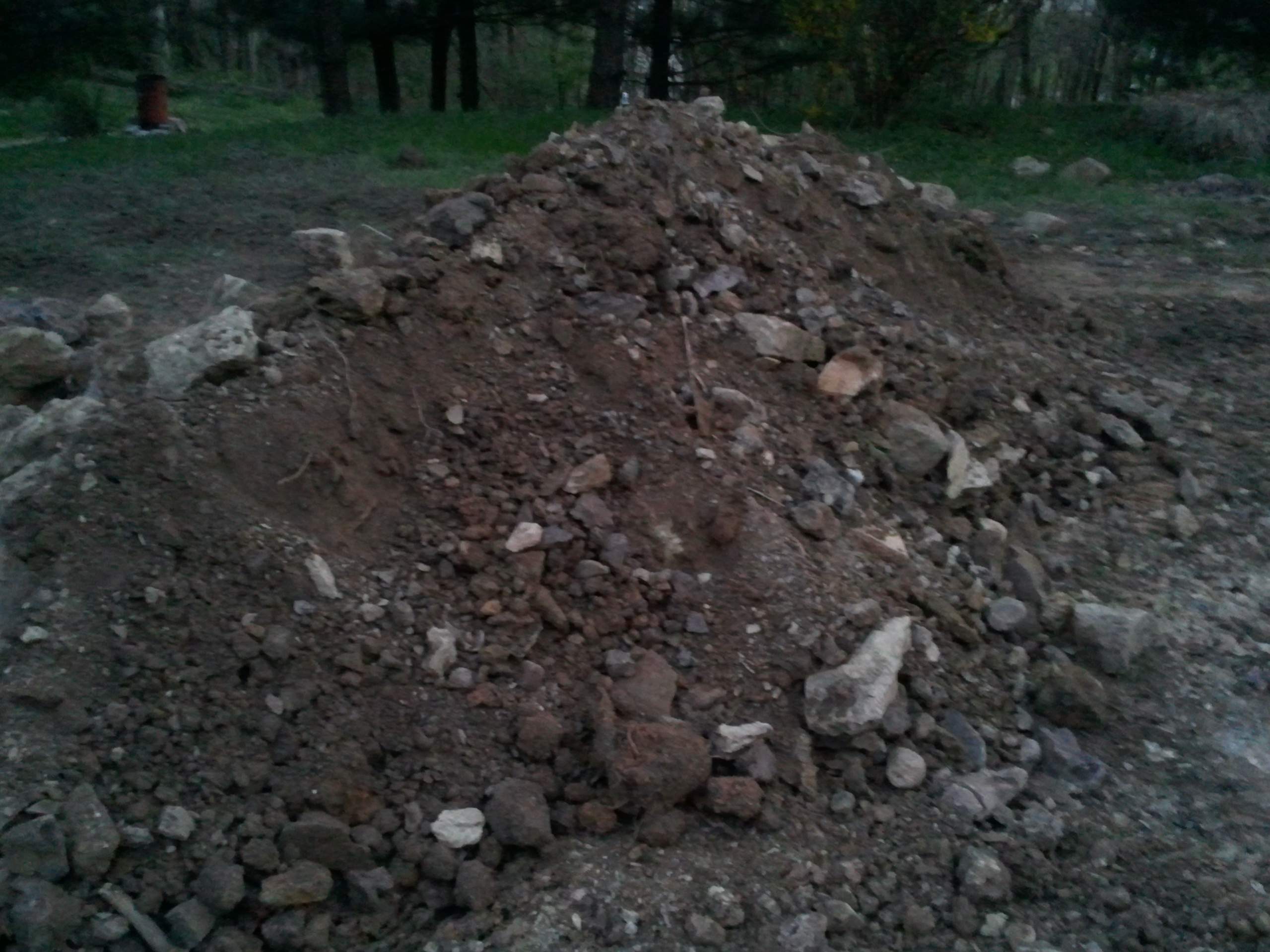

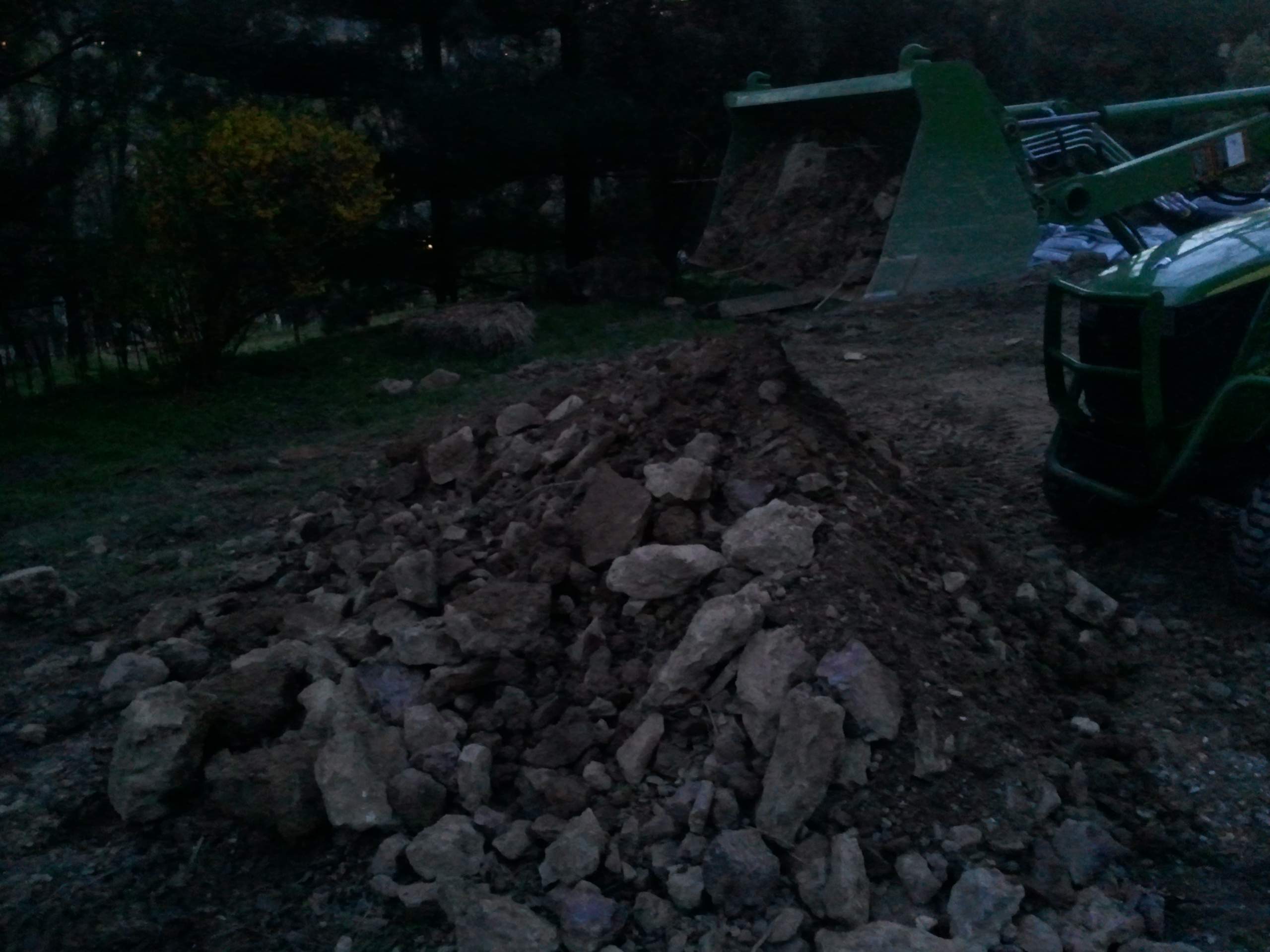

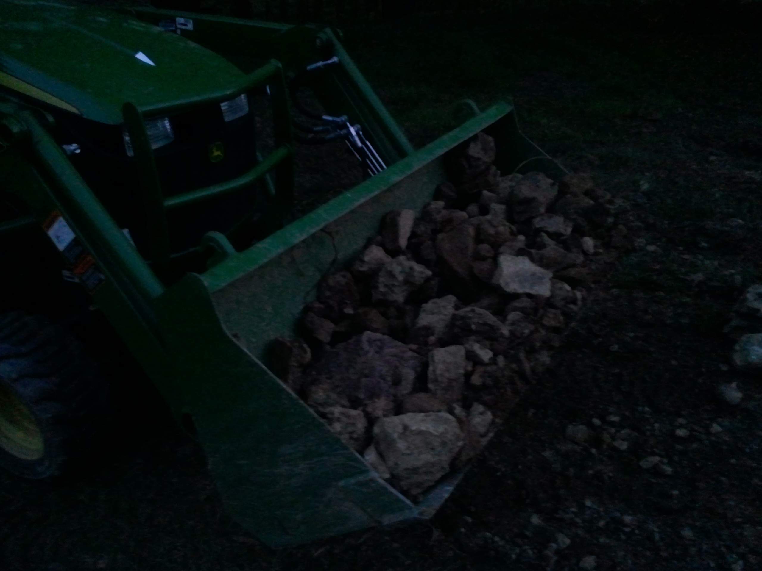

I have been doing a big job at my mom's house and so far I've moved 20 tons of fill dirt. The problem is that the fill is clay and shale. The smaller pieces of shale I can bust up by driving over them but the larger ones are difficult to deal with. I wanted to separate the dirt from the rocks without using any special equipment so I came up with this procedure. It works really well.
1. Start with the loader on one side of the pile and grab a bucket of rocks and dirt.
2. Bring the loader cutting edge to the top of the pile. Hold it about 6" above the pile and shake the bucket gently. The large rocks will roll down the pile and the small rocks / dirt will stay on the top.
3. Repeat the procedure until you have cut out about half of the pile.
4. Move the rocks out of the way from the other side using the pile as a back stop to get them in the bucket.
5. Do the same procedure on the other side of the pile.
6. Enjoy your rock free fill dirt!
