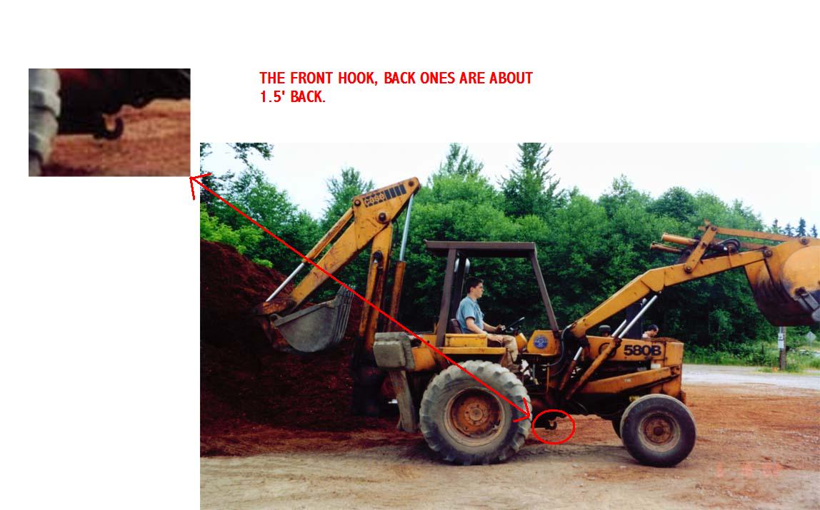

With smaller backhoes like Kubota, it's not too much of a problem when dealing with the hoe, as far as putting it down. You can leave it up or put it down, but each machine is different and you may have more side-to-side motion in the hoe. When you transport large backhoes like case, you SHOULD put the hoe down, because many people have ripped the hoe right off when going under a bridge or something. On our case backhoes, there are 4 hooks, two in front near the tires, and two in the back near the tires. That's where we tie down our machines. The hoe stays still when lowered. I don't know how the bottom of a kubota looks. I posted a pic. of my backhoe and where the hook is.
