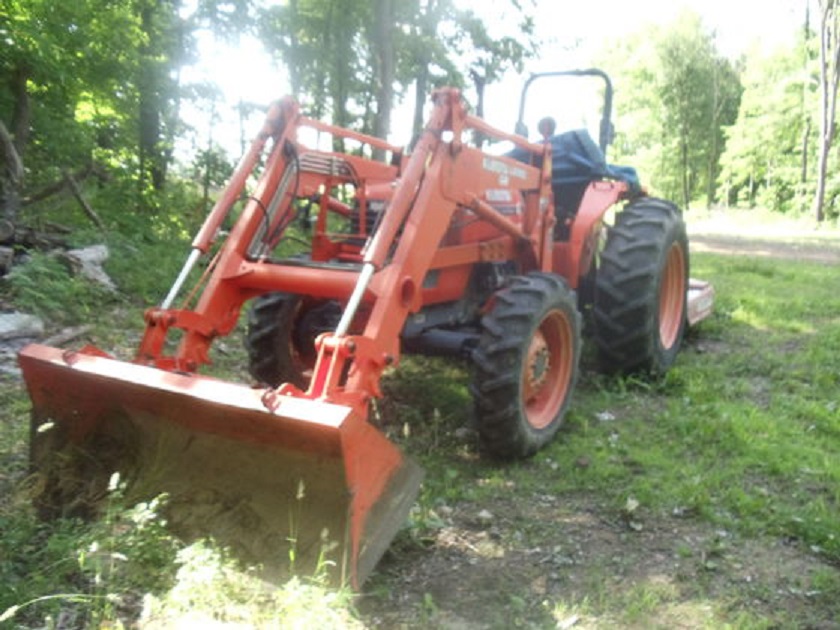

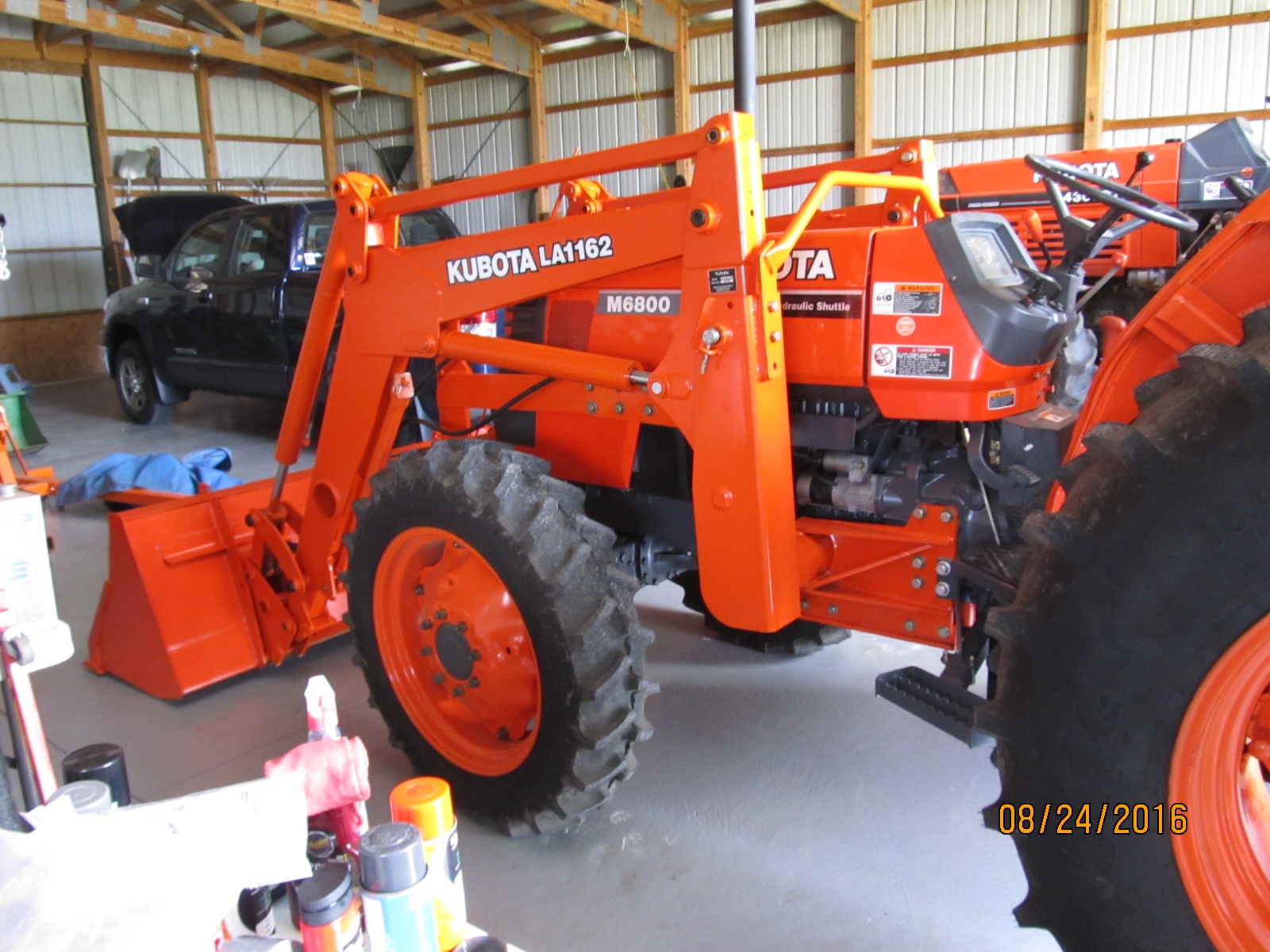

Below is a photo of an M6800 Kubota I recently bought an auction. It sat outside for 14 years (!)--ugh--but only had 400 hours on it. It had a big plus of hydraulic shuttle shift, draft control, adjustable link ends, deluxe seat, loader and rear weights. Most important, it was owned by a meticulous 95 year old guy that changed the fluids and maintained it while only mowing grass with it. Best of all, he drilled no holes, added no whip aerials or fog horns or crap that would be hard to repair. Plus, he had the insight to at least tarp the seat. This is my kind of raw material and I bought it. I've wanted an M6800 for years.
Here it is. Pretty sad and some buyers were scared off by it's apparent condition. I did my research first.

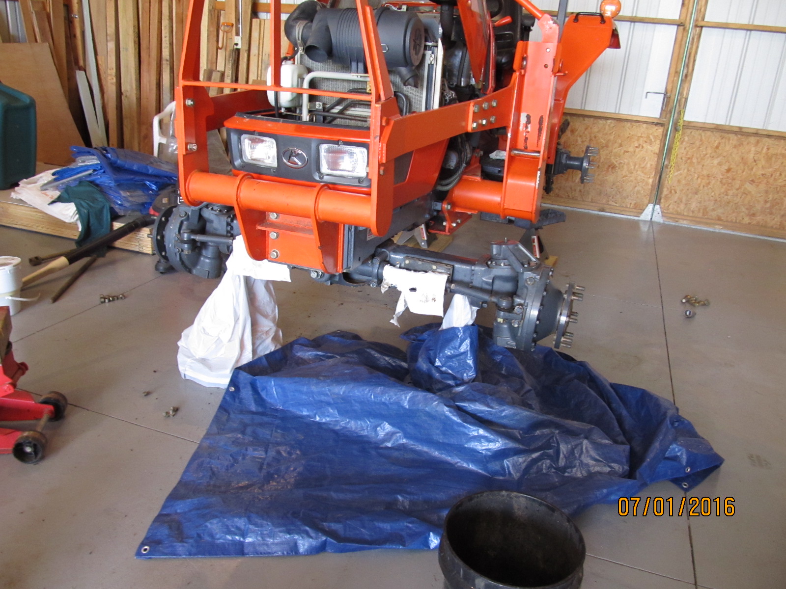

After getting it home, I assessed things and decided the tires were nice enough that I could buy new tires and swap the old ones for a partial credit to the tire shop. This works great for me and the net cost is then bearable plus I upgrade to a better tire. First I pressure washed and scrubbed everything squeaky clean. It actually shined up a lot. Then I took off the loader, blocked up the tractor in the barn, took the tires off and anything else that looked shaky. Oh, the rear tires were loaded so you can imagine that effort. The wife "helped".

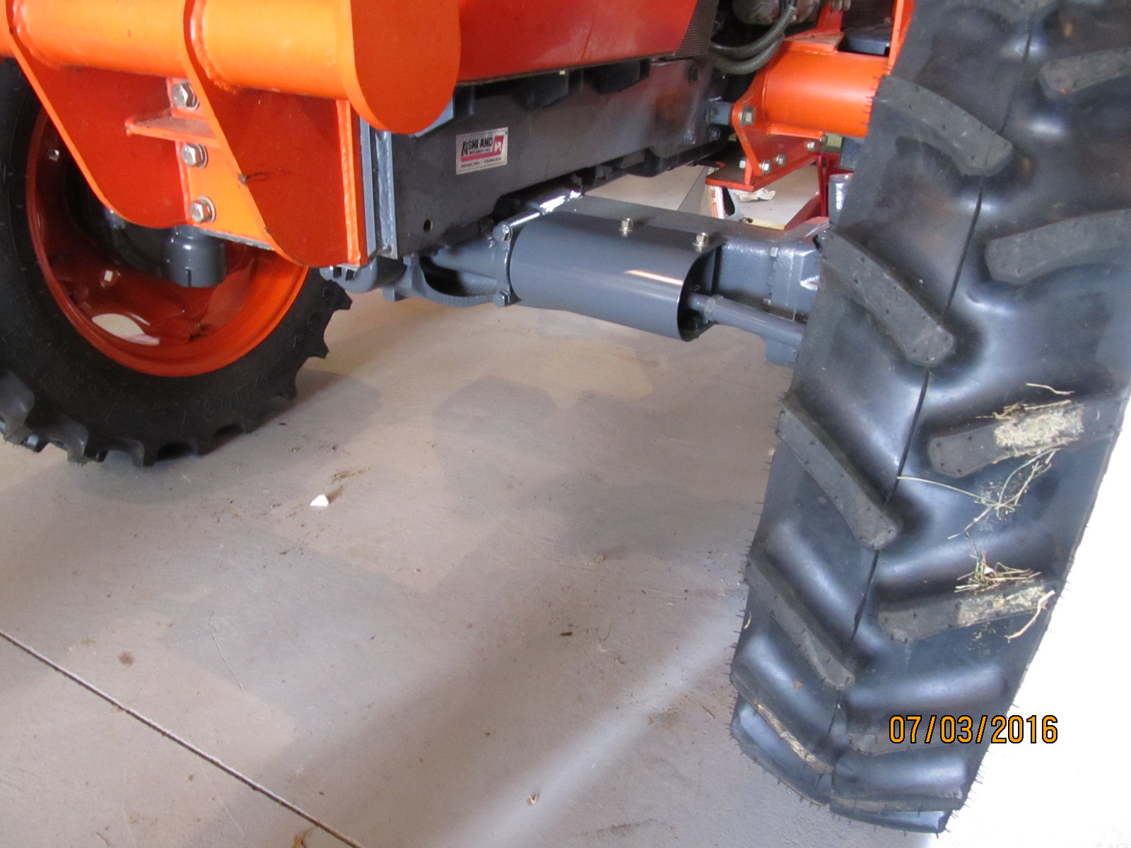

I wire brushed a little and Windex/paper toweled the smooth surfaces of the front axle and removed any bolts or parts that were plated or needed more attention. Just detailing. Then I rattle can sprayed (OEM ONLY) the front axle and related parts and put it back together. It doesn't have to be perfect but NO OVERSPRAY EVER!

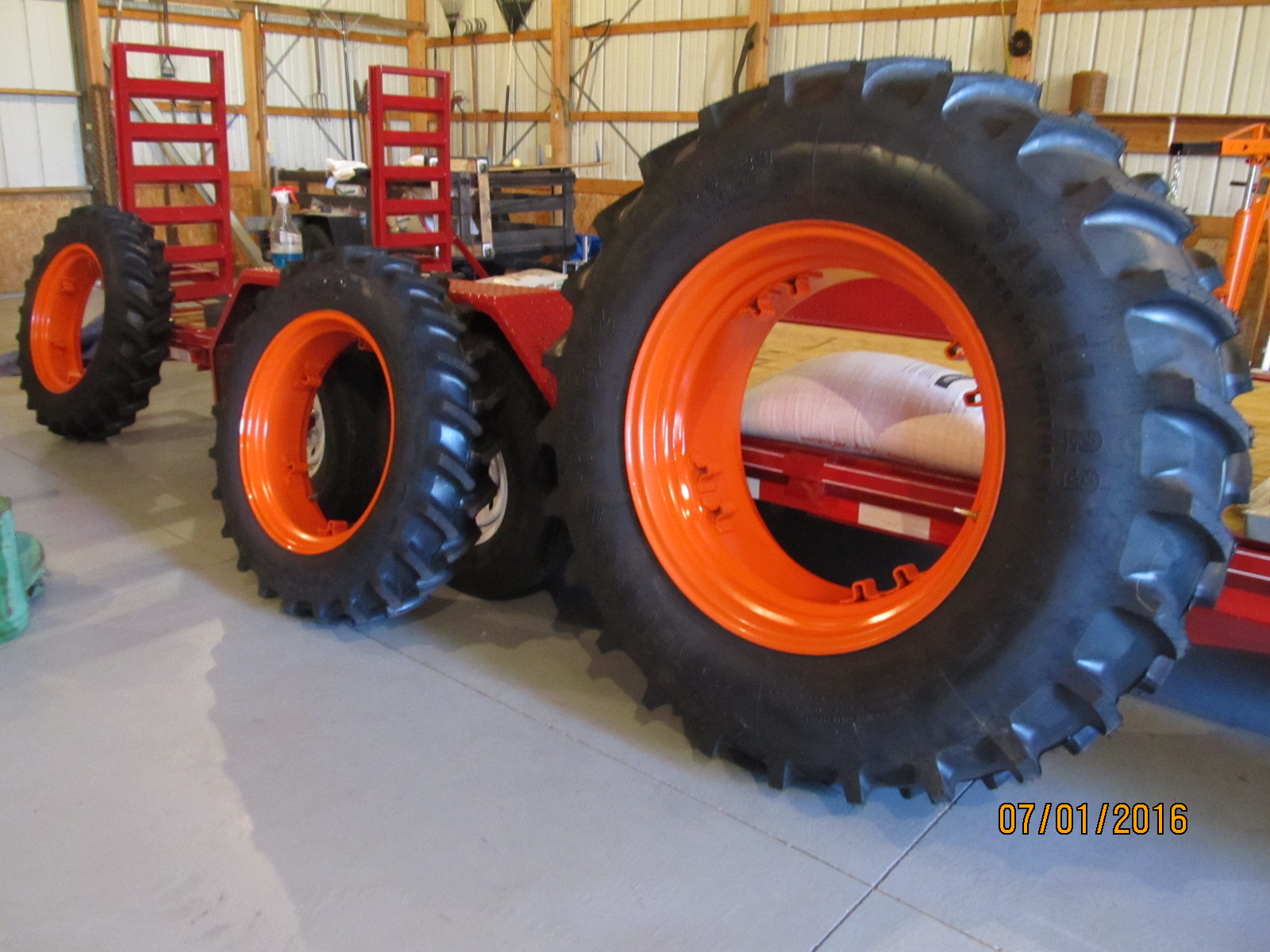

I ordered a set of Firestone SAT II 23 degree long bar/long bar tires because they are durable, quality and work great in dirt. Plus they look nice. I had the shop dismantle the tires so I could separate the wheels from the centers and paint things correctly (OEM ONLY). No paint on the bolts, because that would look obvious, I just sprayed those with oil. Most anything not painted gets sprayed with oil to stop rust and create a patina as things age. My stuff stays out of the weather.

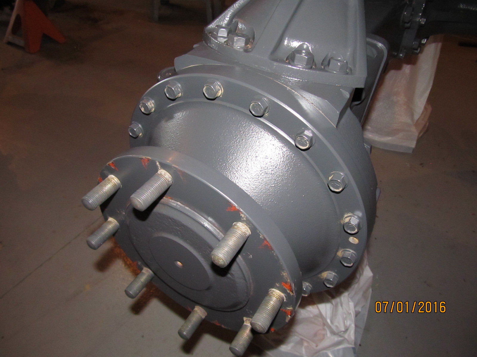

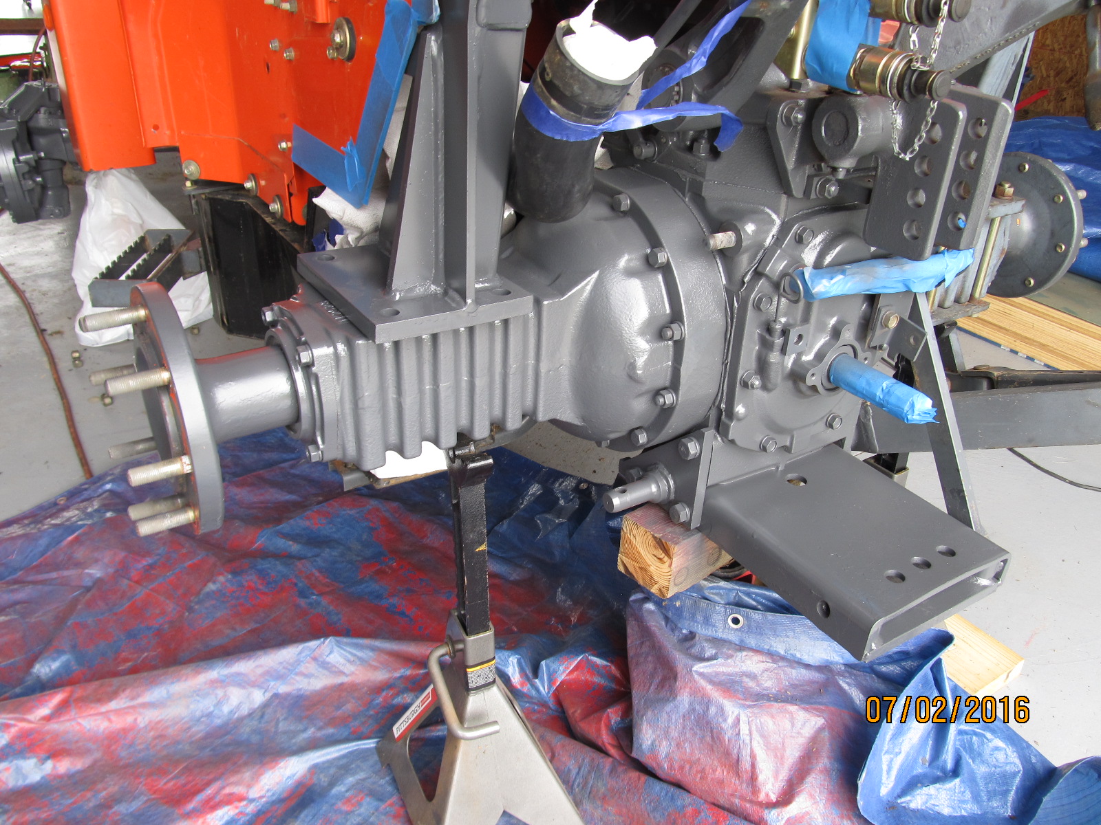

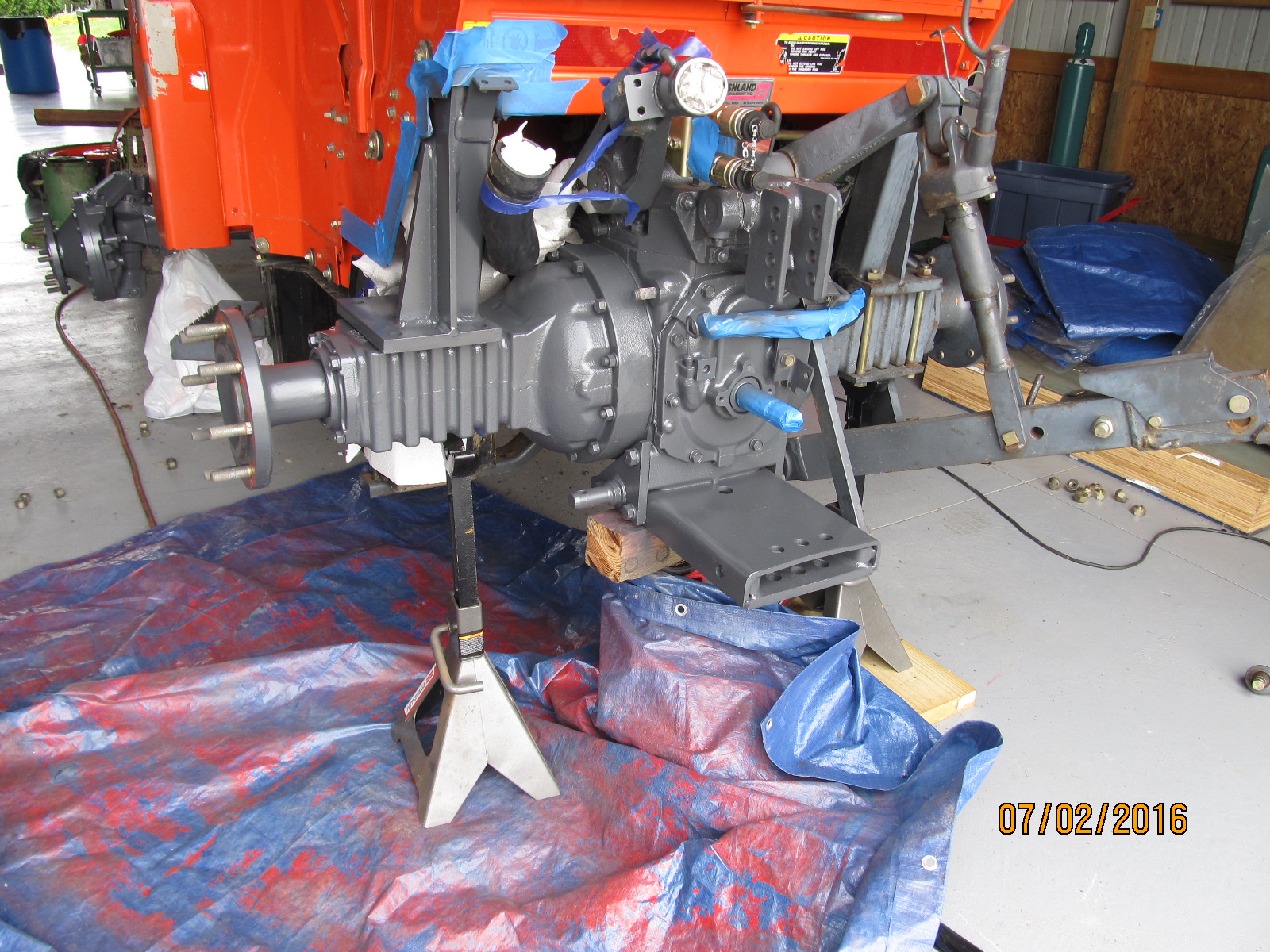

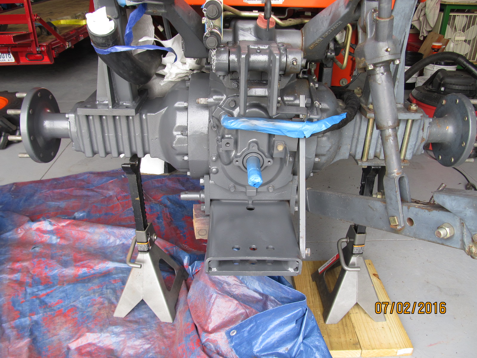

Then on to the back axle. I disassembled many parts and rattle can (OEM ONLY) sprayed them separately--just like the factory. ZERO overspray is allowed and detail must be perfect. Mask with blue painter's tape. No bolts were sprayed unless they came that way from the factory. The other bolts might have had the threads chased and then sprayed with oil from a can with a straw tip. Works great with the straw.
Then I started to assemble the basics. It may look nice from 20' but it's not.

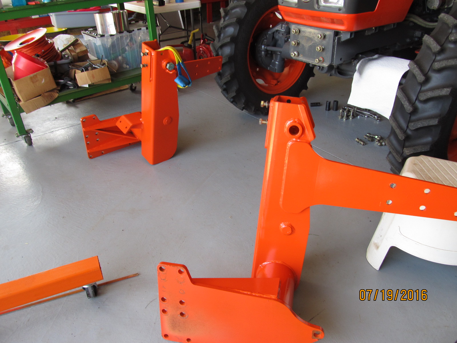

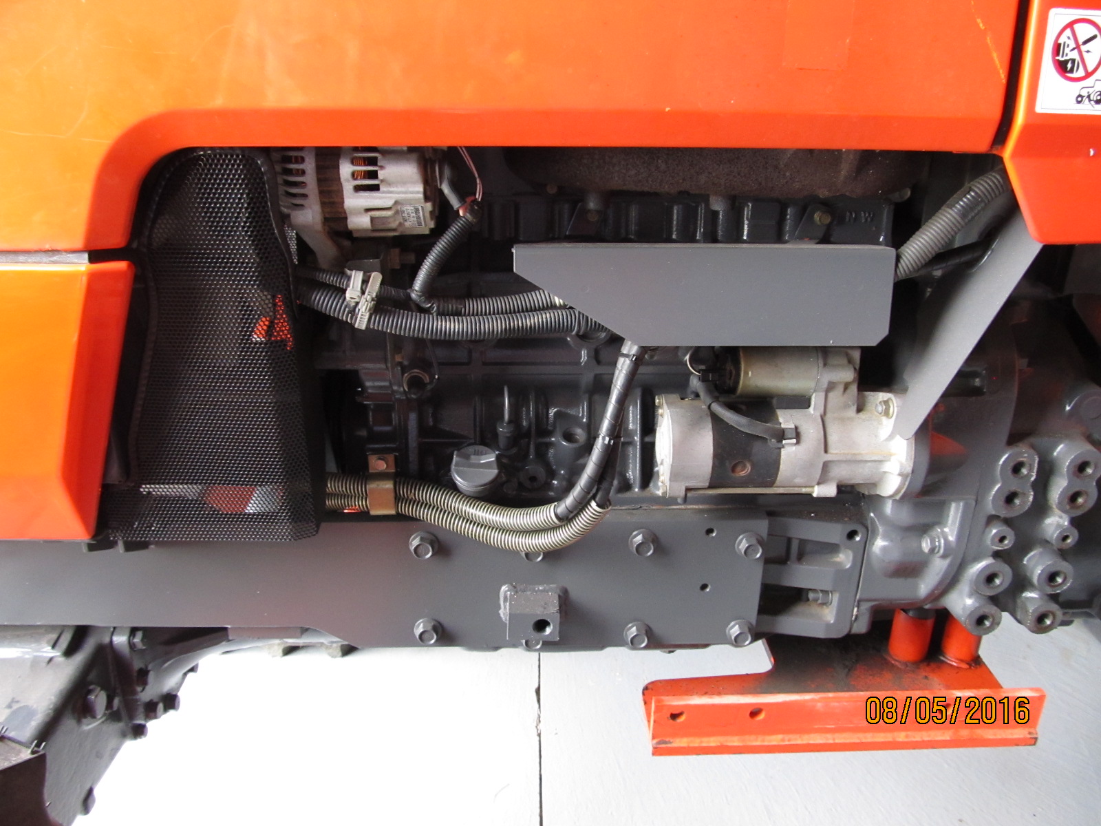

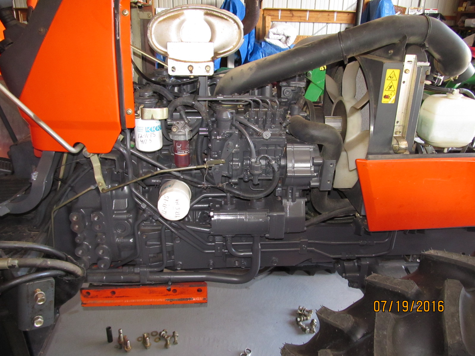

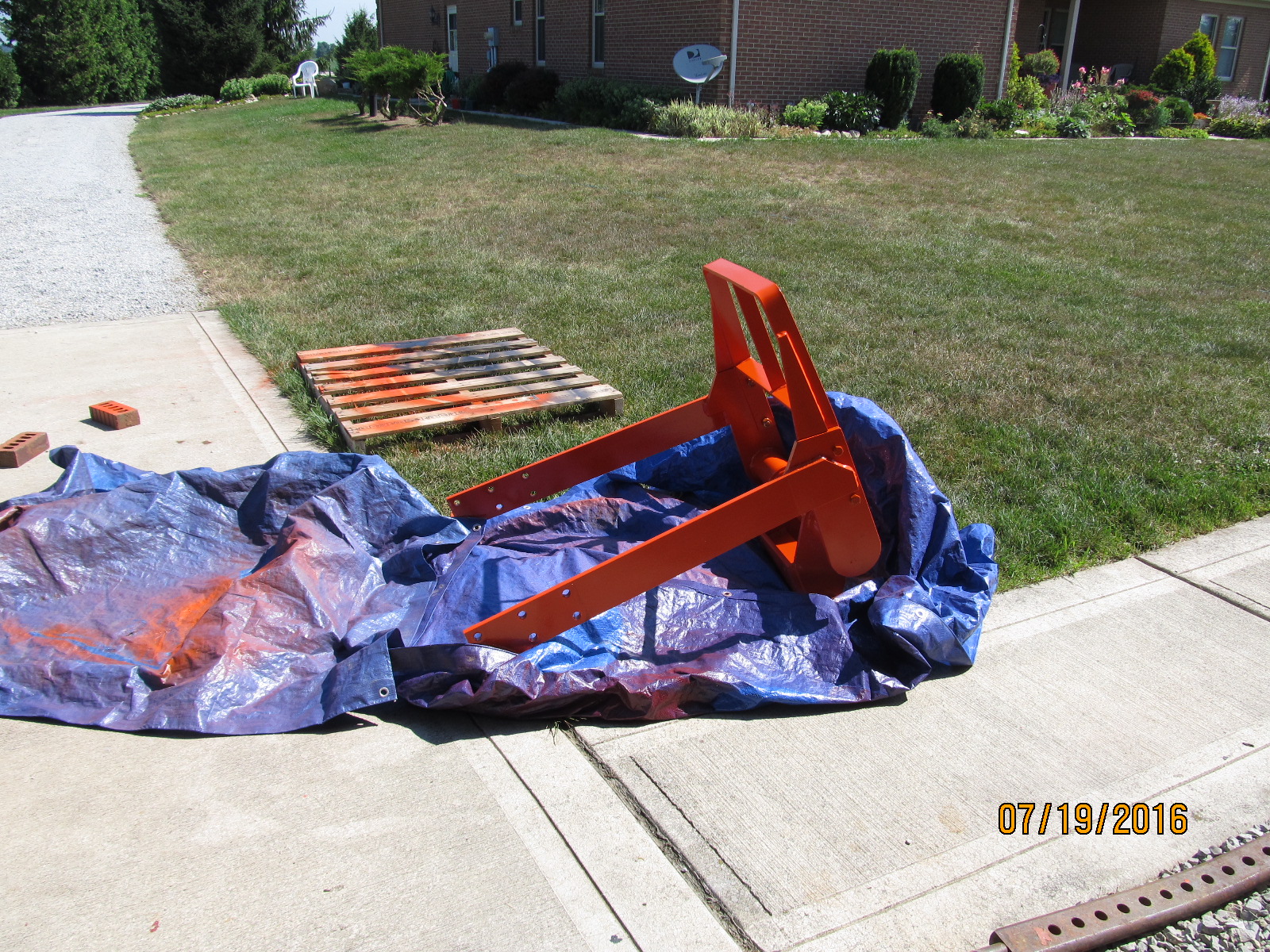

Next I removed the loader frame brackets with my Harbor Freight rolling shop crane/engine hoist earlier and spray painted (OEM ONLY) outside on my Harbor Freight free tarp with the higher quality Harbor Freight HVLP spray gun. Then it was on to detailing the engine. You know the drill. Piece of cake. Bolts, unless factory painted got sprayed with oil.
I'll change the fluids later.

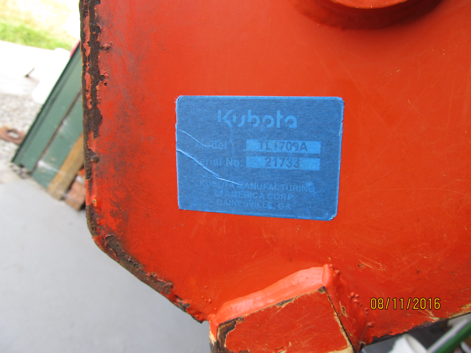

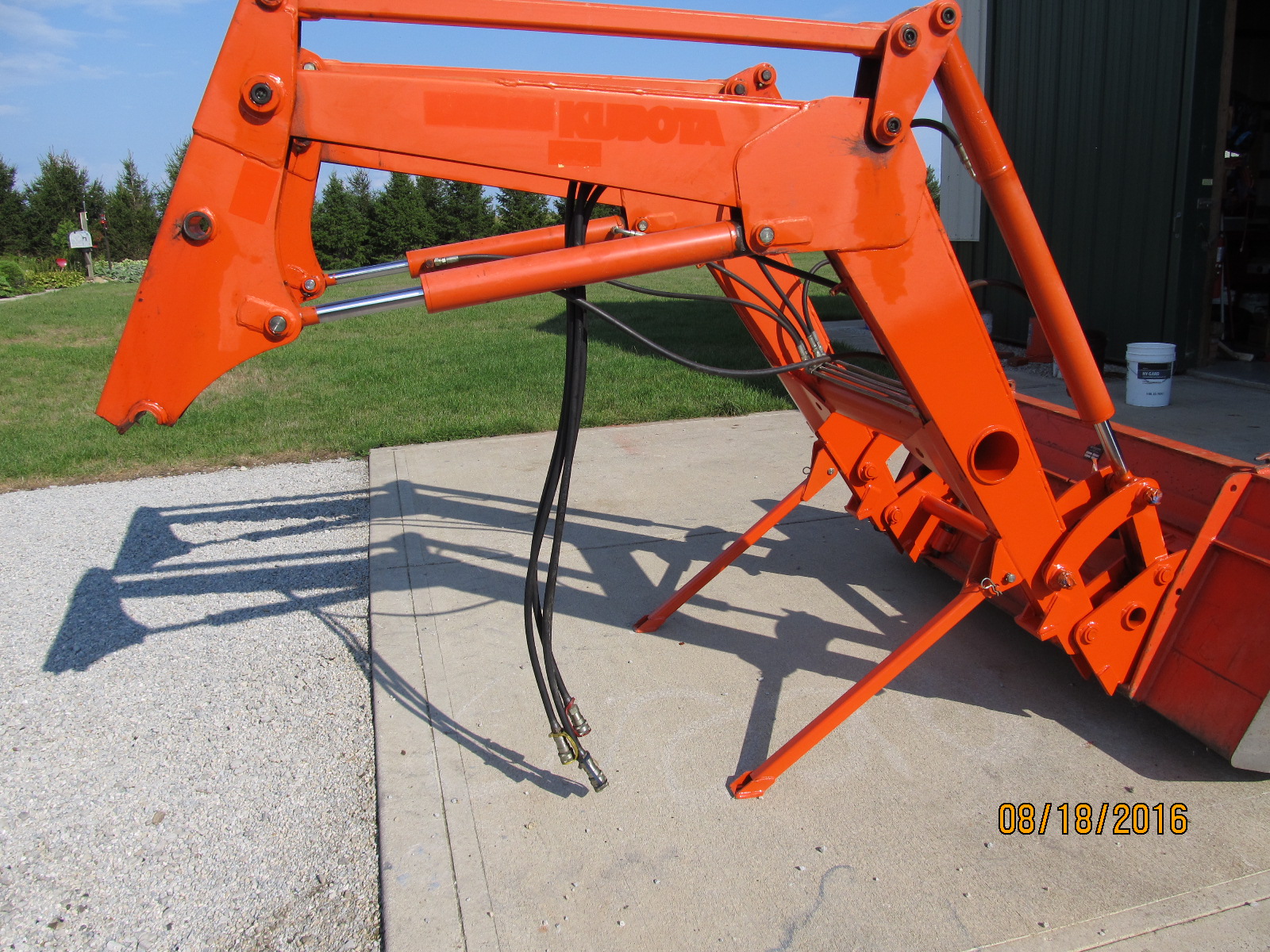

Also, I pulled all the loader pins out, cleaned the holes and wiped the pins clean and new grease. One was nasty--did thread on it--so replaced it. Others looked like new.

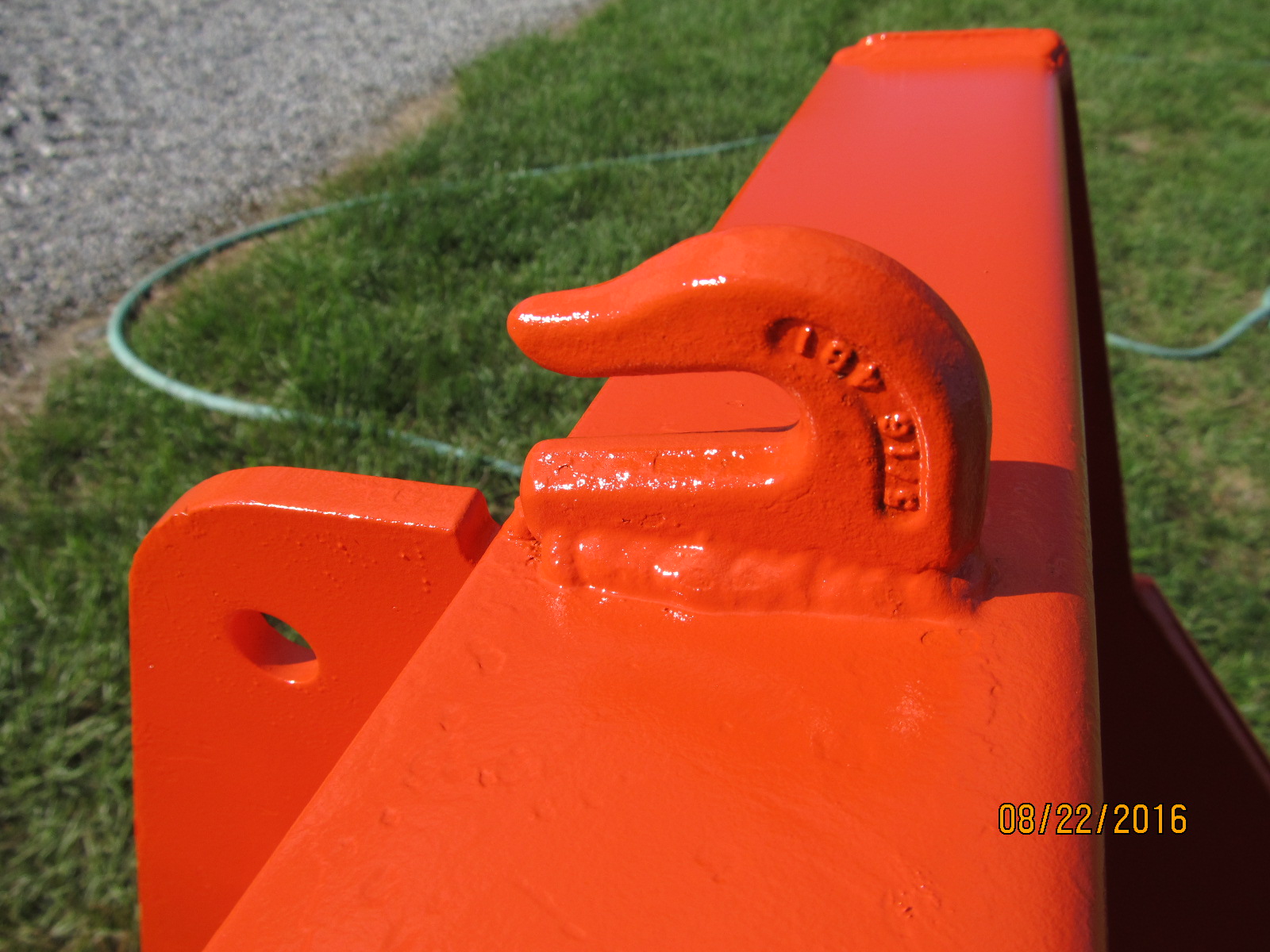

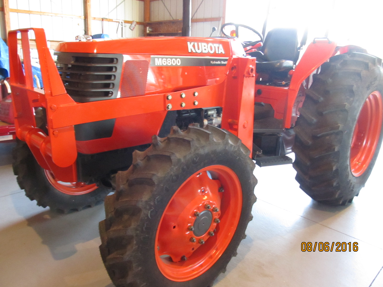

Next I used a strong cleaner on the paint and then cleared/waxed it again. I used plastic restorer on the grill and got a new grill emblem that was difficult to get to stay stuck. No sheet metal was painted because it would look painted and I would never get the new decals factory perfect. All other decals were replaced if needed. The steps and related parts were removed and painted but not the bolts because they came plated. Oil spray on them.

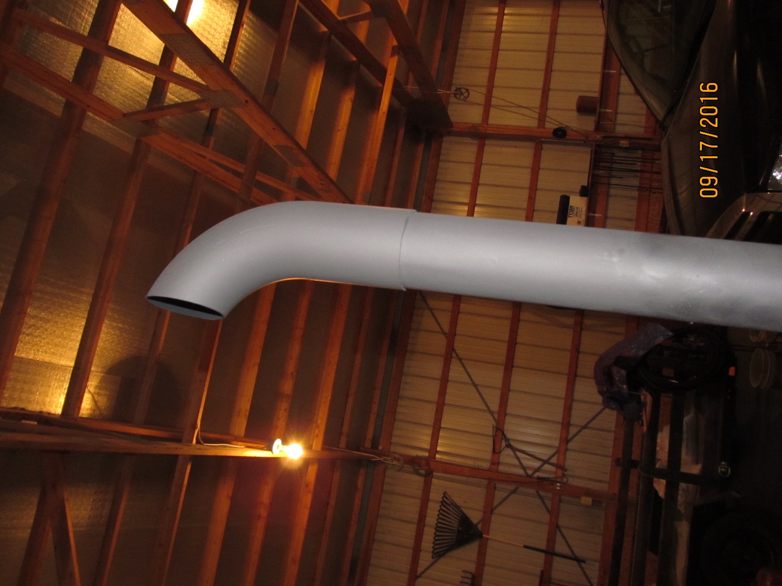

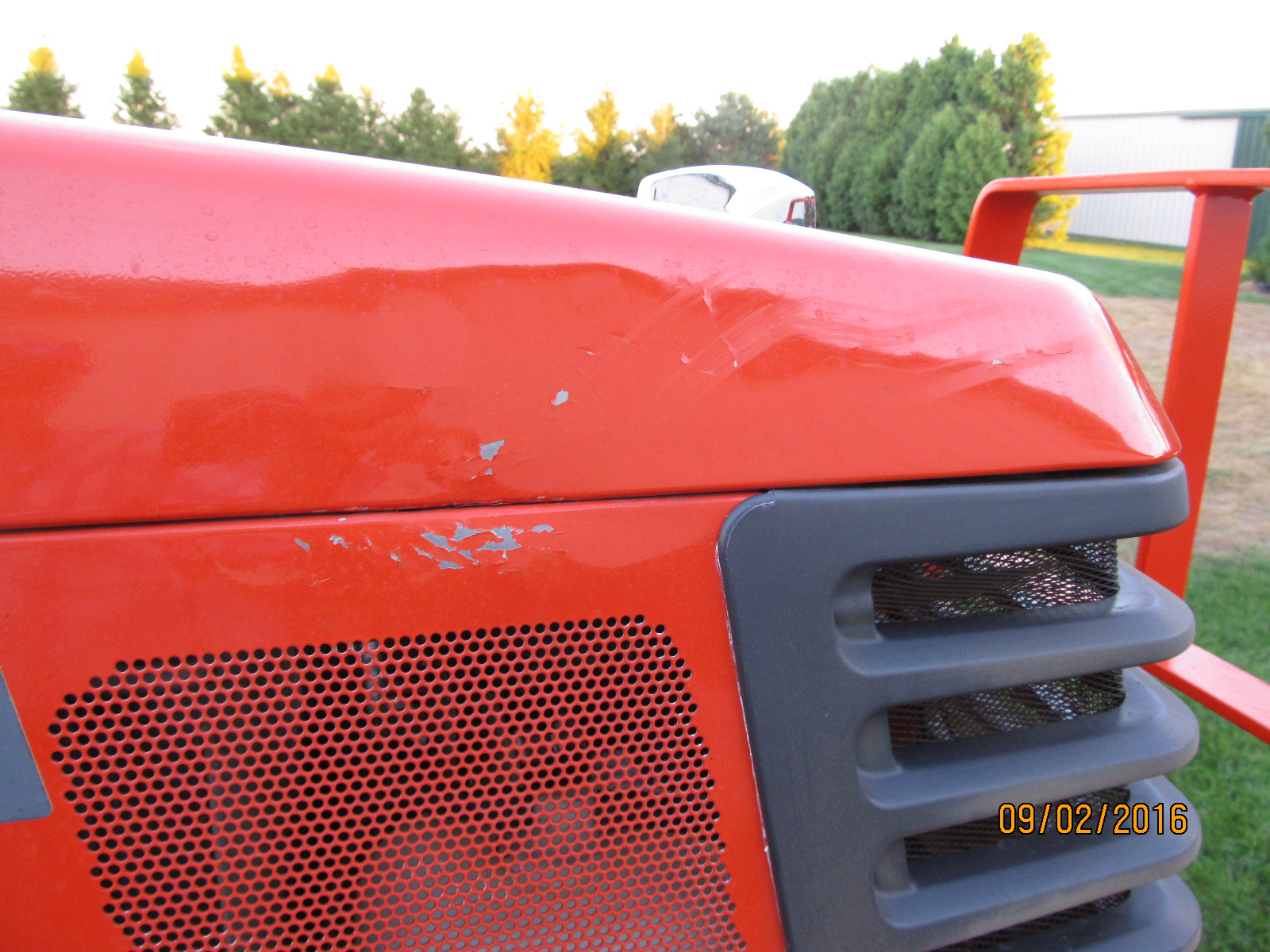

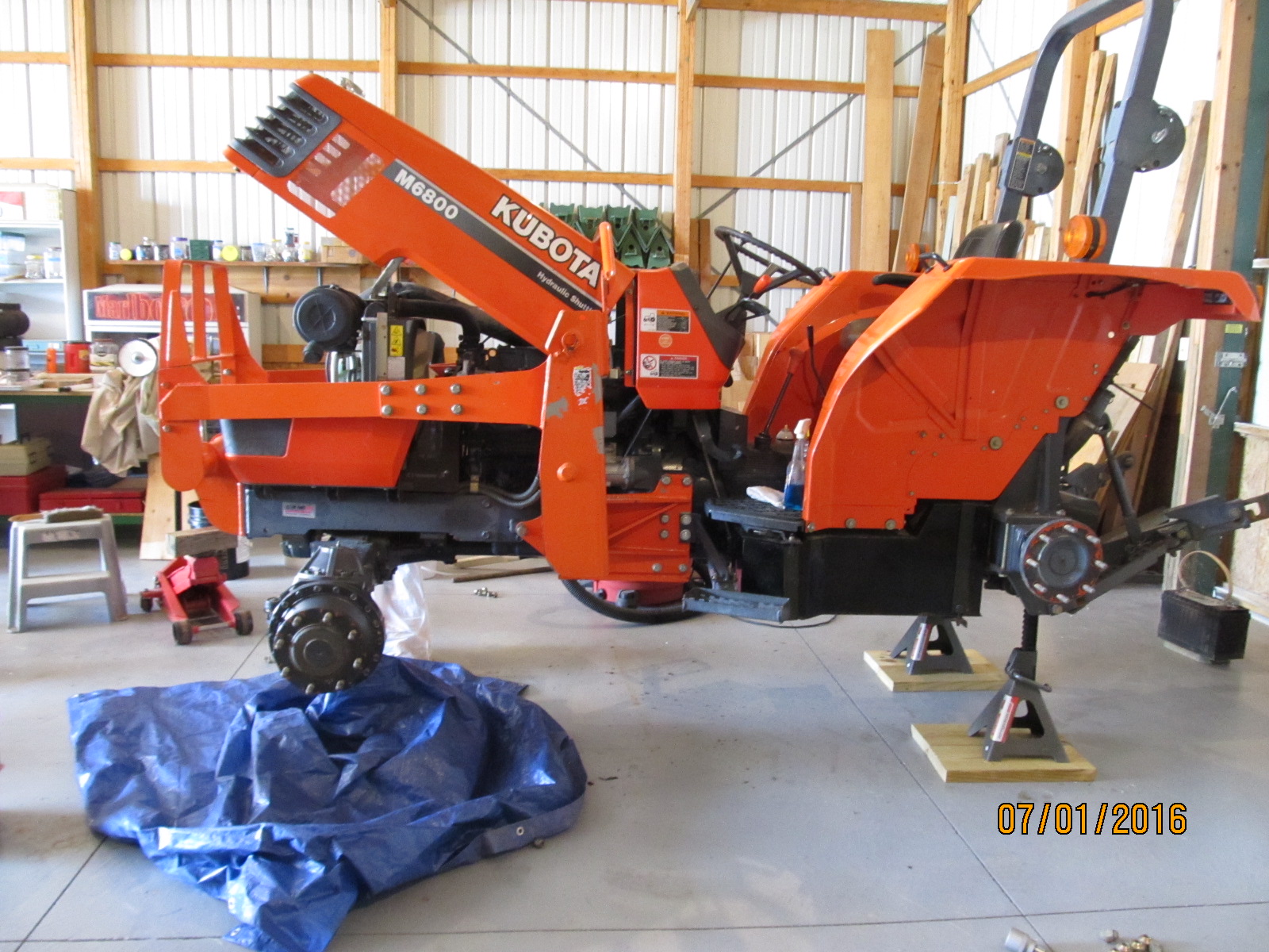

The fellow cut the exhaust stack to put on a rain flapper (thankfully) so I had to deal with that. To do that plus replace some missing heat insulation under the hood, I had to remove it and that took three people because it was awkward. I washed the back of the instrument panel and waxed floor panels and painted only the visible edges under the mats. Detail, detail, detail. Underneath, I sprayed oil on anything that looked like rust. The hood had a dent on one side that I just pounded out. A professional repair would be obvious and wrong. Hey; tractors get dents.

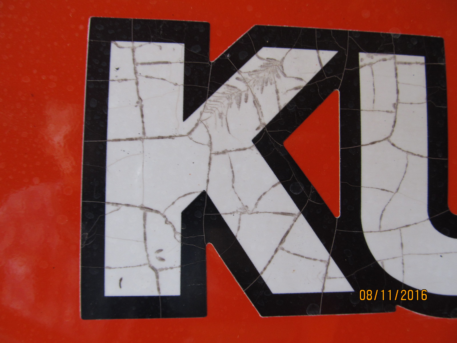

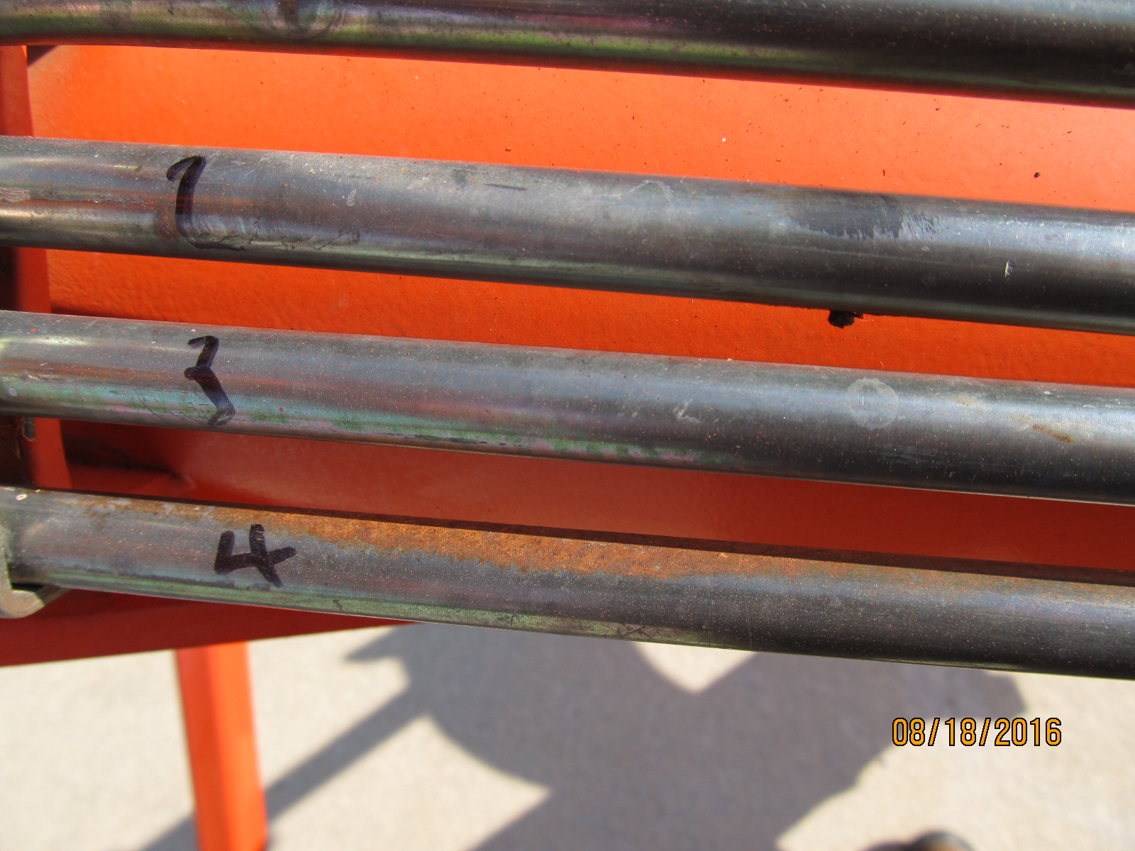

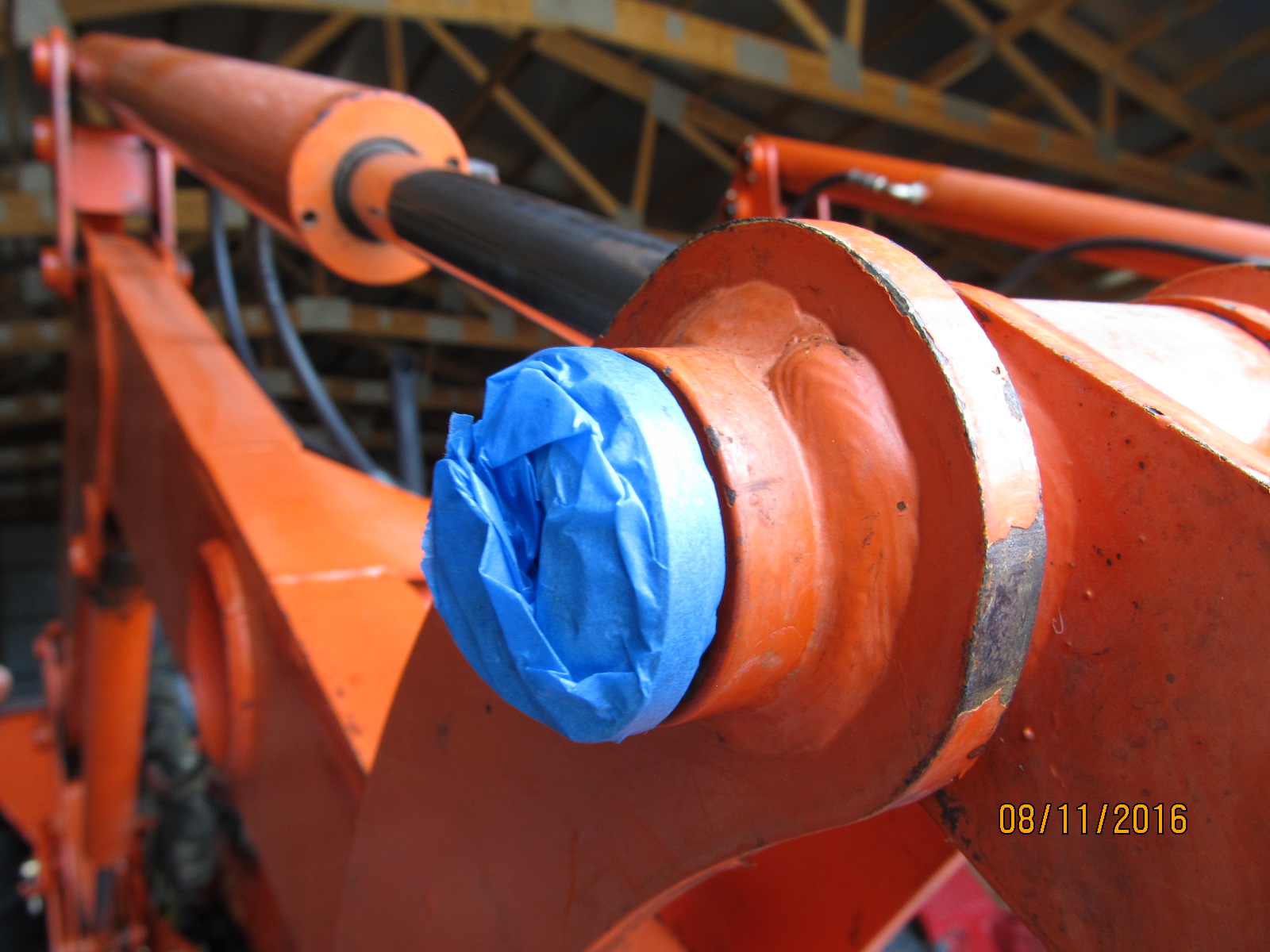

Then I started taping loader points, took pictures of where decals went and taped the ones that stayed. Detail.

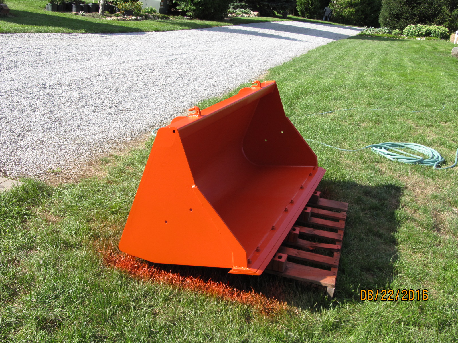

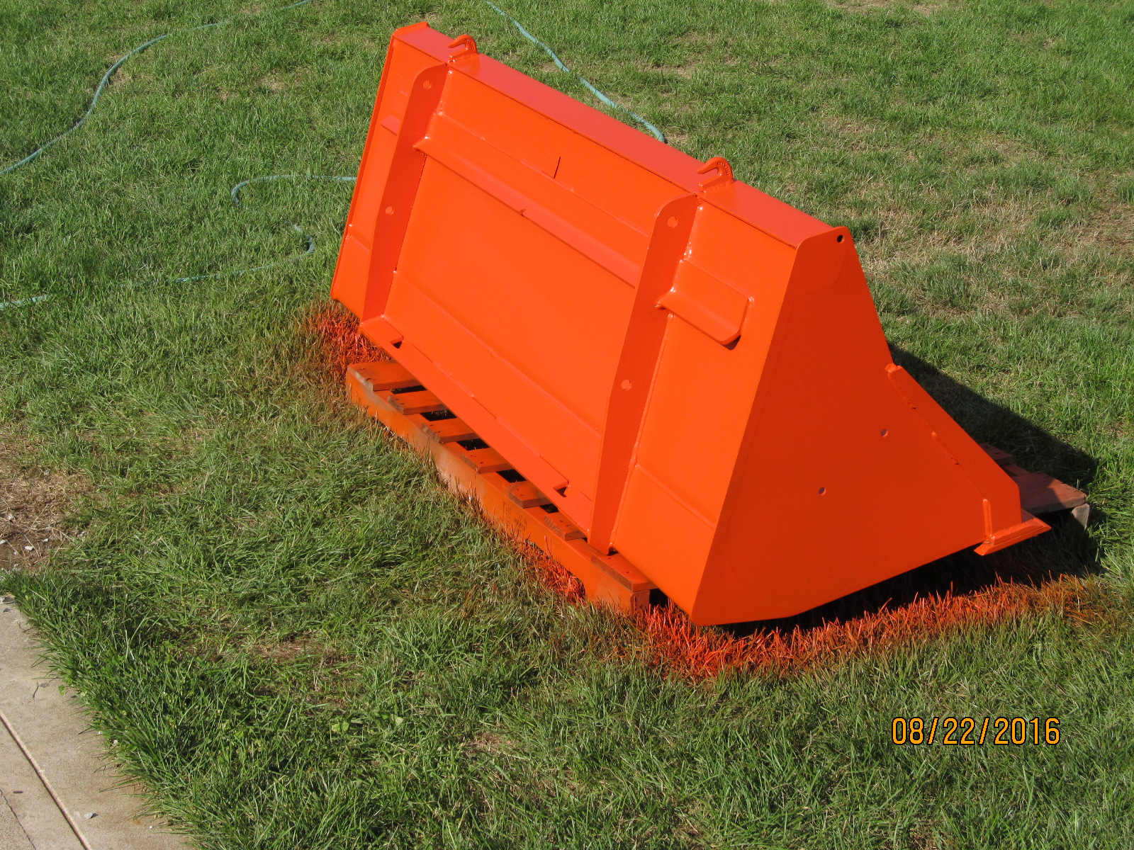

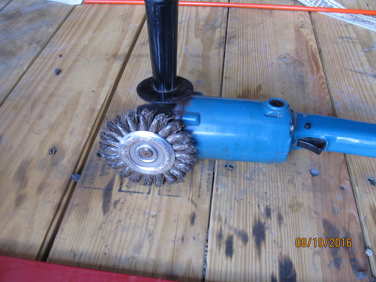

Then I wire wheeled the decals off and any or most rusty stuff and sort of taped it. I don't want an auto quality finish because it never had an auto quality finish. Next was the bucket.
The hard part was handling the bucket without scratching it. I decided to not paint the bottom because I ran short of paint plus how many bucket bottoms with 400 hours have paint on them after 14 years? Not this one.

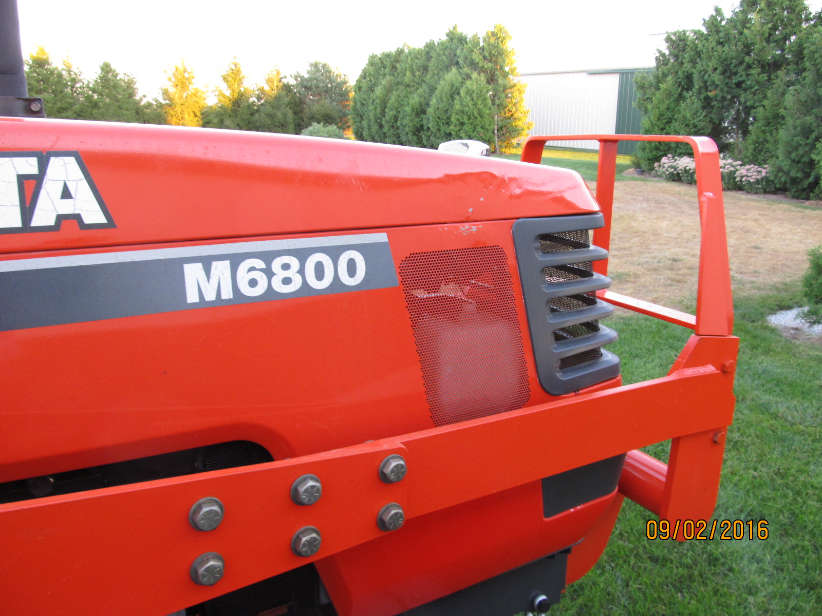

Here's the dent I pounded out. It's not perfect and I didn't want it to be. It looks honest because it is. No painting of the sheet metal.
Looking better. Where's that dent now? Still there but eye is drawn elsewhere.

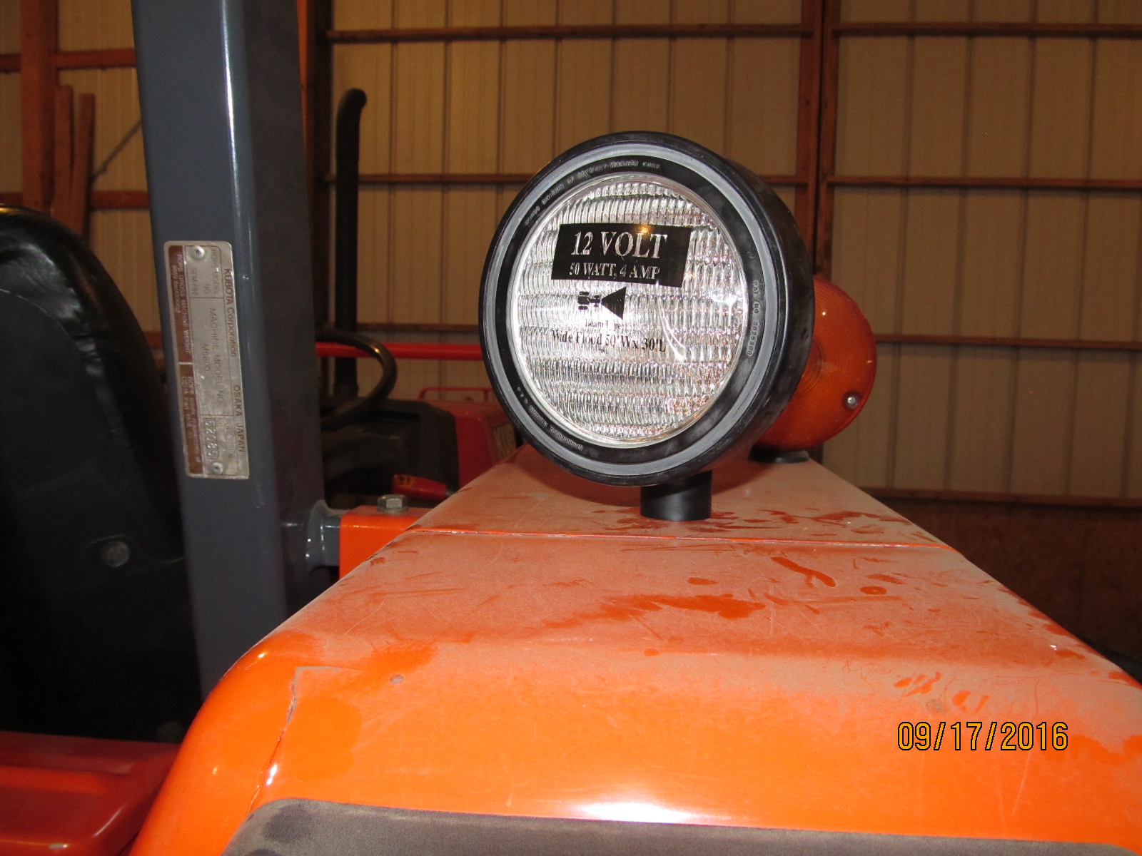

Added a work light because I had it. Bought years ago and never used.

Here's that fixed exhaust stack. Excuse TBN-induced sideways pic. I wanted an OEM stack but wanted my $200 :)eek:)more so I discovered that a piece of hot rod mandrel bend exhaust tubing was a tight slip fit. Can't tell even if up close unless you know.
