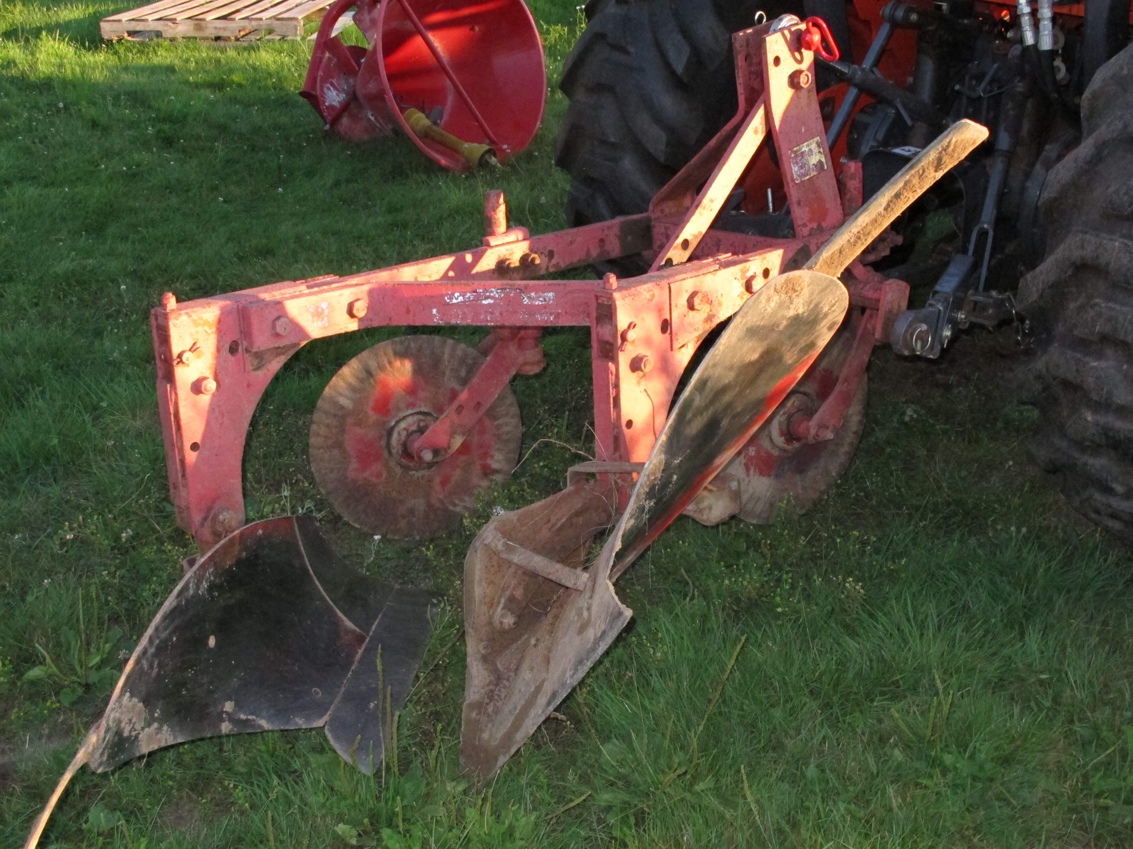

Does anyone know how to reset this old 3-point 2-bottom plow? Or what type of mechanism this is?
The paint is red, and the only legible label on it says "Adjustable Plow Bottom."

That appears to be an OLD International Harvester plow (late 50's as I recall). If I remember correctly that one was supposed to be reset by gravity when it was raised out of the ground. The reset mechanism in that one is probably rusty so it may take some work to get it to reset the way it should. Even when they were new they usually had to be reset by putting a bit of weight on it and backing up until the bottom flipped back into place.

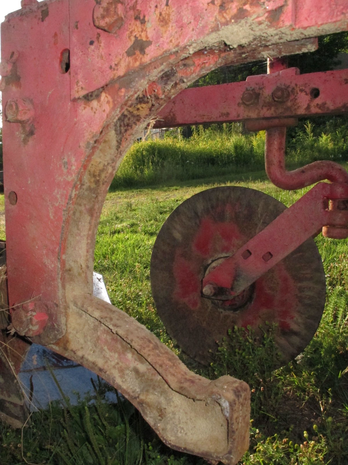

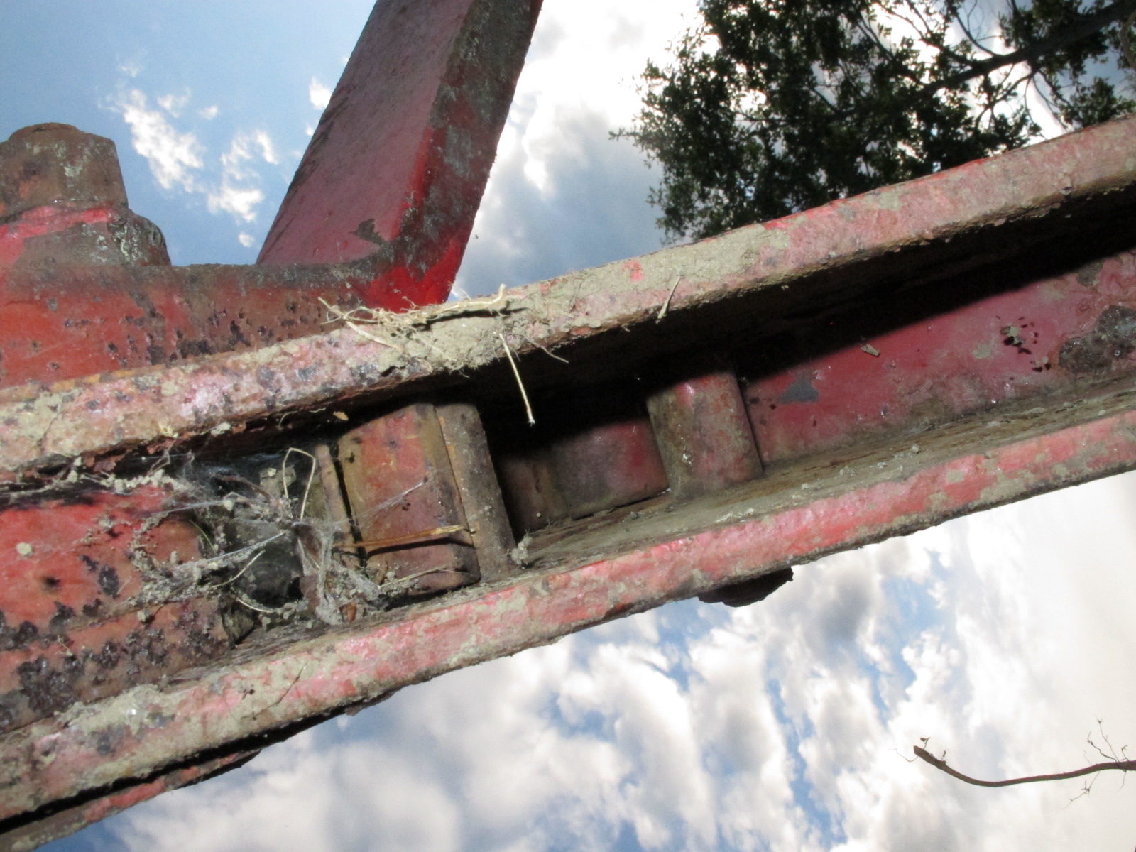

Anyway, here are a couple of pictures of the mechanism on the tripped side. Which is the shear bolt (if there is one)?
/ How to reset old bottom plow #6
You have a trip plow. There is no shear bolt.
I recently cleaned out the trip mech on my Ford Series 101 plow. Here is the thread with photos: http://www.tractorbynet.com/forums/...p-mechanism-ford-series-101-a.html?highlight=
After years of sitting in the rain and collecting dust when in use, greasing now is unlikely to do any good. You need to take trip mech apart and use a nylon or wire brush to clean, soak with PB Blaster spray solvent, then grease.
Plow trip mechanisms are all similar. Cleaning both mechs is a 90 minute job for an experienced mechanic. Allow three hours doing it yourself.

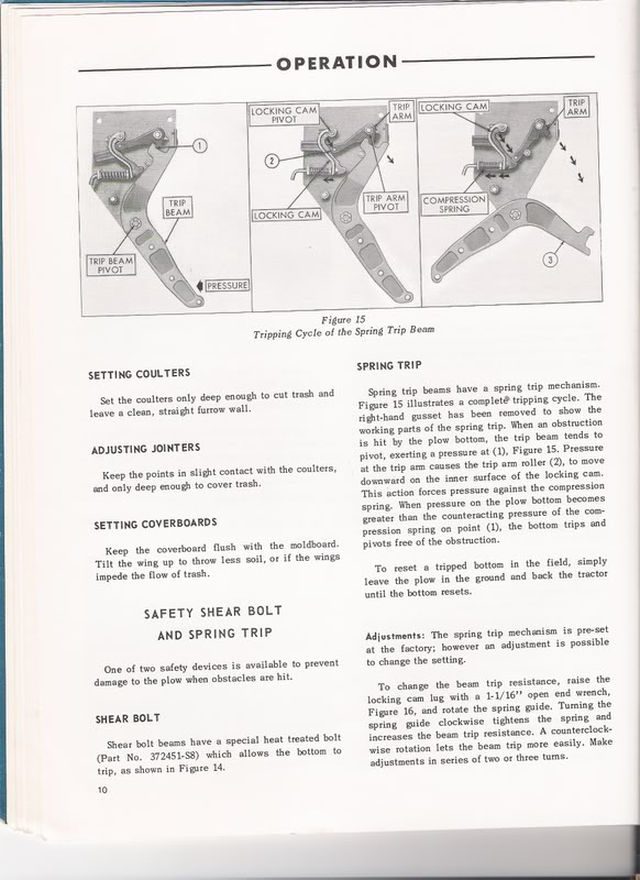

Your best bet is to break down the mechanism and give it a good cleaning. Then grease it at all pivot points, whether there is a Zerk or not. Then reassemble and grease the Zerks (is so equipped) every couple of uses.
I broke down an old Ford 101 and the grease was old, dirty, and solid. It prevented proper functioning. Here are a couple of photos from the 101 manual to give you a general idea how the mechanism works. Yours may be similar.
