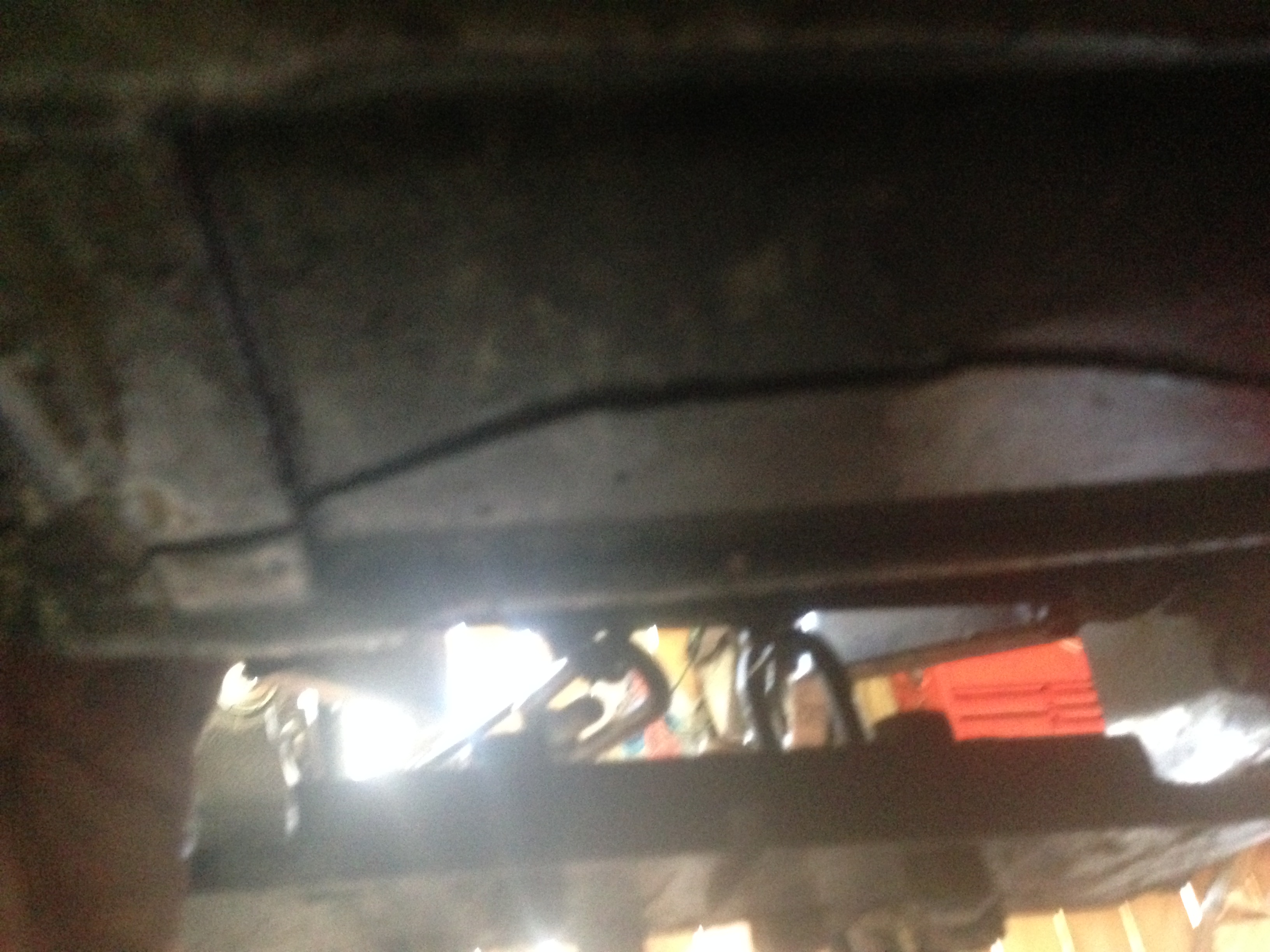

Stupidly, I forgot to reattach the 3 point arms when I detatched an implement. The threaded rod that holds up the arm got bent backwards when I was backing the tractor into the shed. I can't figure out how it put pressure on the case, but somehow, it cracked all the way across. IMG_0527.JPGIMG_0527.JPG
Is this something that can be welded? Hopefully welded in place? If not, is it a replacement that I can do my self?
From the diagrams that I can find and what I can see, it seems that there is a gasket that runs around a portion of the lower case, Can the lower portion of the transmission be removed and replaced without dropping the whole thing?
I would like to know if this is something that I can fix, or is it big deal?

cracked cases can seldom be repaired in place.
The photos do a good job of showing a crack, but fail to isolate the location and the effected component.
A mention of your tractor model would help also.
Hard to tell if it is a big deal or not. Did fluid leak out?

It is a Kubota BX1500 and the shot was the best I could get with me on my back pointing from slightly in front of the rear axle pointing back. Yes, all of the fluid leaked out.

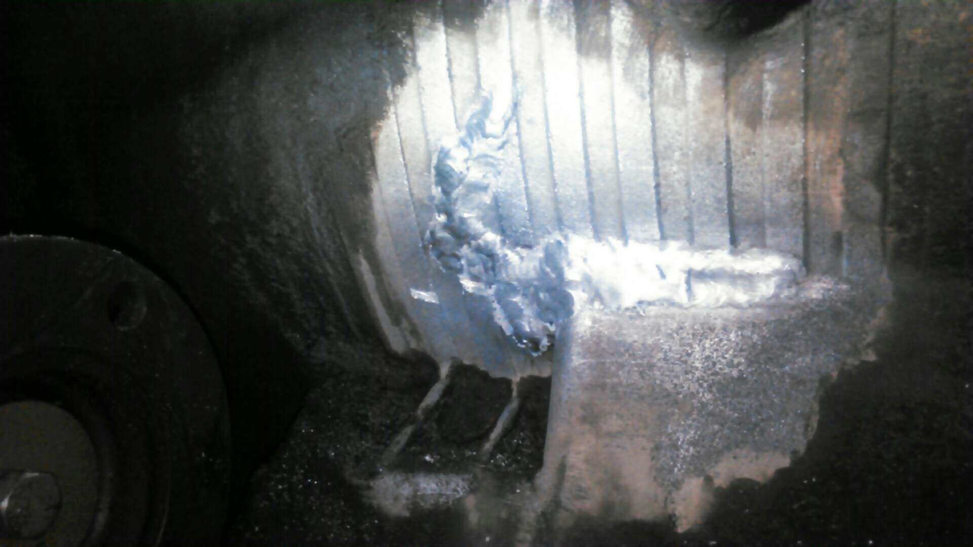

The case is aluminum, if you have the ability to weld it it would be a worthwhile repair.
I found a picture of the trans case I repaired awhile back, it was tough access and kept finding more cracks to drill and weld as I went.
This was on a trash truck that had the hydraulic pump pto u-joint come apart and smack the trans case.
Drained fluid, cleaned with acetone, torched with propane to burn off what I could. Still drew fluid into the weld at times but it held, not pretty due to fighting the fluid and limited access.
