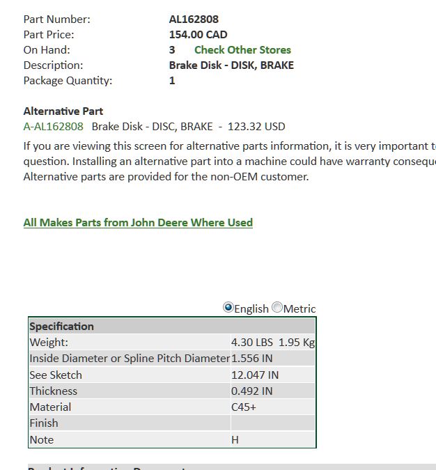

He is also wondering what the original brake disc thickness was? He wants to determine wear. But I might need to post that on a different thread.
   / How to remove retractor (pull off springs).? Brake retractor springs JD 5203 #5
Here's the spec's JD lists for brake disk.
HTH's Jim.

   / How to remove retractor (pull off springs).? Brake retractor springs JD 5203 #6
I take you are talking about the friction disc, I did not see anything that addresses the thickness. I do suggest that you purchase the tech manual as it will aid in putting it back together. Look at selectmanual.com to purchase a downloadable version for $29.95.
It appears the part number is AL162808 you may want to do a google search for specs.
